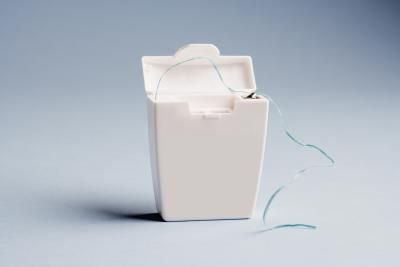

John-
You didn't use dental floss, did you?
dental floss.jpg (5.22 KiB) Viewed 3709 times

KWTownsend wrote:
Fri Jul 02, 2021 8:41 pm
John-
I was removing. You cant use floss can you to remove?
Posts: 1529
First Name: Keith
Last Name: Townsend
Location: Gresham, Orygun
Re: Went Fishing
Post by KWTownsend » Fri Jul 02, 2021 10:53 pm
John-
Before you put the washer and nut on...
Get two lengths of dental floss.
Tie a loop in each end of each length.
With one length, at one end, loop it through the nut (the way you would tie rubber bands together)
With the other length, loop it through the washer, the same way.
Now put a finger through the open end of each loop of each piece of dental floss and put the washer and nut on in the usual manner.
Now when you drop the nut or washer, you already have a safety line and you can just pull it back up.
The dental floss is this enough so you can put the nut on the threads no problem.
