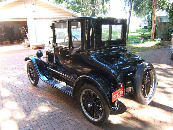

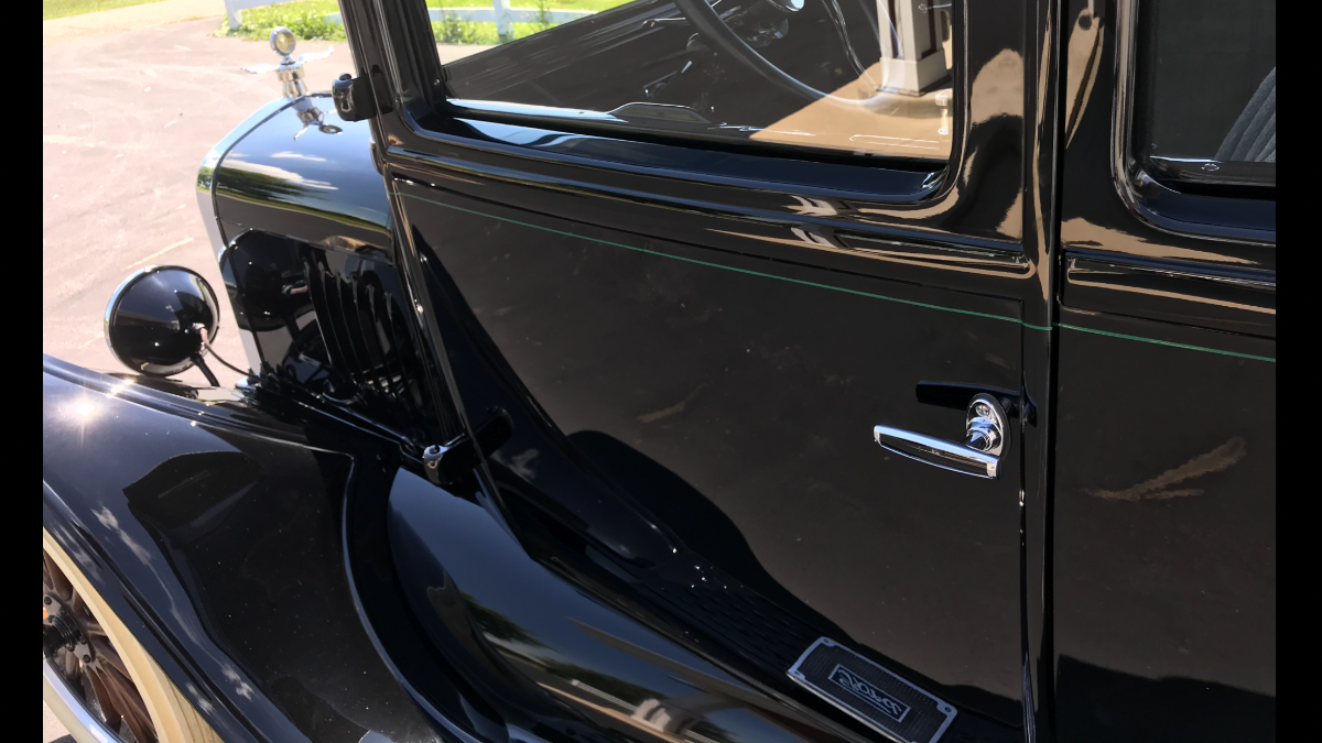

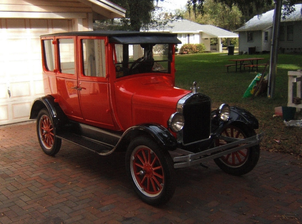

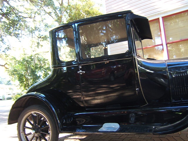

The attached photos show the route of the pinstriping on a 1926 coupe the pinstriping goes around the body across the top of the turtleneck below the body belt and ends on each side as it goes down the column on each side and doubles back at the bottom. My passenger side door is out of alignment, which is why the stripe is not even as it goes from the door to the body behind the door, otherwise, it should be even. I have learned since applying my pinstriping that the original pinstriping was thinner than my 1/8” wide gold 3M stick on pinstriping, but I like it, as I feel it is more proportional and stands out better, but that is a matter of choice.
The 1926 Tudor is exactly the same way, only it has a longer way to go behind the front door since the Tudor has a back seat. The 1926 Fordor is also the same except that it has four doors but the route is the same around the car to the front columns on each side. Note: the pinstriping stops at the bottom of the column and does not continue across the bottom of the door. Jim Patrick

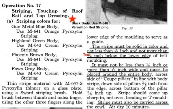

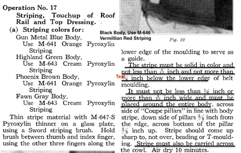

Post by DanTreace » Sun Jul 04, 2021 4:41 pm
Factory instructions from Service Bulletin

Dan, that states blue, green, brown, grey gets a certain color of pinstriping. What about a 1927 black body?

Post by speedytinc » Sun Jul 04, 2021 10:01 pm
DHort wrote:
Sun Jul 04, 2021 9:58 pm
Left of fig. Vermillion

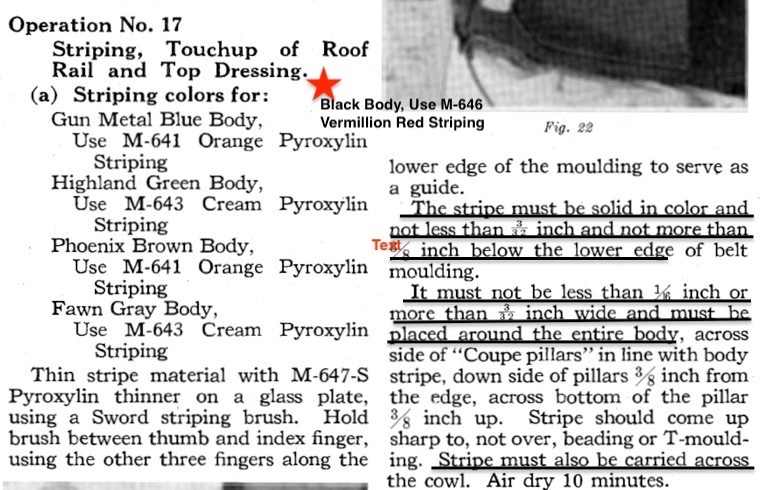

Post by DanTreace » Sun Jul 04, 2021 10:12 pm
Yes, the added text for the Black finish was hidden a bit, so put a big vermillion star by it!
