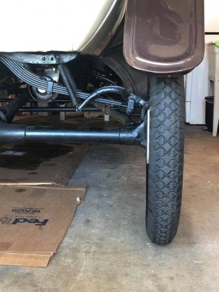

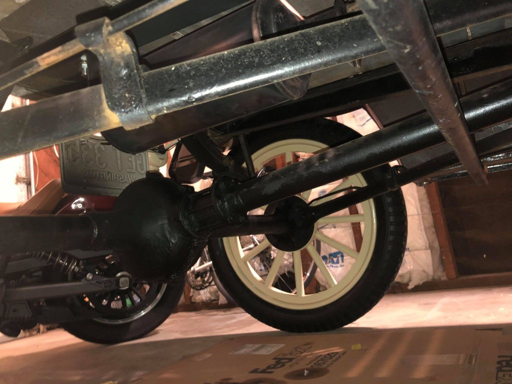

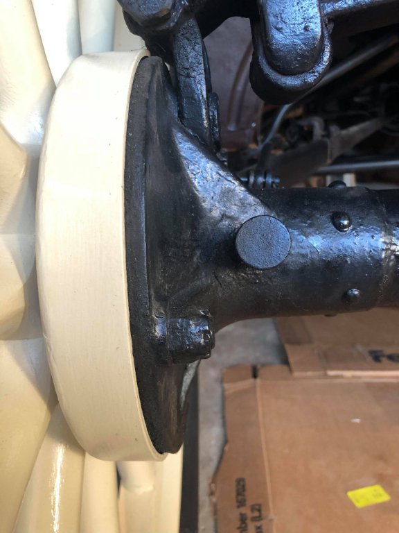

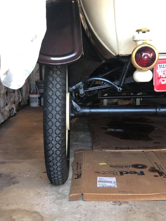

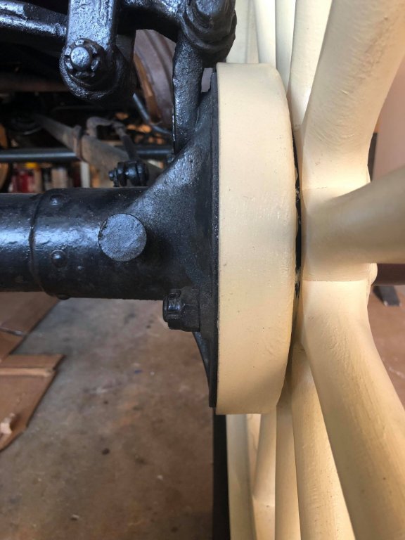

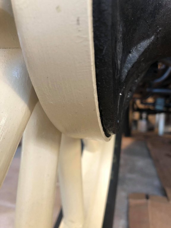

Here are some pictures attempting to show the wheel camber and the gap between the drum and the axle housing.
Normal-looking fitment on the passenger side: Fitment on the driver side (with negative camber): Passenger side drum closeup: Driver side drum closeup: Attempt to better show the slight gap not present on the other side:

Re: Rythmic Drivetrain Clacking
Driver's side is the side that appears to fit properly with respect to the location of the edge of the drum to the backing plate. The passenger's side goes on at least 1/4" too far.
As far as "negative camber" I don't see anything which remotely resembles a problem.
Rear axle making grinding noises, that's a concern, but the last place I'd look is the driver's side wheel at this point.
Set that far inboard, I'm not sure how on earth the passenger side wheel nuts are NOT hitting the perch nut.
And the nuts/bolts do need to be piened.
- Posts: 7309

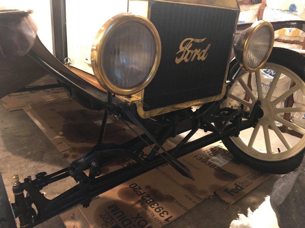

Eric, when I saw your photos, my attention was drawn to the road easer shock absorbers. They look like the Richards Wilcox English made ones often fitted by Duncan and Fraser to the cars sold by them in Adelaide, South Australia. Then I took a closer look at the way the corner panels are fitted to the bodywork, and that looks like D & F work also. So I looked for wheel spokes with the inside to outside taper on alternate spokes as our Canadian sourced cars have, but as you have Stutzman rebuilt wheels, they may have been discarded.
Can we have a couple of photos of the whole car?

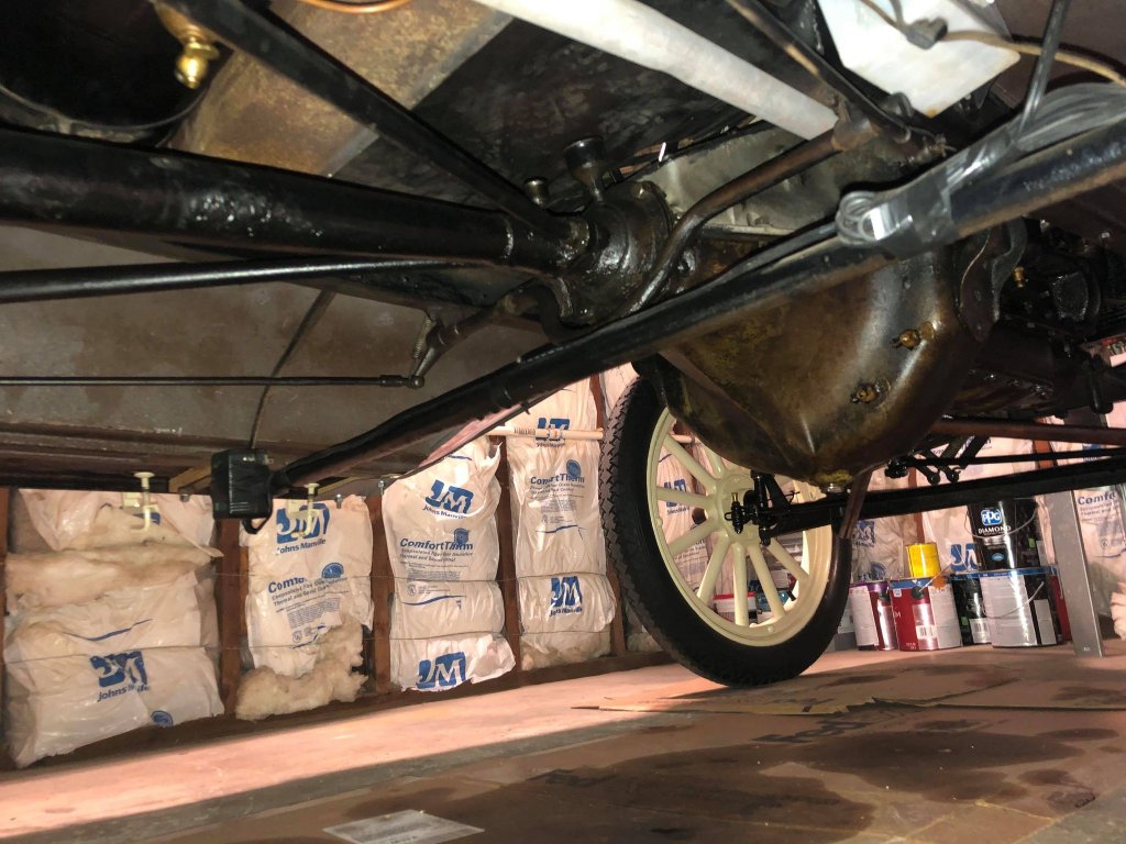

Allan, I don't know about any of those things for sure or much about the history of the car. I know it has been in Southern California for at least 15 years, and sometime prior to that it was in Washington state but not much else. I kept pieces of the spokes from the previous wheels (thought maybe they would make an interesting chess set or something), I attached some pictures. Not sure what else on the car you're looking to see, but here's a couple more shots. It's currently in a tight garage so good pics are difficult to get. When I had the wheels rebuilt, I sent some of the spokes to Noah Stutzman and I believe he made them the same way.Allan wrote: ↑Sun Jul 11, 2021 7:38 amEric, when I saw your photos, my attention was drawn to the road easer shock absorbers. They look like the Richards Wilcox English made ones often fitted by Duncan and Fraser to the cars sold by them in Adelaide, South Australia. Then I took a closer look at the way the corner panels are fitted to the bodywork, and that looks like D & F work also. So I looked for wheel spokes with the inside to outside taper on alternate spokes as our Canadian sourced cars have, but as you have Stutzman rebuilt wheels, they may have been discarded.

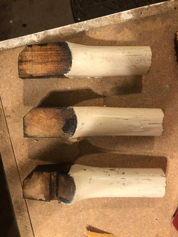

Spokes: Front axle: Underside:
Norm, I am part of the San Diego club already (two years or so), I haven't been to a meeting since the pandemic started but I am planning to attend the meeting you mentioned. I live around El Cajon now, so not far from you. I will reintroduce myself then and we can talk more about it.Norman Kling wrote: ↑Sun Jul 11, 2021 10:04 amEric,
I notice that you live in San Diego, however, are not on our club roster. What area in San Diego do you live? Perhaps I could come over and look at your car and listen to it clack. It would be easier to diagnose in person.
Also, I would like to invite you to join our club. We will be meeting this Wednesday evening at Maggie's starting at 6:00 PM (Many arrive about 5:30.) This location is in the area near I- 8 and I- 805 at 3232 Greyling Drive This is about a block off Gramercy and south of Aero Drive.

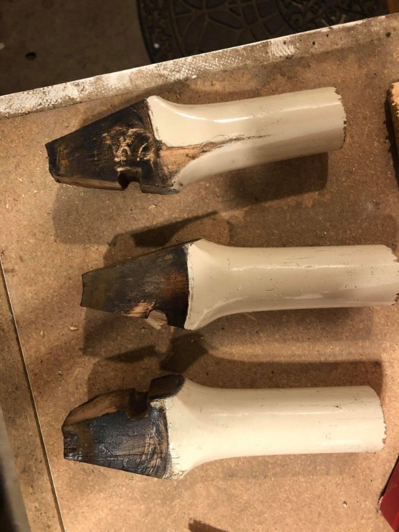

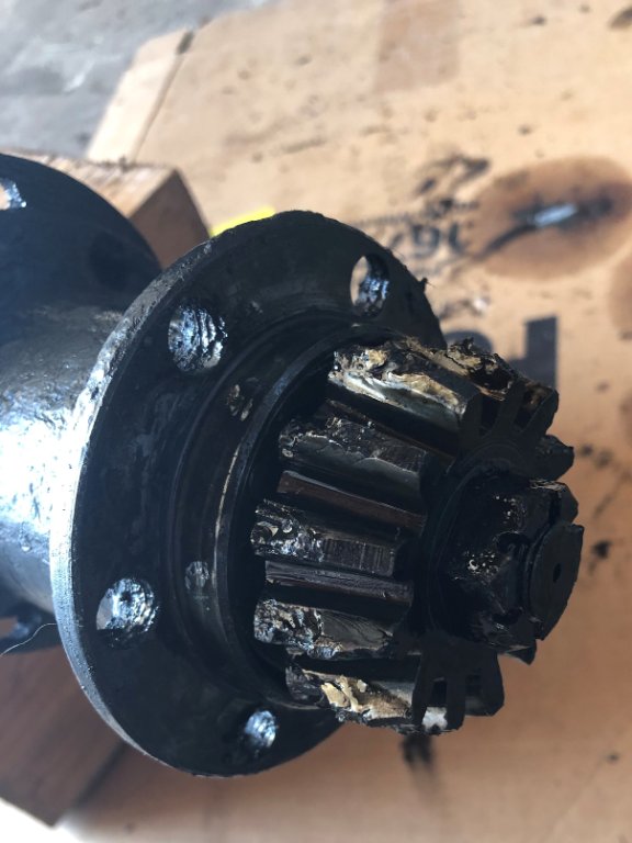

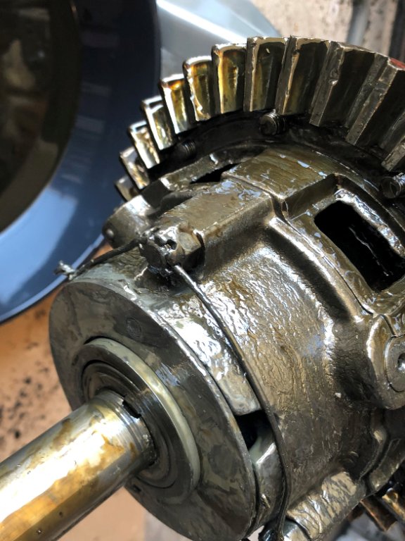

Update for posterity...this may have had something to do with the noise I was hearing
- Posts: 5277
Babbitt washers gone or D/S bearing/sleeve gone?
erkbrn
Topic author - Posts: 74
- Joined: Sat May 11, 2019 2:24 am
- First Name: Eric
- Last Name: Brown
- * REQUIRED* Type and Year of Model Ts owned: 1915 Speedster
- Location: San Diego
The thrust washers were still in good shape (one was bronze, one was babbitt) and so was the DS bearing. The DS bearing sleeve had a chip or two out of it, but it was still there and holding tight otherwise. Could be the chips from the bearing sleeve caused the devastation. Could also have been that most of the gear oil had leaked out and been replaced by engine oil. Perhaps all of the above. There was no shortage of metal pieces in the fluid that was drained out, that's for sure.
