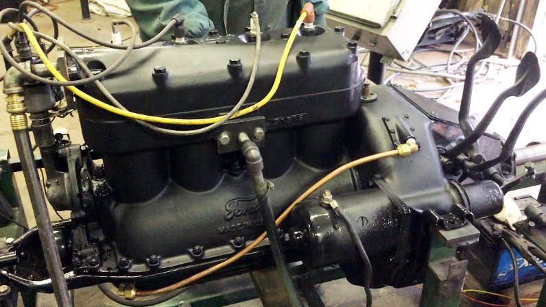

I'm sure you're also aware of the problem with the front main bearing being deprived of oil when a car is driven on a long uphill slope. That is why many cars have an aftermarket oil line installed to catch oil by the flywheel and deliver it to the front (see photo.) There is also the problem with under seat fuel tanks where too little fuel on a steep uphill slope can starve the engine of fuel...solution there is add fuel or go up the hill backwards.
