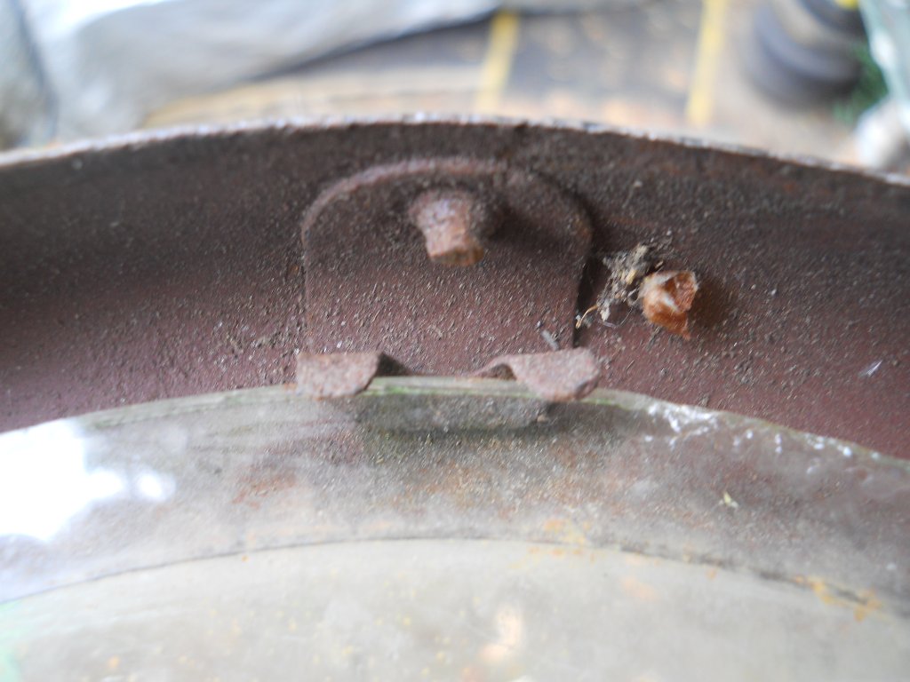

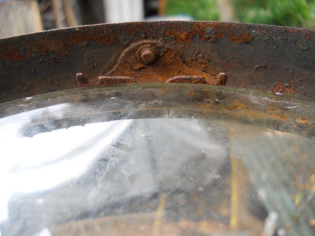

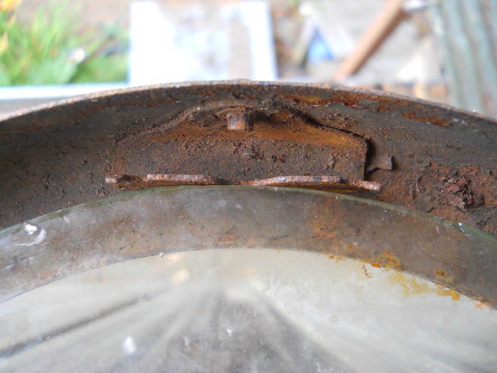

The only reason for the wider clip on the later rims was to keep the H lens flutes in their vertical orientation. When using plain glass lenses they can be used if one end is twisted a bit and one tab bent down to hold the lens.

Correct on that reason. But with a bit of crafty work, one can use clear glass lens easier on these later rims by just having the glass cutter trim each side in 4 places. That way it fits like the later Ford 'H' lens
Did this for a pair of brass rims on early acetylene headlamps, found w/o rims, wanted the brass look on the cheap, so took a pair of later nickel rims, and polished off the nickel , leaving the brass rim, with clear lens for the faux '13 in the garage

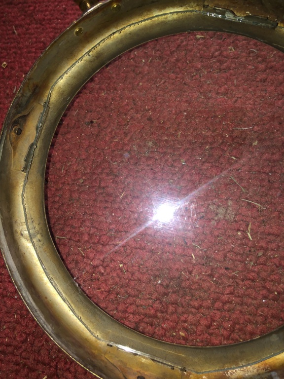

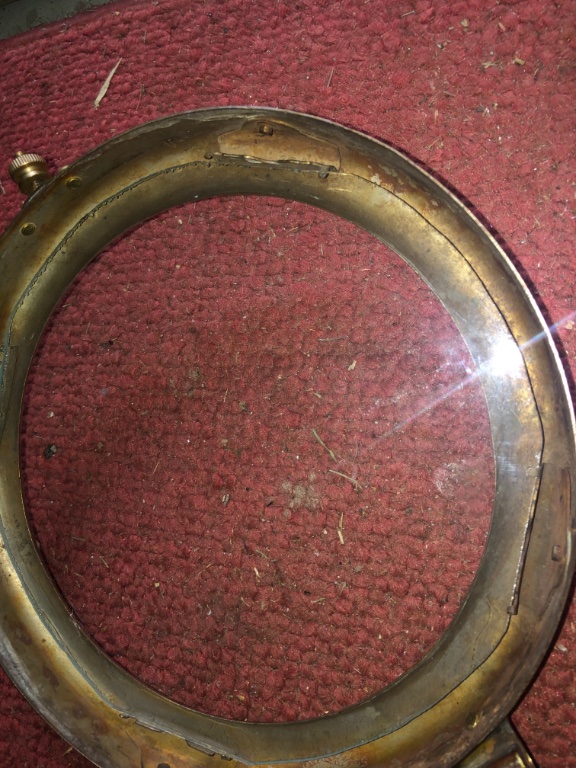

How about taking one of your rims to a local glass shop and having them cut a pair of plate glass lenses to fit?
