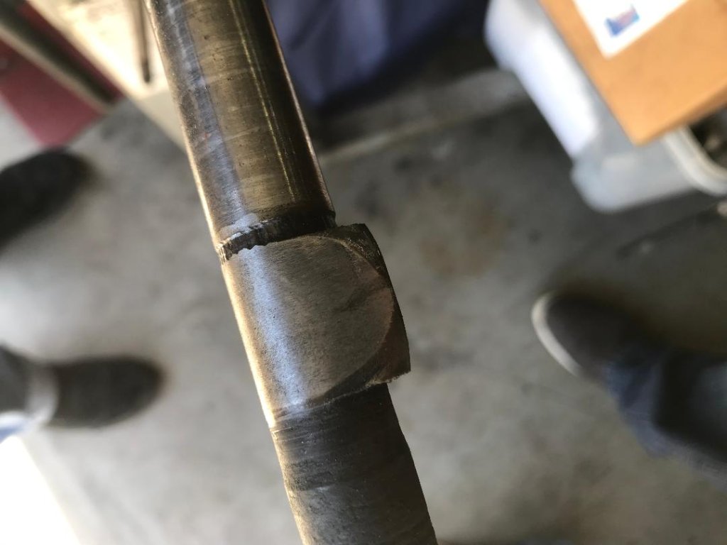

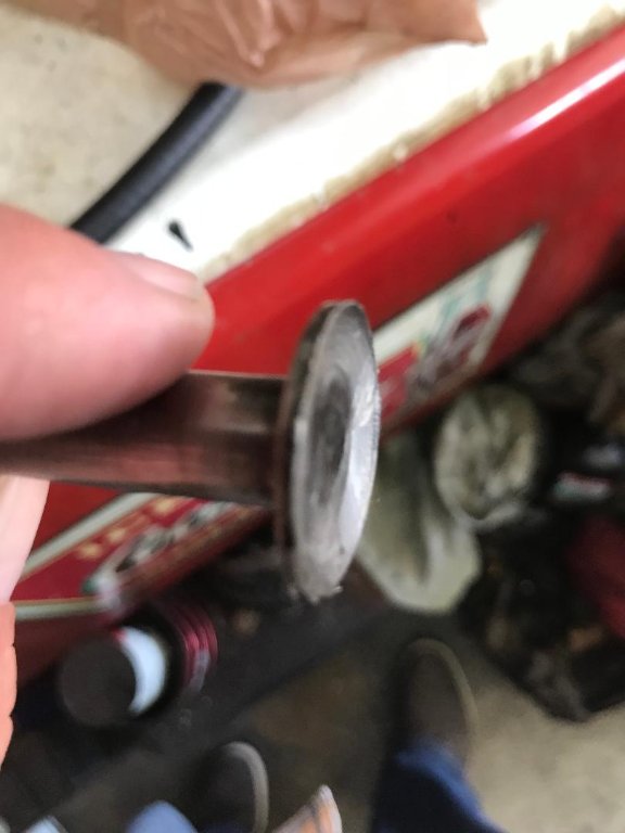

A fellow bought a 15 touring with a recent "new" motor. Story is he put around 1000 miles on it, but it performed poorly. He rebuilt another motor, switched them out. The old motor was to be repurposed to another T, this is some 10 years later. A bad cam was suspected for the poor running. The cam was pulled & showed nasty wear on 5 of the lobes.(only 5) Why? Then the lifters were pulled. 5 lifters were severly worn. The OD edges hard surfaces cut up the cam lobes. The soft centers of the heads were worn away cupped like a bird bath. I have seen a more severe worn lifler(1) from another motor where the head was completely gone. Only the 7/16" lifter stem remained. The cam was a .270 lift regrind cam.
The loss of lift made for a poorly running motor.
You may recall, a vendor had a bunch of lifters made. The heads were deemed too thick after heat treating. They were reground to spec, but not re heat treated.
These defective lifters keep showing up. The gift that keeps giving.

I found one that all left was a stem. Ruined a Stipes 280 cam.
