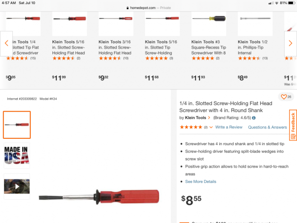

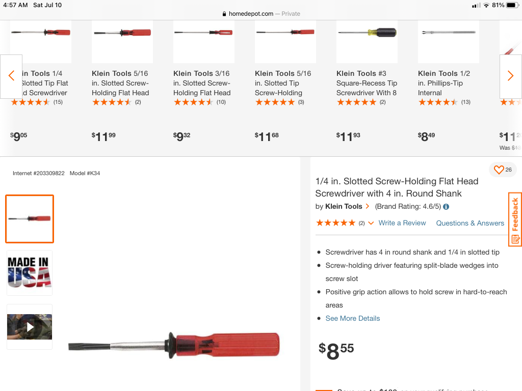

. Buy one of these from Home Depo and and you’ll solve the problem. Go to the Home Depot site and click on the video. Vaco also makes them.

I have 3 different sizes of these and always bring them with me when I drive my Fords.

I used to have one (operative words here are "used to") and somehow lost it. Last time I put the bendix cover on I sure was wishing I had one of those. Definitely gonna replace it now.

Good tool tip Bob, get the one @ 3 O'clock in first the other three are easy. When they fall they always find a good hiding spot :lol:

We called those Monday Morning Screwdrivers.
If you don’t have one get one.

E6D75BD6-F7D2-4433-BEF0-80864A916158.png. Buy one of these from Home Depo and and you’ll solve the problem. Go to the Home Depot site and click on the video. Vaco also makes them.
The long version will clear the pedals better for the 3 o'clock screw & works on the other 3 also.

Channel lock made a set with clips. Bought em. the clip device still got in the way by the pedals & eventually all broke. I now use the long red handled vaco.

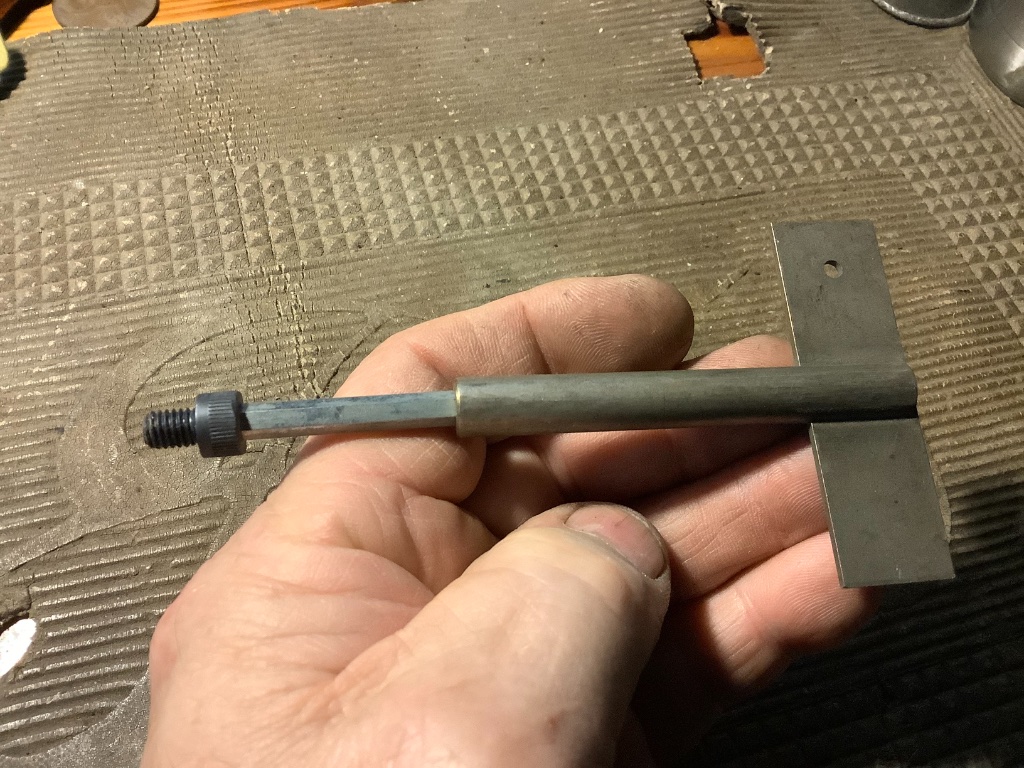

Years ago I had a bendix cover come loose, lost a bunch of oil, like right away. After finding the oddball screw in the oily gravel, laying on my back, trying to get them back in place with bifocals, I took a Ted Aschman tip. I carry one of these in every toolbox, just in case. Kind of like a vampire kit. If you have one, you will never need it. So far so good, and I’ll race anybody on the planet, blindfolded and in the dark, for money! I’d go double or nothing with the screw/ washer on wire or bubblegum or wedge screwdriver competitor. DONT FORGET, IF YOU ARE PURIST ENOUGH TO INSIST ON SCREWS, THEY HAVE TO HAVE WASHERS ON THEM! Don’t need washers with the metric cap screws. I had a box of a hundred cap screws at one time but have given nearly all of them away over the years.
