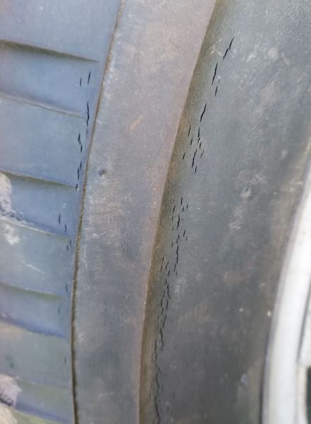

My new Firestone made in USA 440/450-21 tires bought and installed new this year have cracks developing on the side walls.My 50 year old Lester spare tire still looks new. Last set of new tires was almost 40 years ago, thought these Firestones would be my last tires. Tire code ends in 20, is that the manufacture date?

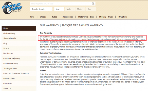

Post by TRDxB2 » Sat Jul 10, 2021 12:12 pm
Start contacting seller or Coker. Ask them to help you resolve the issue, describe the problem and the say "several members of the Model T Ford Club of America" suggested that I follow-up on the warranty. That should get some attention.
Don't try to remedy the situation and don't put anything on it - they'll say that the product had an adverse reaction to the rubber on the tire
Coker said: These tires are made in the US, by Specialty Tires of America. Coker Tire Support on September 19, 2016
Their current website doesn't indicate making any size vintage tire https://www.stausaonline.com/

Post by Humblej » Sun Jul 11, 2021 1:11 pm
Here is a picture of the cracking. I will be calling Coker Tire Monday.
tire 1.jpg (32.81 KiB) Viewed 6235 times

Post by Allan » Sun Jul 11, 2021 11:48 pm
I saw such cracking recently on a Universal T driver tyre. At its worst, the crack was more continuous and went down to the canvas layer. What you have is not the surface checking often found on older tyres
