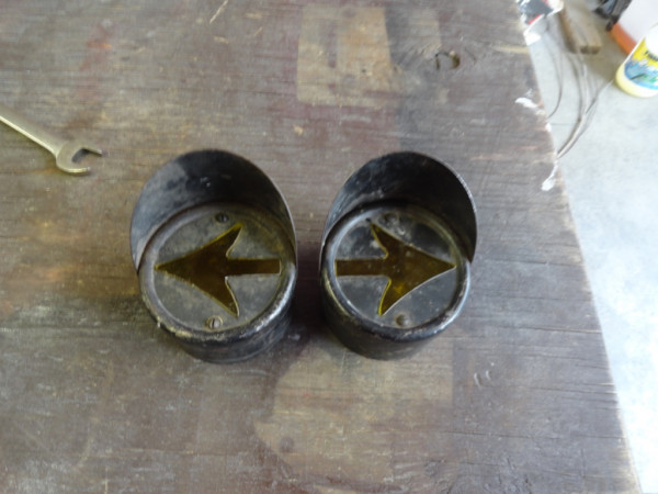

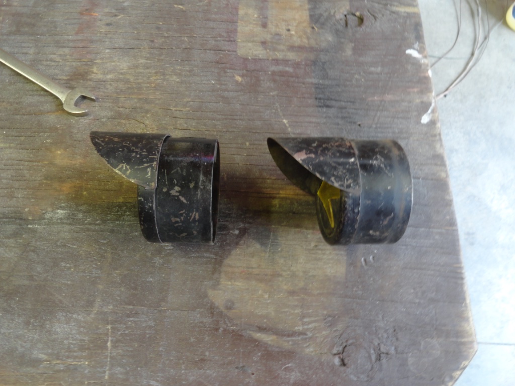

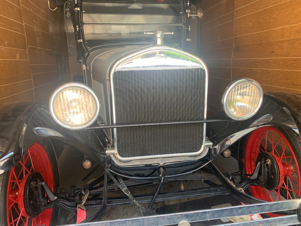

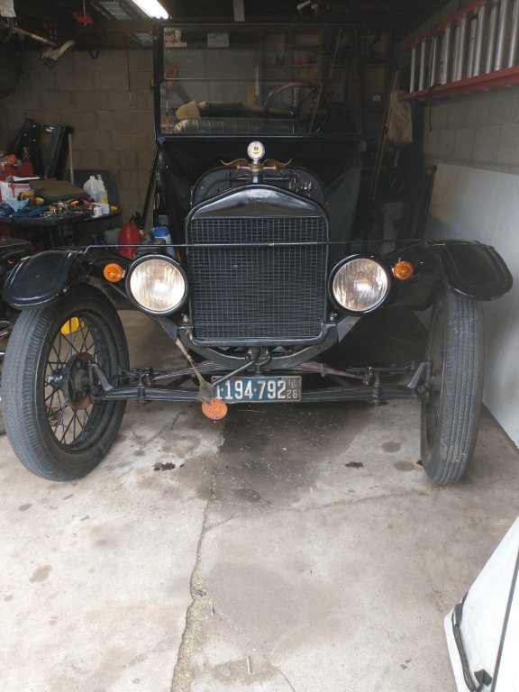

I'm putting turn signals on my touring and looking for advice on front placement.
Eventually I want to lay my hands on a couple of cowl lamps, but that's not in this year's budget. In the meantime I'm going to make use of these bullet fixtures. I'd like to not drill into the fenders (especially since I already have plans to scrap these fixtures.
Each of my headlight rims has a set screw (which drove me crazy the first time I tried open them!). The picture shows the lights mounted to the rims at the set screws.
Thoughts? Too close to the headlights?
Anybody ever done this?

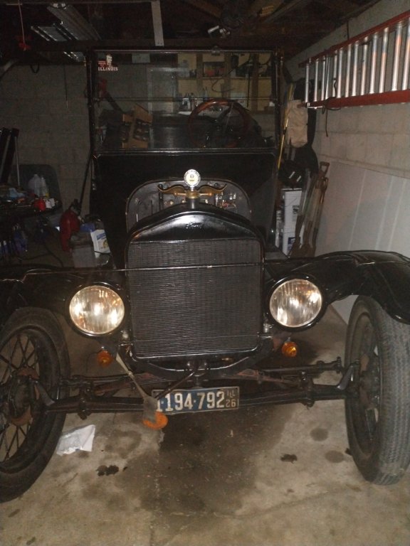

Eric I have always made a small bracket off the bottom of the headlight mount bolts. Works well.

That was the other place I was thinking of but I thought they might be too low.
Worked for you though, huh?

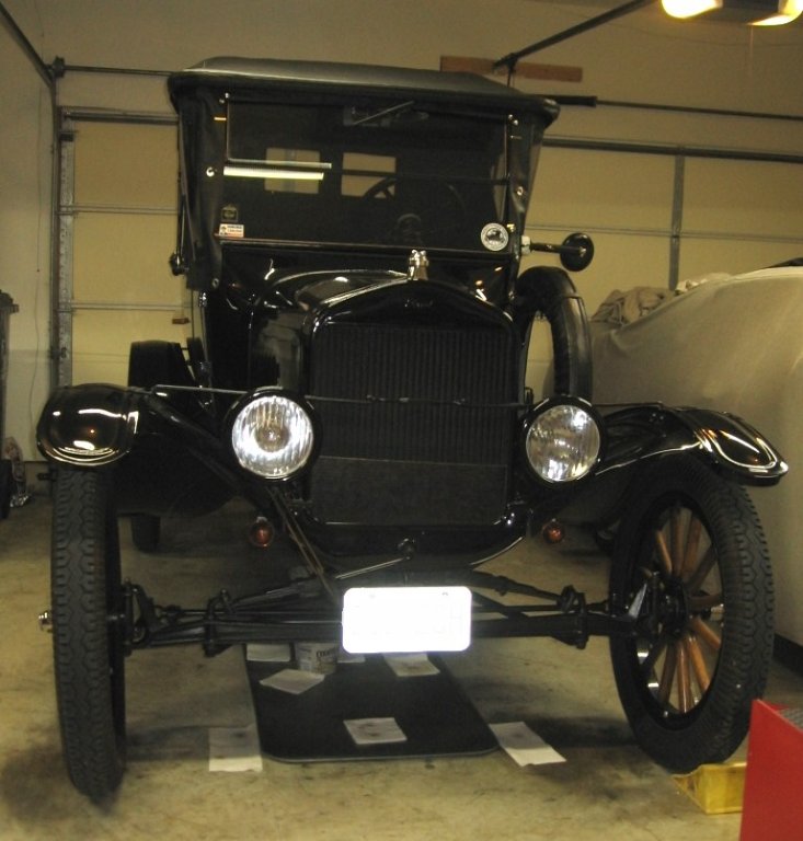

Here is how my 1924 looks with the turn signals positioned as Hank says. IMO, they aren't too low. :)

T's set higher than the modern cars, so wouldn't worry about them being too low. Mark's look just right to me. Mark is that a Cuda under wraps next to the T?

Post by paddy1998 » Sat Jul 10, 2021 10:43 pm
Henry K. Lee wrote:
Sat Jul 10, 2021 2:16 pm
I believe you're right.
That's much better.

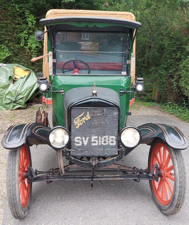

No missing this old girl's indicators, l.e.d's in the cowel lights and flashing bulbs in the " Winka" cable controlled semaphores!
