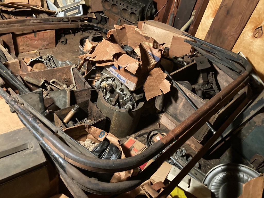

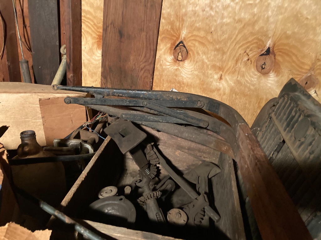

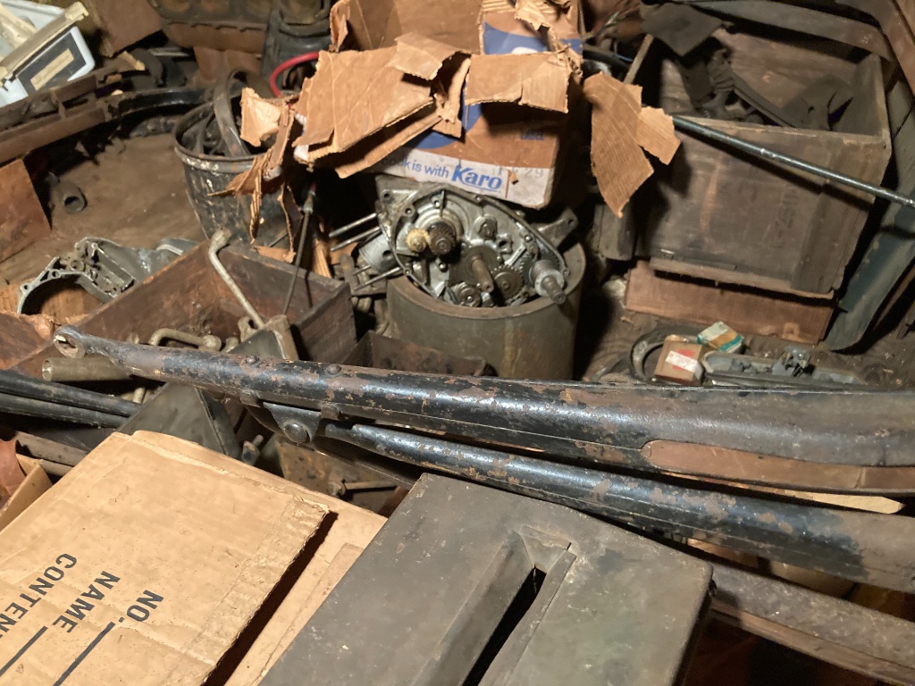

Can someone please let me know what year these roadster top irons and bows are for.
And what is correct for a 16 roadster ?

They are not 16T or T at all.
Re: Please help ID top bows
Post by Norman Kling » Mon Jul 12, 2021 1:13 pm
A little trouble to be sure what year, but they appear to be a touring one man top. This type started mid year 1923 on the slant windshield cars and continued to 1925. The 26-27 are similar, but a little different size.

Maybe it goes with the winshield I tried to use , if its not T.

The resemble the top bows for a one man roadster top, but they aren’t Model T. Without the top material, the front bow would be completely separate from the rear two.
