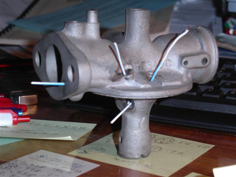

If it is an NH:
the idle by-pass circuit may be clogged or restricted, which will stop air from being pulled down into the gasoline well and spewing fuel-rich vapor into the air flow at the "dip" in the venturi, or the float level is too low and the carb is running too lean at the main (only) jet at high-vacuum (idle). Both issues are unique in cause, but are related in the scheme of things in that you are trying to get fuel up into the air stream. With lower vacuum but higher velocity, the idle by-pass is taken out of the loop and the airflow will make up and mask the effect of too-low fuel in the bowl and thus the jet. At idle, all of these things need to be right in order to have the right enrichment at high vacuum/ low flow.
That said, I went to start a freshed up engine this spring and had much the same problem and found that adding a hot air stove solved the idle (never could get the mixture right for more than a few seconds) and stopped all fouling of plugs. It was remarkable the difference between not having and having it installed. My '13 in FL would NOT run EVER without a stove. In WY they are all but useless but I found this motor in cool weather MUST have it installed. Paddy is not wrong in thinking that it solved his problem. He is not the first.

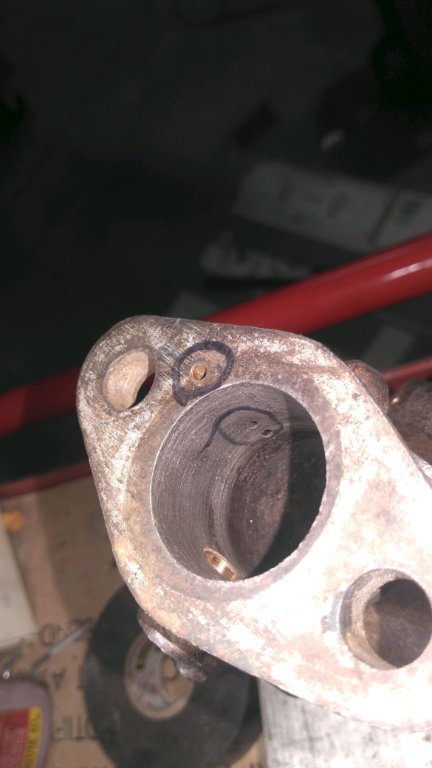

The '13 I'm working on had a similar issue, of 'No Idle'.. I was thinking it was the Severely warn out Throttle Body on the Late Model NH Carb that was on it.. I bushed the Body, and Installed New Throttle body Shaft and Butterfly.. Better, but Still had no Idle i Liked..
I ended up drilling out the Brass Plug that is in the Idle Circuit Next to the Intake manifold Flange of the Carb. The TWO holes that Bypass the Idle Air/Fuel around the Throttle Plate in the Carb Throat were rusted mostly closed. I took a SMALL Drill, and used it as a round file to 'File' out the rust from the Holes..from the Throttle Plate side.. go in at an angle.. Don't open them up, just clear out the rust.
I then used Compressed air to blow all the debris FORWARD from the Vent Hole behind the NH 'Ident Plate' ( there is an Idle Vent hole behind the plate.. Just Blow behind the Plate and the Debris will come out )..
I used a 'Wad' of Solid Core Solder to Re-Plug the Hole I drilled out from the Carb Gasket Side.. You really don't have to Plug the Hole, as it will mate up to the Intake manifold Flange Gasket and seal off.. Your choice..
I can now get the '13 to idle WAY down low in a stable RPM.. and it does not stumble when coming off idle.. I really like it.. I might have to check my '24 TT to see how the Idle Ports on it are doing..

Here is a shot of a NH T Body at the Idle Circuit.. Plug you drill out is on the Flange, the Holes you get the Crud out of are in the Throat.. DO NOT MAKE THEM BIGGER.
You can also see the Bushing I installed in the T Shaft Hole.. One is a Through Hole, and one is a Blind hole. Cap

A little trick I picked up from Stan was to remove the brass carburetor plugs, tap the holes, and plug the holes with 8-32 Allen screws, easily removable for cleaning. Making sure the passages were open was one of the things I tried during the recent hard-starting adventure. There are no clogged passages. I was also very careful about setting the float at 15/64". But I may try a different carb just to see if it makes any difference.
I'm a skeptic on the hot air pipe theory, as I've run without one for years with no ill effect that I've noticed, but I'll give it a try and see what happens.

Some threads about cleaning the passages. http://www.mtfca.com/discus/messages/80 ... 1253048587
One suggested to scrub the crud. ( A trick I learned from Stan Howe for cleaning out passages: a brass-wound guitar string. The brass winding is rough enough to dislodge dirt and soft enough to not damage the carburetor.)

Revisiting the Picture I posted..
It's not the Passageway that plugged up, it's the Throttle Body Ports that caused my Idle Issues.. as the First time I went into the Car, I only did the Bushings, Shafts, and Float Level.. Better but not good.. Then I Drilled out the Plugs and Rodded the Passages.. I was leary of Messing with the Idle Ports.. Put it back together and the Performance was the same..
The Third time I went into it, I 'Reamed' the Idle Ports to get the Rust off the Holes.. That was the Cure for THIS Carb..
