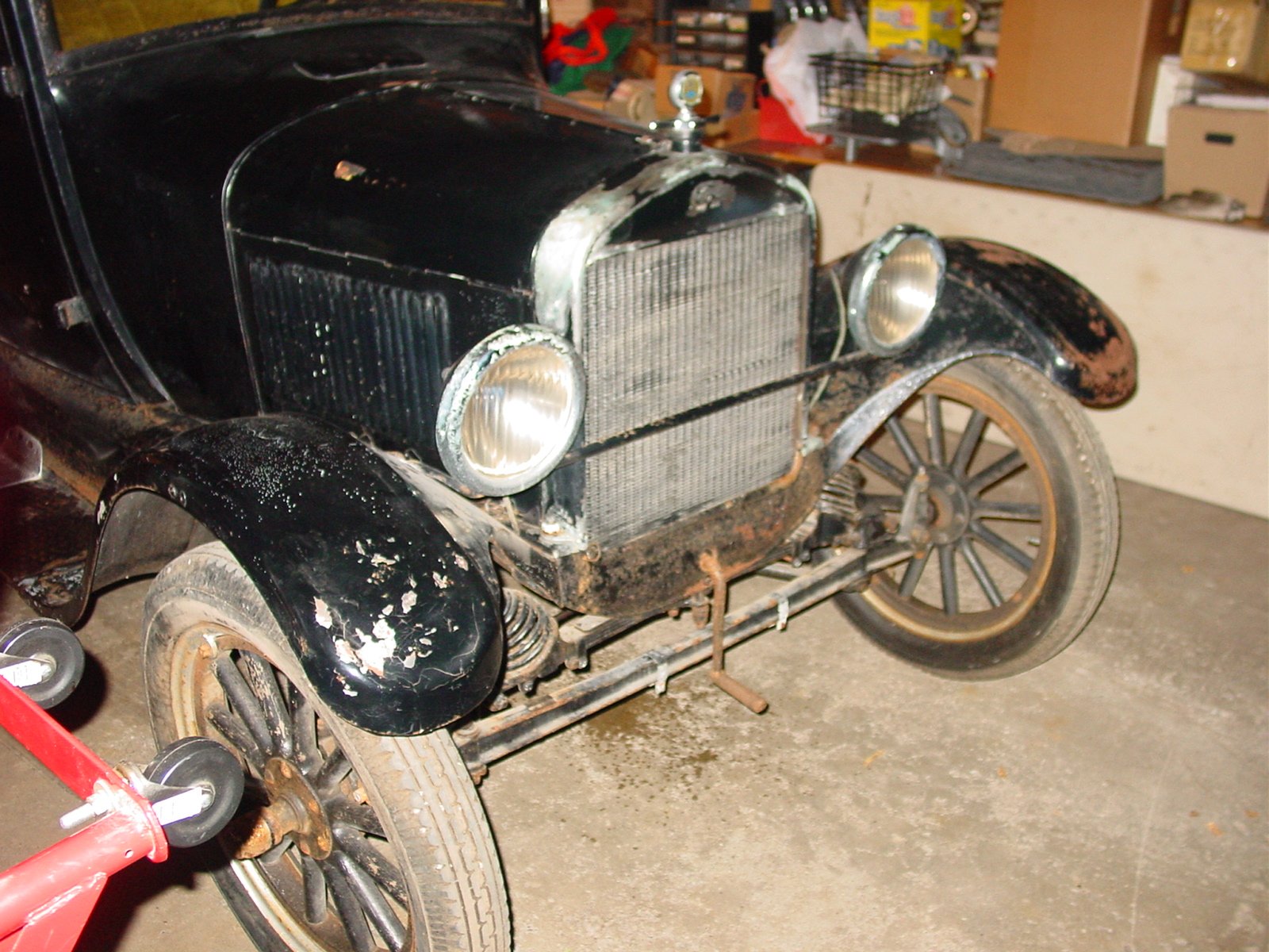

New guy here

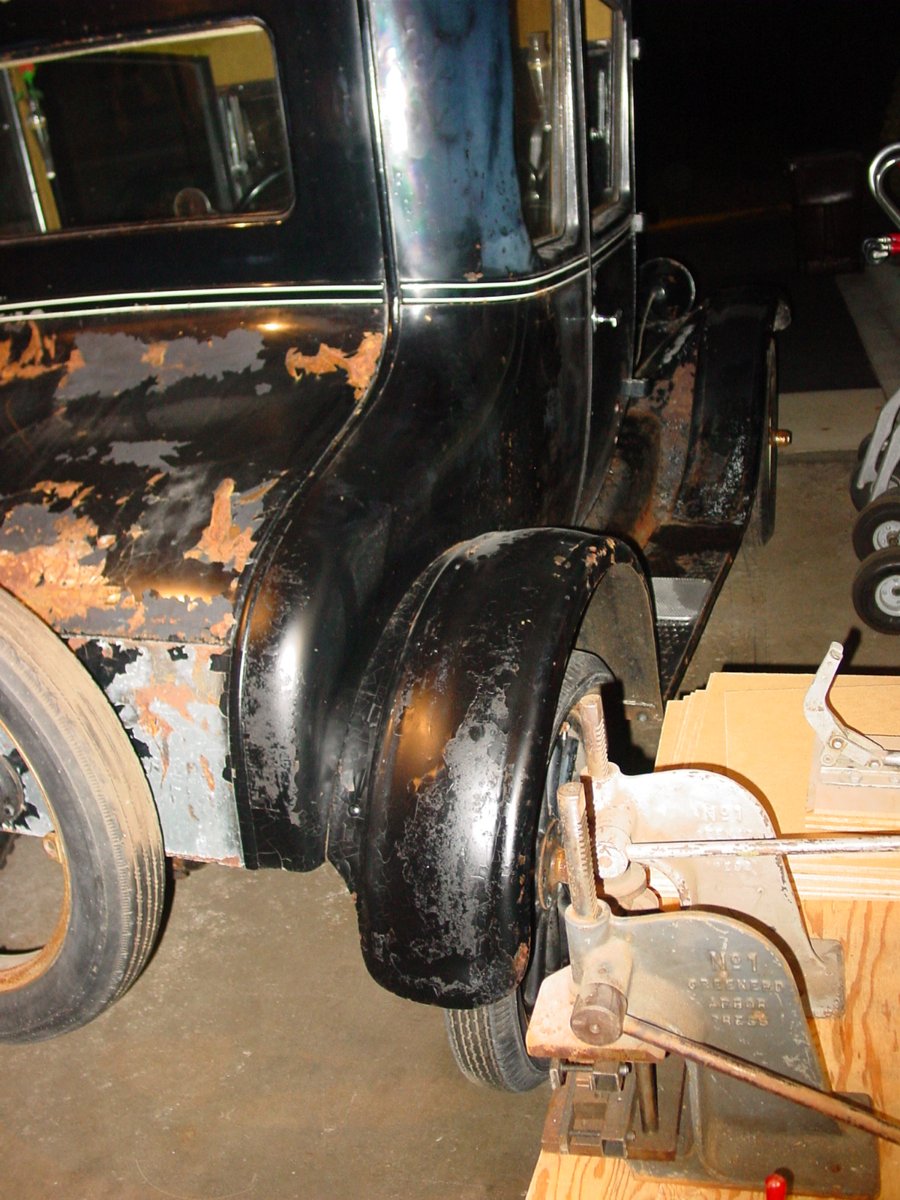

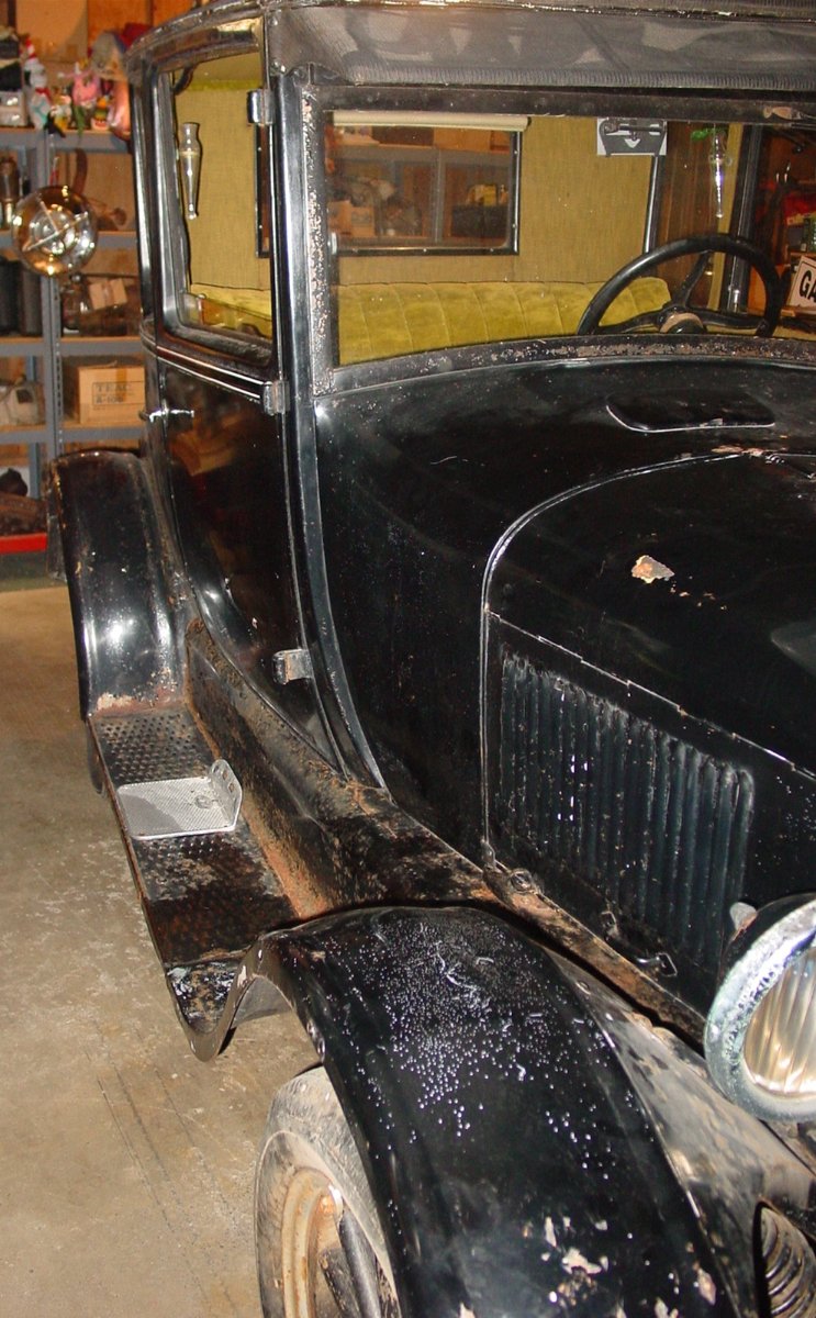

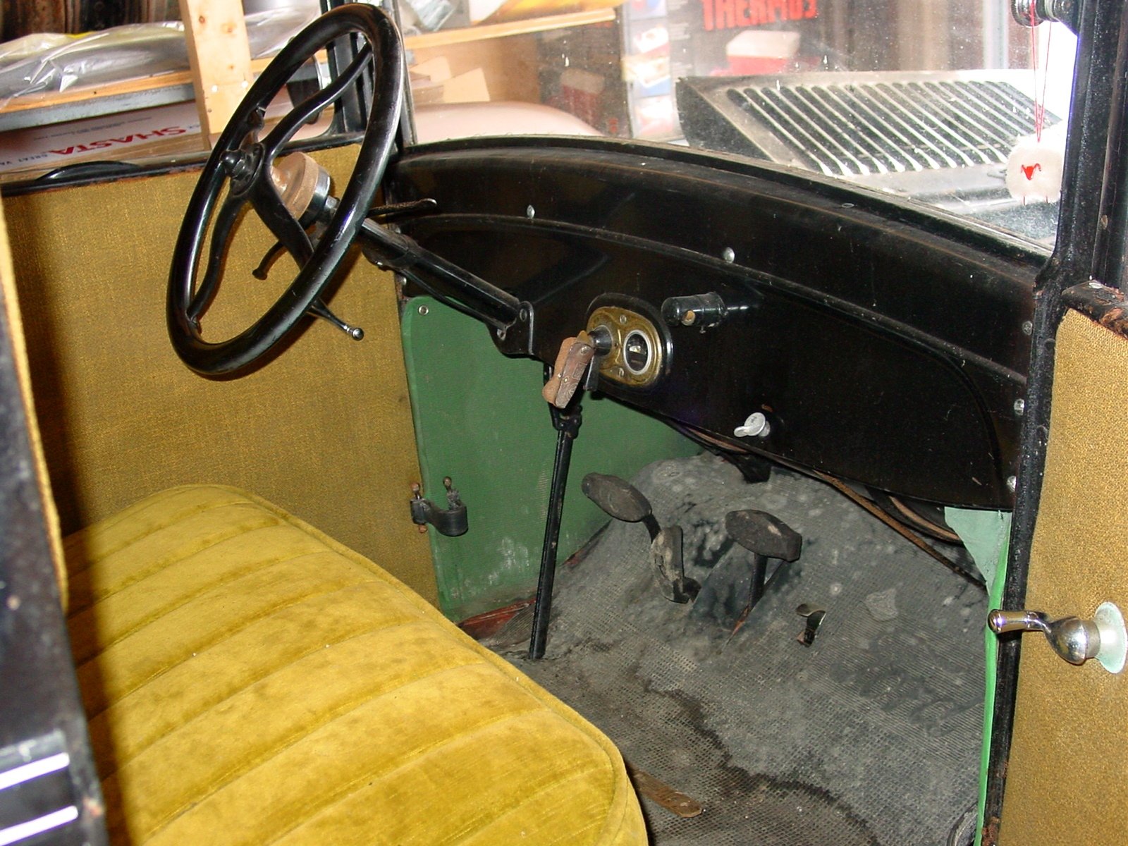

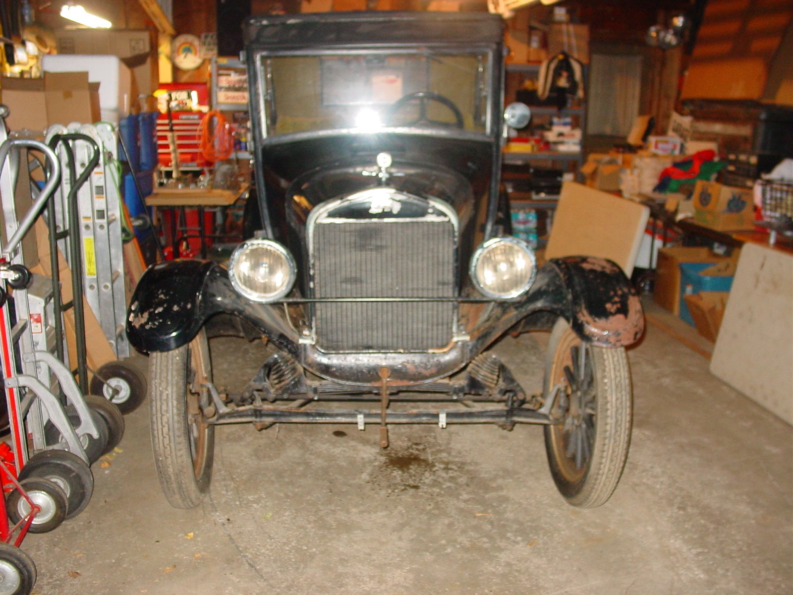

Post by Wags70ss » Wed Apr 08, 2020 10:26 am

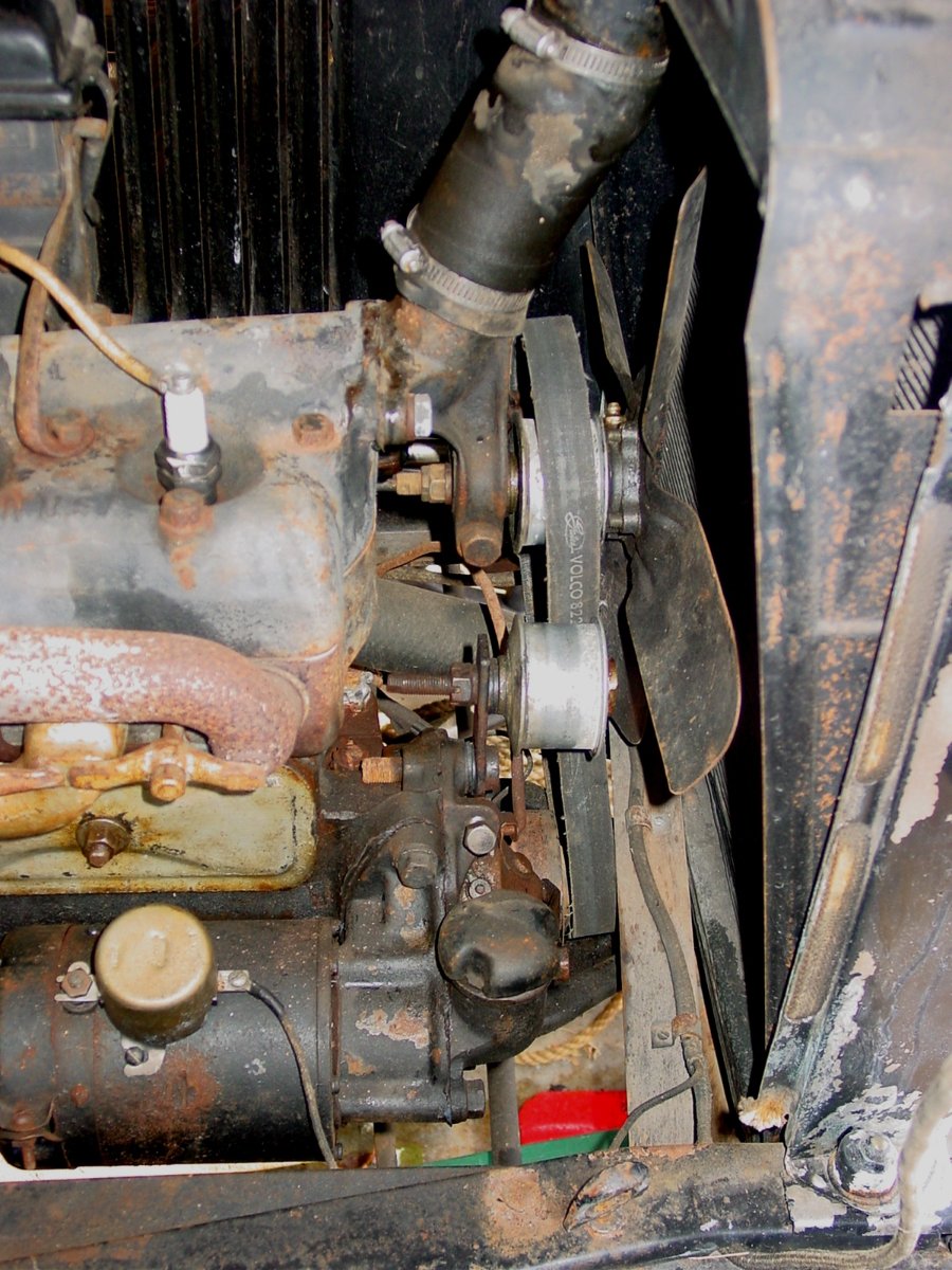

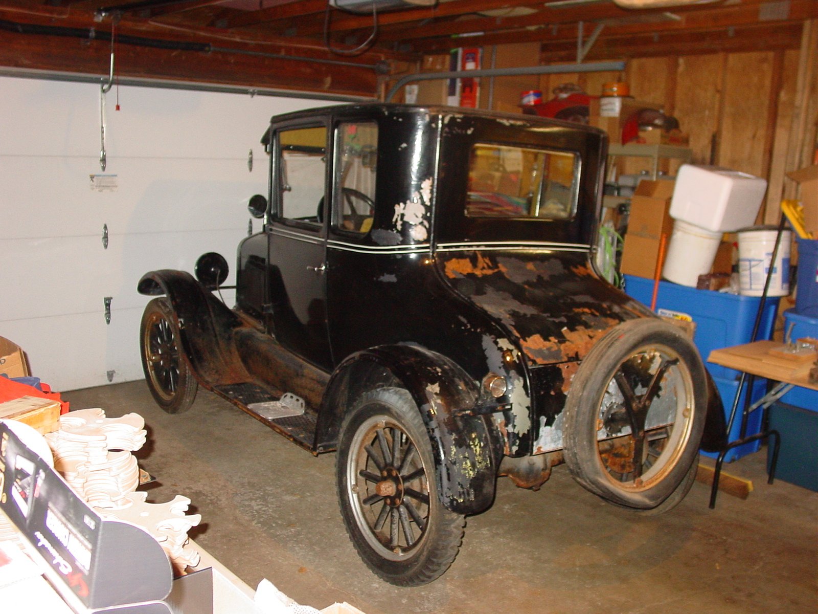

Hello everyone. My name is Dave & I'm from the Kansas City Missouri area. I just bought a model T & I know absolutely nothing about them! :shock: The title says it's a 1927. I'll post pictures of it here and maybe you guys can tell me all about it. In particular, I'd like to know what carburetor it has, and ignition coils as well. If you could give me some ideas about the value, that'd be great. Owner said it runs, has an older restoration with poor paint work. He said he hasn't driven it because it has bad tires. Tell me what you think!

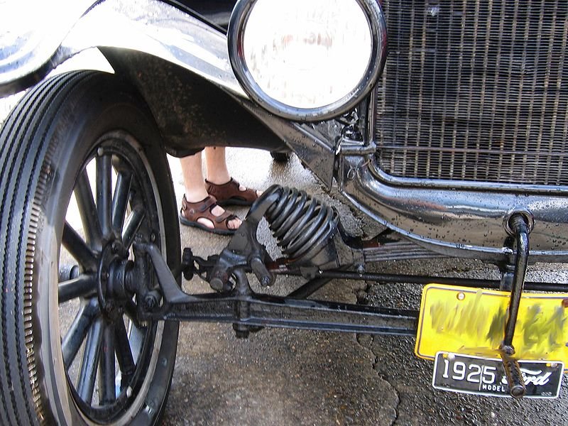

The one with the 1925 tag isn't a picture of the car. Sorry about that lol. I was trying to figure out what the coil springs were on the front of it. ;)

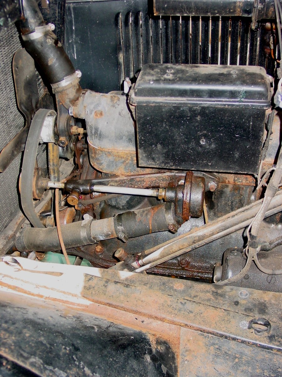

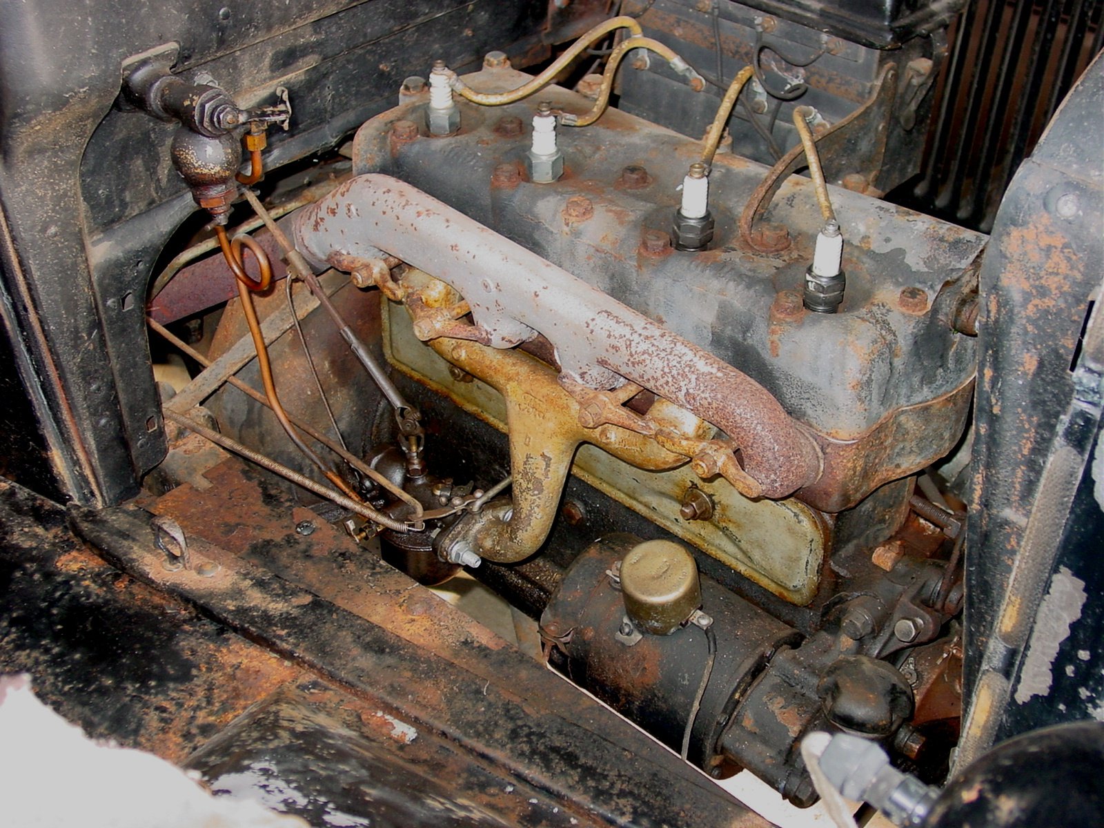

Welcome to the affliction as they say. That looks like a Kingston "L4" carburetor. A fresh find with all sorts of adventures awaiting you. We are here to answer your questions in as many ways as possible. Some comments may help.
Those are Hassler Shock Absorbers.

Congrats!
Looks like a nice restoration project. It is indeed a 1927 Coupe, engine # on title shows it to have been mfg. Feb 8, 1927 along with 4,999 motors made that same day.
Needs paint job of course, but that can be after you get her running to see what the conditions are. The carb is factory, its a Kingston. The old water pump is an accessory and was likely placed there as the radiator is probably long gone in providing proper cooling.

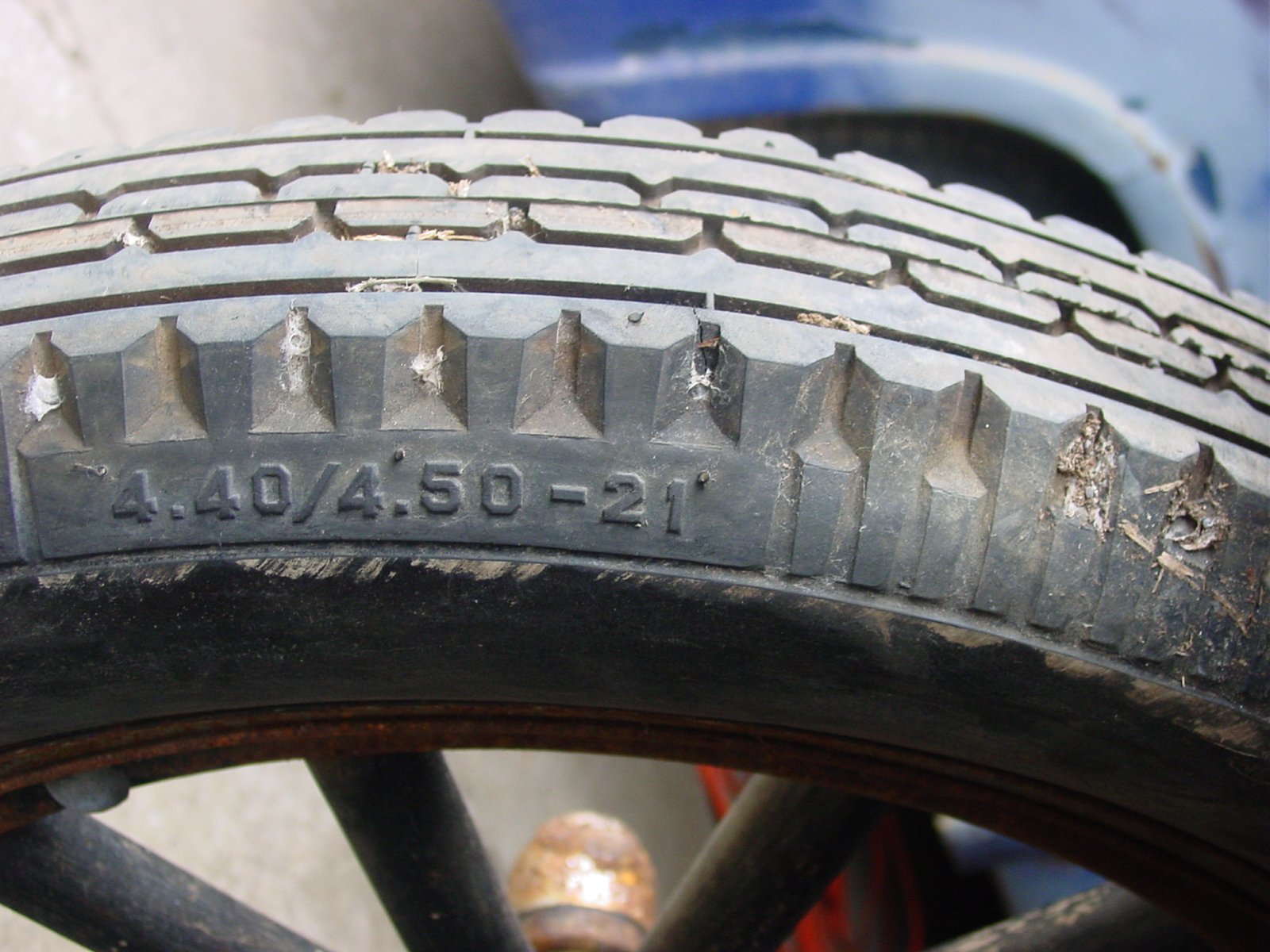

So, you have a few things to do, new tires and tubes, some other new parts, and then it should be running at least to do a check ride.
Lots of others will post too, nice T to have as a new owner, seems solid without rust, and at least the replacement upholstery is good enough to get by.

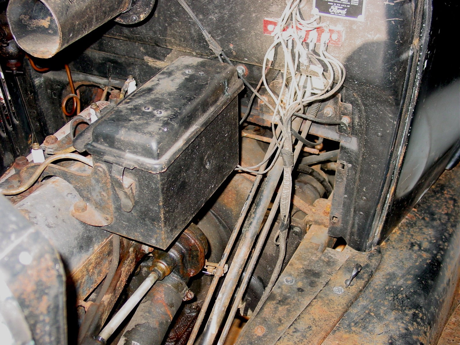

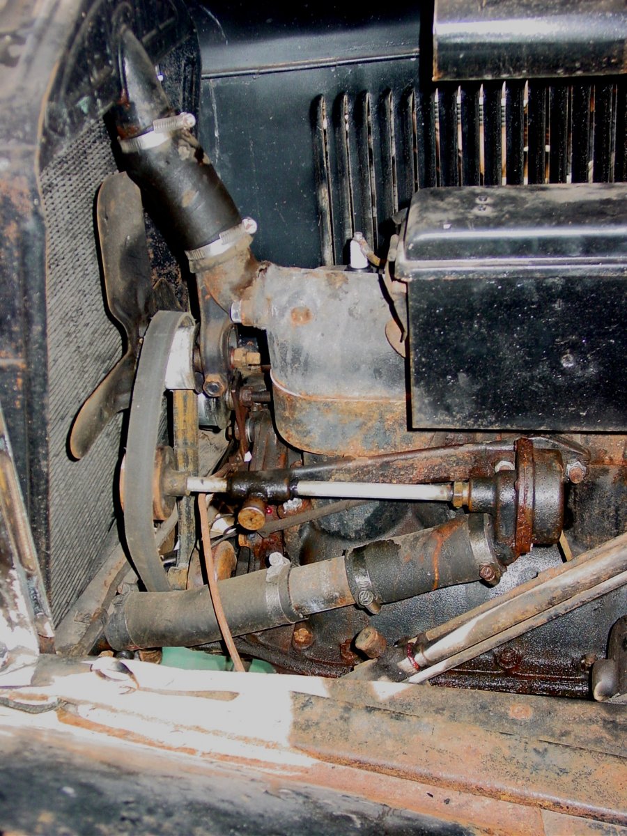

Couple of observations, the spark advance rod to the timer is placed over that large hose, unlike stock, you may have to change that out to get good timing. The carb has extra rod to it, that is linkage to a foot feed accelerator on the floorboard. The radiator is older aftermarket. Lastly, the radiator outlet with fan pulley is the early 1926 version, with adj. bolt below, Ford changed that to new style with fan shaft and eccentric to provide belt adjustment.

The number on the title says the engine assembly date was February 8, 1927, so yes, it's a 1927 engine. Look on top of the right frame rail under the floorboard. If the number stamped there is the same, the car has its original engine. It seems that matching numbers are a big deal on muscle cars. On Model T's that's nice, but nobody really cares. The car came from the factory with a vaporizer, which has been replaced with an earlier carburetor. This is quite common, as the vaporizer has a reputation for being troublesome. The car also came from the factory with no water pump because the cooling system is designed not to need it. So your radiator may be bad. A water pump is often used as a Band aid for that problem. I can't comment on the coils, as I don't see a picture of those.
Ask the previous owner if the rear axle has been rebuilt. If he says no, or doesn't know, you should make it a top priority. Here's why: http://dauntlessgeezer.com/DG79.html.

Post by Norman Kling » Wed Apr 08, 2020 11:45 am
It's hard to tell from the picture, but that carburetor could be a Kingston L4 or a Holly NH. Either kind is dependable and parts are available to rebuild. If you see a brass plug with a screwdriver slot across the top on the top of the carburetor just toward the front of the car from the adjustment needle, your carburetor is a Kingston.
The water pump is a trouble maker, they can easily leak and drain the cooling system. The original equipment just had a fitting on the side of the block with hose and pipe and another hose to the radiator. Usually the water pump was installed if the engine tended to overheat. With a clean cooling system and good radiator, the water pump is not necessary and in fact can actually cause the engine to run too cold in cold weather.
It looks like you have all the parts to make the car run. The Model T repair manual and the books published by the club, "Engine", "Transmission", "Electrical System", "Rear Axle" or "Ruxtell axle" and,"Carburetor" Are all do it yourself instructions and should be of great help in getting the car running or restoring it if you want to. Some just like to get the mechanical system working good and leave the body as is. Others like to restore the entire car, and others like to modify it by changing color or adding speed equipment.

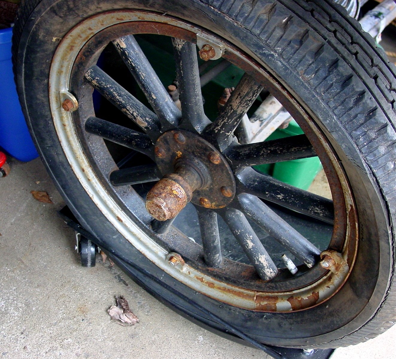

You should also inspect the wheels very closely for loose or broken or deteriorated spokes. New spokes should be made of hickory. Other types wood are not strong enough for wheel spokes.
You will need a "rim spreader" to remove or install the tires. Someone in your local club will very likely have one. They are good tool to look for at swap meets, or even antique stores.

I was looking again at your pics of the engine. In my earlier post I mentioned getting the T manuals to help you out. The previous owner added a water pump to it. You won’t find anything about water pumps in the T manuals because the didn’t come with a water pump!
Water pumps on a T is another thing you will learn about! But get it running like it is and then
deal with the water pump later. Good luck.

Steve, not a vaporizer car. Vaporizers use a throttle bell crank up near the firewall not down in the middle. My late ‘27 does it that way and has a vaporizer. Late production didn’t punch the web between cylinder 2&3 or drill the throttle hole in the valve cover. So it is possible he has the original carburetor.
Having the original engine for your car makes you smile... no one else cares.
I would only address the radiator and get rid of the water pump AND DRIVE IT!

As Stan says. Don’t remove and replace the coil boxes. Your Model T can’t talk to you without its’ coils. Jim Patrick

People change to a disturbutor because it's "more reliable". But I've been stuck by the side of the road more than once because of Chebby ignition trouble, never by Ford coils and timer.

Get rid of that non original patent plate above the terminal block! Ford never made those for Model T's. You need to find the correct horn and bracket made for 26-7 T's. You can't use one now because of that water pump, but if you choose to use one, they made pumps that allow you to use a stock horn. Have fun, and find a copy of the Ford Service Book, with the section in back on 26-7 models.

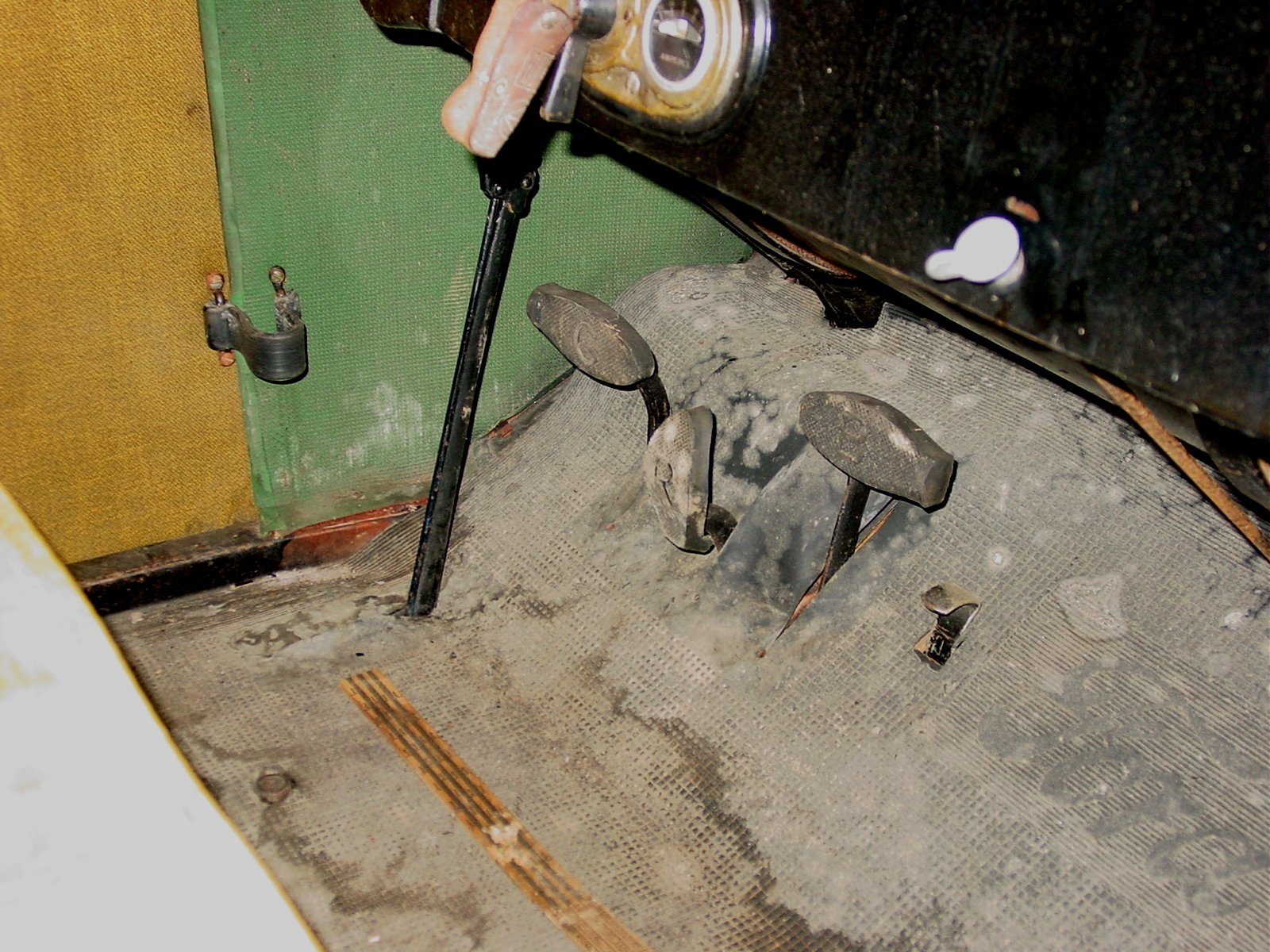

Yes, you do have an accessory gas pedal to the right of the brake. This is not original equipment. When you get used to shifting with the left pedal, and using the throttle lever on the steering column, you will find it is kind of like using automatic transmission and cruise control! If you have an accessory transmission such as a Ruckstell or Warford, you might find the throttle lever useful because you need your right hand for shifting.

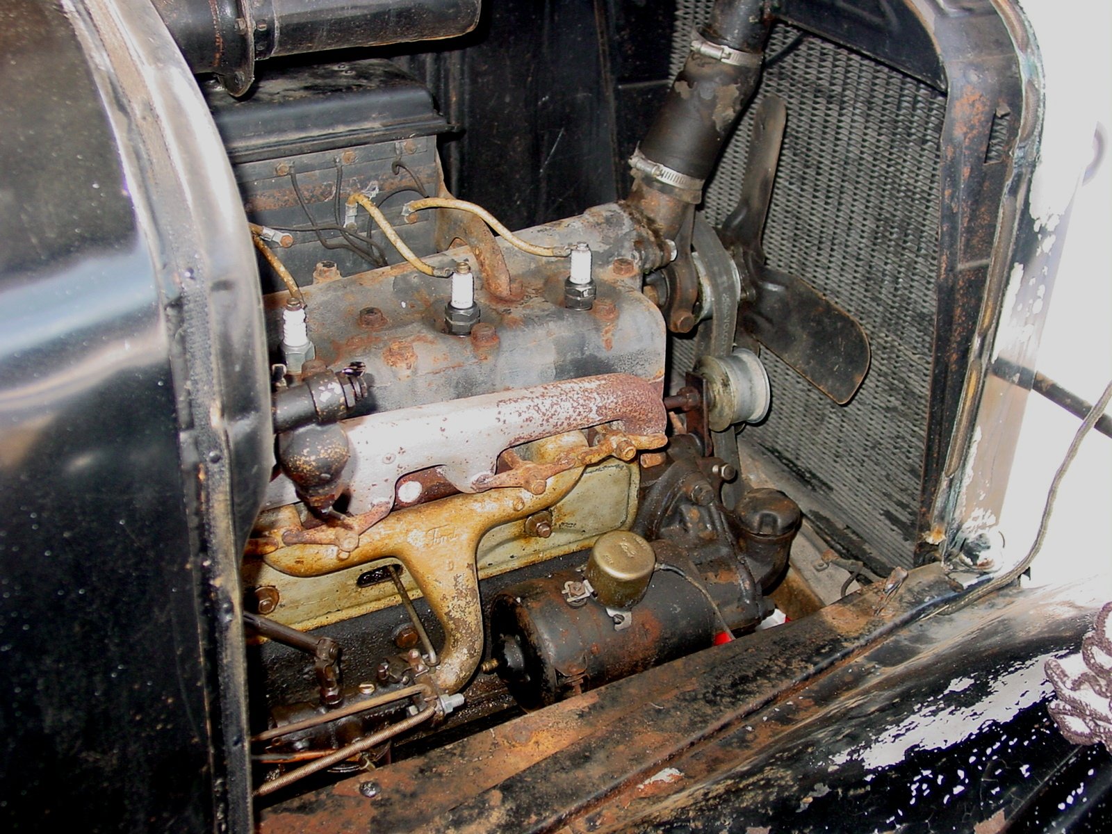

Another thing I noticed which is different, is an idler pulley on the fan belt. I am not sure why it was placed, but with the 27 fan pulley, the adjustment is made by rotating the eccentric fan bracket behind the fan pulley. When you adjust the belt, be careful to turn the eccentric in such a way the belt doesn't interfere with the spark advance on the timer. This is also somewhat dependent on using the correct belt length. This length would differ from the stock length without the water pump.
Hopefully, by this time, you might have already gotten your car running and found some club members in your area who will help you and get you acquainted with the peculiarities of the Model T.

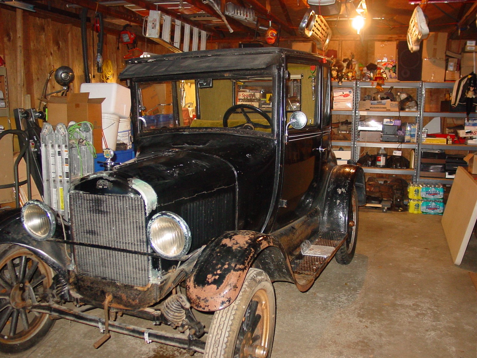

Hi, Dave -
It's always great to welcome new people into the flock. I hope you get a lot of pleasure and satisfaction from the coupe, it looks like a solid one.
One thing I think I see in the photos is the tilt of your front axle, or the lack of tilt. Normally the axle would "recline" with the top of the spindle noticeably leaned back. The tilt is provided by the spring perches and, as you already know, the car has Hassler shocks (I think they're great, they make a car ride like a baby buggy). It looked to me like the Ford leaf springs are twisted forward a little and that drew my eye to the spindles. The spring perches have to be turned in their holes for the Hassler geometry and, unless they are also swapped side-to-side, they will give negative caster.
The benefit the positive caster gives is it makes the car want to go straight. It will resist a little going into a turn, but it will almost straighten it self out as you come out of the turn. It makes easier to take on trips, unless you're driving in curvy mountain roads.
Not only does negative caster does not offer those benefits, it provides the opposite effect; the car will drive squirrelly, darting around. It's exhausting to drive one like that because you can never let your guard down, expecting the next jerk on the steering wheel. I know of at least one recent rollover crash (everyone survived) in a brass car because negative caster yanked the wheel out of the driver's hands and a front wheel collapsed.
I'm sure the forum guys will have good photos of how the axle should look.

Post by Steve Jelf » Wed Jul 14, 2021 12:20 am
I don't have a photo handy but see Page 45 in the Service Manual for an explanation and a picture.

Post by speedytinc » Wed Jul 14, 2021 9:02 am
The proper spring perches, in the proper side have a bend to give that caster. If Turning them around for Hasslers, they would have to be swapped side to side also.
The T1 service manual offers conflicting specs for the amount of caster. There is a dimension & an angle. Trigging the angle gives a very different upper spindle spacing. I usually set that difference @ 3/8". See manual. I have used as much as 5/8" for personal use.(Sure tracks nice down the freeway)
Its very common to find a T with the perches backwards. (axle backwards)
I recently worked over a front end. Final check to be the caster & toe in. Caster was 0. Looked close. Axle had 2 right side perches. That was a new one. Replaced it. All in spec now.

One thing you need to decide is where you want to go with the restoration: museum piece; factory correct; period correct(aftermarket accessories); "excuse me, its my Model T". You can also progress from one state to the other to get to where you want to go.
The aftermarket water pumps of the day did little to move fluids once the operating temperature was reached - most were just sinning propeller. If you need a radiator, no question that a Berg is the way to go. Model T aluminum radiators are for "T" Bucket hot rods water inlets/outlets corresponding to engines used. The beehive springs are Hassler shock absorbers - there was a different style designed for 1926/27 (i.e. Pancake) , mostly for the rear spring perches needed, but the beehives will work on the front. You need to be careful in removing them as they are under load. The front Hassler's perches were pointed outward. The beehive style required them to also be swapped from side to side as mentioned above. They should have the boss on top of the perch pointed back to the engine. Learn to search the forum for your answers to your questions - the SEARCH option in this version of MTFCA only looks at the 2019 & onward discussions. Use GOOGLE and add MTFCA to the end of query, Like This: Hassler beehive MTFCA
This is a good reference about them http://www.mtfca.com/discus/messages/50 ... 1426168045

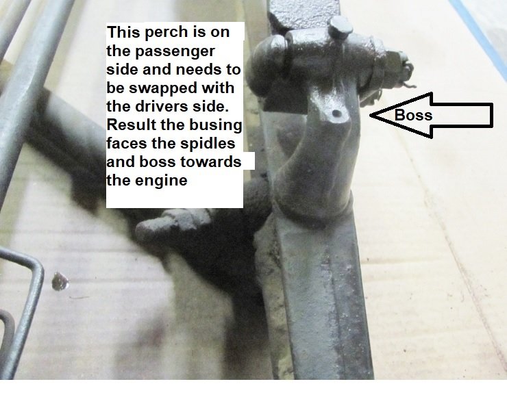

This attachment shows the front perches in their normal position, no Hasslers, and what needs to be done for the beehive Hasslers. Th Pancake style have a different requirement (just spun outward in place, no swapping, because the lever arm was designed to include the necessary tilt).

I reread almost all of the posts on this thread and respectfully disagree with one thing that was mentioned. I looked at the photos of your tires and noticed that the tire was badly cracked. I would move the car around the yard with them (I'm assuming that all are in similar condition) but would not take the car out on the road with them. I also saw that someone said that you need a special tool to get the tires off the rims. You do not. I have changed all five tires on my '27 and with a couple of big screwdrivers you can get the tires off. With your mechanical experience it should not be a problem to remove the tire from the rim. You will figure it out.

John
if you're removing and installing tires on split rims and are able to expand the rims to lock by just using a couple large screwdrivers, then you've been very lucky and just haven't met the right rim.

There are at least three different styles of rims on my '27, and none were a problem. Perhaps there are "improved car" rims where this cannot be done, but I have yet to meet one (including one new one from Lang's). I am referring to seriously big screwdrivers.

I'm thinking that putting on new tires may not be the challenge, but my limited experience is repairing tubes on old tires which at least for me, can be cause to lose one's religion even with a spreader.
Personally I hate split rims (based on limited experience) and am glad I don't own a car that has them.
BTW, I can pretty much picture your screwdrivers...they would indeed have to be big :D
