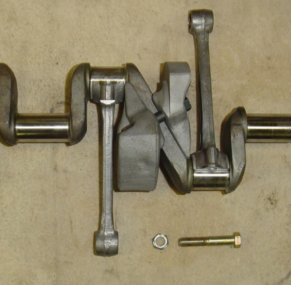

I’ve read some on the earlier forum about Dunn counterweights. Seems like a good idea to me.
As long as they are fit properly I would add.
What do you think ?
Stole this pic from the old forum...
Whatcha think about Dunn counterweights ? Like or hate ?

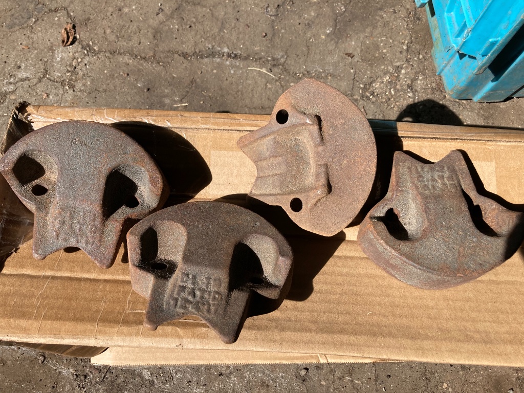

Can anyone tell if they are originals ?

I have seen both types. The repops seem to have a coarser surface. Originals are fairly smooth. The script is proud & clear. (Looked at mine)
Those pictured I'd bet are repop based on the appearance of the lettering..
