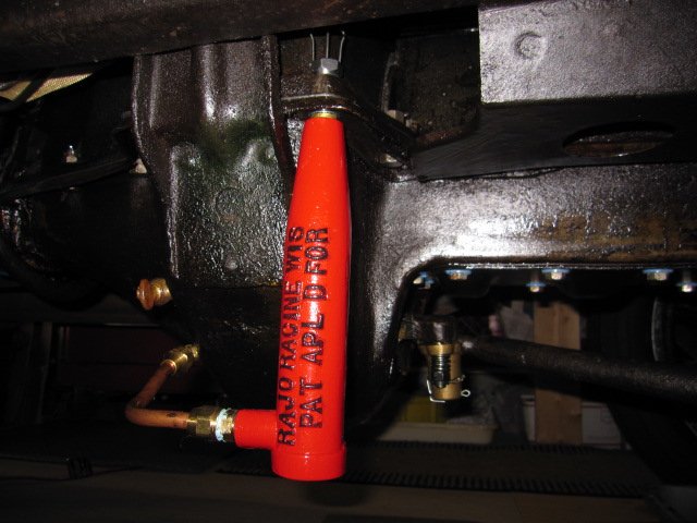

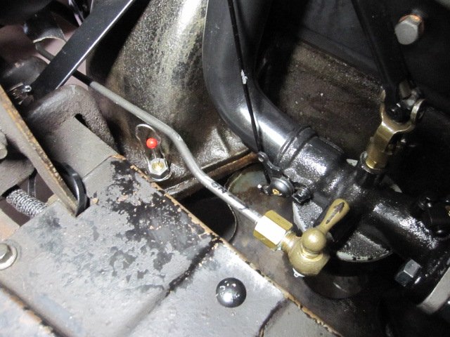

I installed the Rajo oil indicator from T. Mosher, put in 4 qts of fresh oil - no movement of the indicator, how much xtra oil needs to be added? Thanks

I bet if you contact Tim , he can answer your questions. 4 qts should be full. Its a little over full on mine.

Perhaps there is air trapped in the system. You may have to bleed it out.

When I installed mine, I left the upper petcock open and let the excess bleed off.

I have found that four quarts fills mine right to the top petcock. I have also found that engine oil leakage and consumption is virtually zero. I don't even check the oil level between changes (it leaks enough rear axle oil to make up for it).

Make sure you installed it in the lower crank case hole, not the upper.

Is the float in a bind? May need tweaking

The problem with the Rajo oil indicator was just air trapped, everything working fine... nice quality accessory. Thanks John
