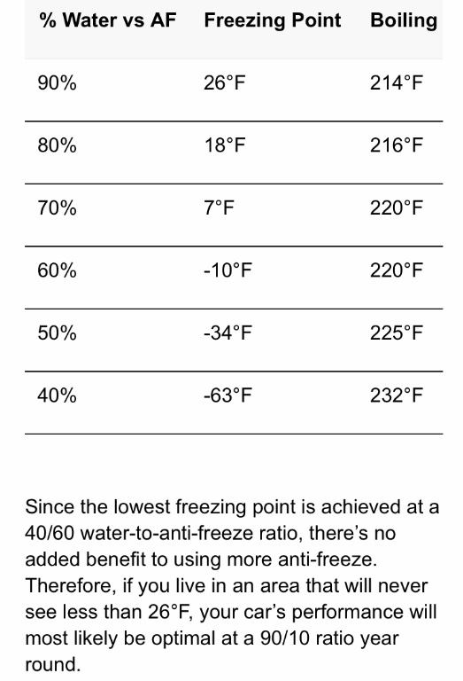

Being that water is a more efficient coolant than antifreeze, I was thinking of using more water than the normal 50/50 ratio maybe 75/25, does any know the freeze protection at that ratio. I live in the mtns of Va and winters normally don't get much below 10 deg above zero. Thanks

Here’s one chart you may find helpful.
I had my teen grandson do the math off the back of the container! Just use the coolant system capacity of your T, brass radiators and low heads have less capacity.

You never want more than a 70/30 ratio because, once the antifreeze ratio exceeds 70%, the freezing point actually rises.
100% straight antifreeze has a freezing point of 0 to minus 5F.
I'm in Minneapolis where it never gets colder than minus 20F. In my case, 50/50, which is pretty much standard when modern cars leave the factory, will more than suffice as the protection is to minus 34F.
If I lived further north, I would go 60/40 and if I lived in International Falls, then I would go 70/30.
