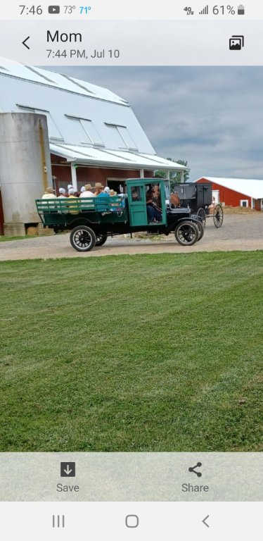

This one has 7:1 rear end gears and a Chicago 3 speed with the 23" kelsey rear wheels. The 9 ft wood bed and wood cab makes it pretty heavy. Have never weighed it. I run in direct drive most of the time. 25 mph is where its happy. In Chicago overdrive it will run 42mph . It has a very stock engine with cast iron pistons. Engine balanced and aluminum pistons and advanced cam can increase speeds.$$$ is the only thing you need. I am not really a tour guy so speed is not a factor.
Being last in line has its advantaged. You get to see all those cars without looking in the mirror. If you take a wrong turn, you blame the cars in front.
TT's are fun because you dont see as many on the road. They are useful around the farm for many things. In the photo above, the neighbors wanted to go for icecream.

Dallas, that is pretty cool. Looks like a truckload of Menonites enjoying the day, get ice cream without firing up the ol' hit-n-miss!
Nice pic, nice truck. Good that you got it fixed up to go faster when you want or need it. We like to tour around 28-30, I try to hold mine down to 29, both Clara and especially Isabel the torpedo love to go faster.

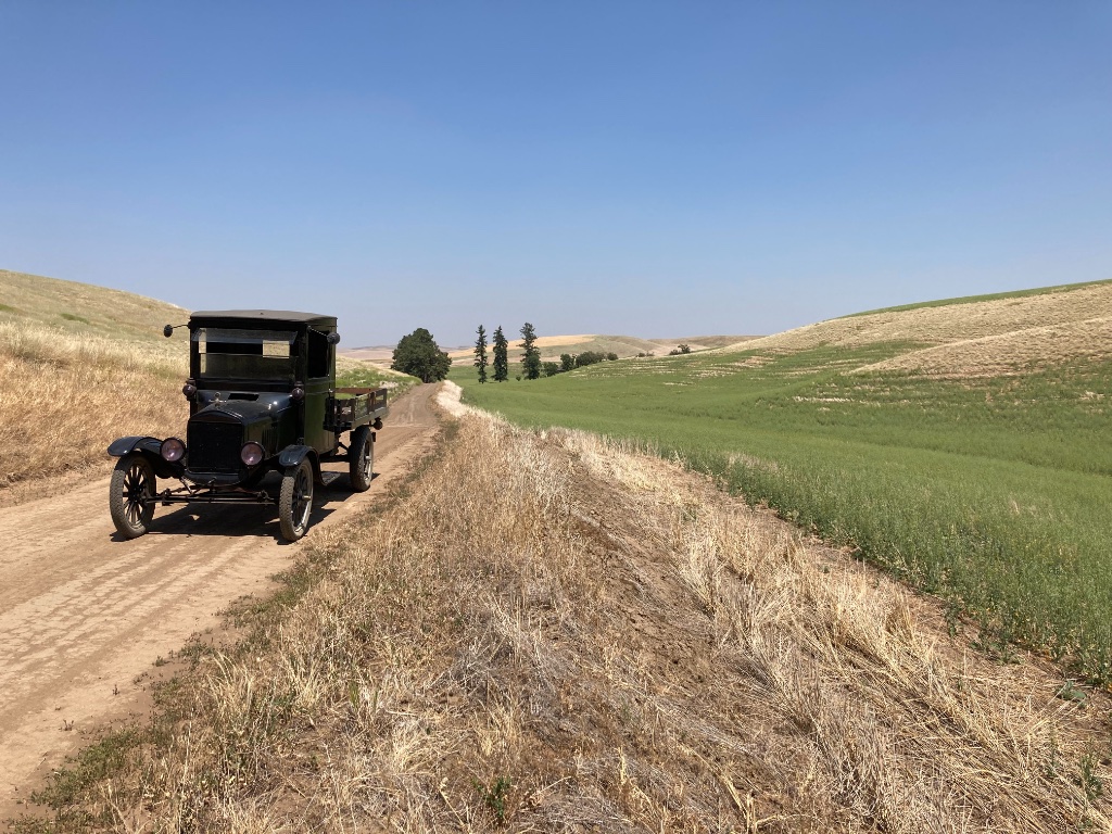

This came to me with an unbalanced, likely original build drivetrain and 7:1 gears,
with a Ruckstell. It went OK to about 15 and then the shaking began. At about 20
the vibration slowed and a wound out speed of about 23-25 could be achieved, but
the poor engine was really going !
A rebuild with careful balance was done. A Z-head added, C-race cam, SCAT crank,
and an OF carb rounded out the engine tweaks. Out back, I swapped in a 5:1 gear
set, and with some good tuning, the old dog will kick down the road comfortably at
40, with a top speed of 48 on flat ground. I have no overdrive, but plans are in the
works for a Lincoln 3-speed to get that. The math says this will make 55mph cruising,
with a top speed of perhaps 65 ?
Now, realities being what they are, this is insanity territory for a vehicle with serious
braking limitations and the positive steering of a T.
I use my TT as a truck, and most times it is found either hauling materials or open
road trips like in the photo. Speed for getting "out there" is good, but my pleasure
driving is generally done on Model T era roads, where going much over 25 is limited
by the road itself.
As it was explained to me when I got serious about owning one of these, there are
two sides to this challenge. One is gearing, and the other is developing enough "umph!"
to push those gears on such a limited power range engine. Both sides of this must be
addressed to get a decent cruising speed in all terrains.
