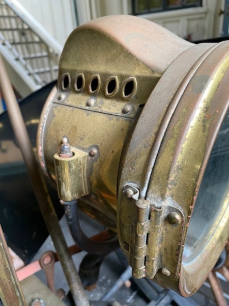

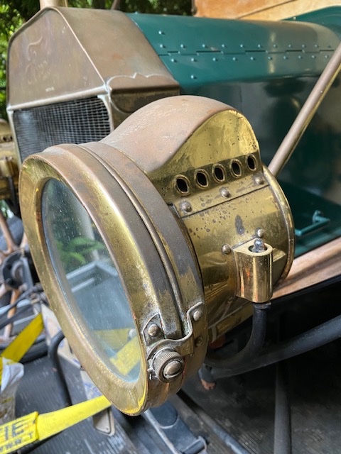

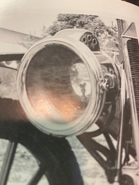

These 1911 E&J 666 headlamps (color photos) have 5 angled football shaped holes in both sides of each vent cap.

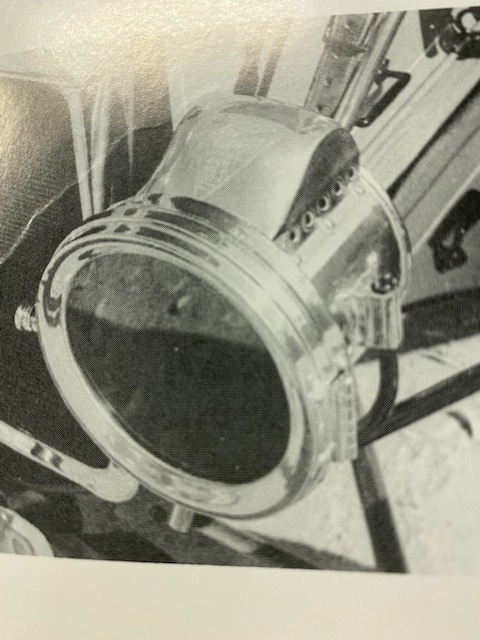

However, Bruce Mcalley's book (black and white photos) shows the "correct lamps" as having either 5 small "round" holes or only 3 "larger" holes on each side of these cap vents.
So, I am hoping that one of you distinguished gentlemen might shed some light on this mismatch.

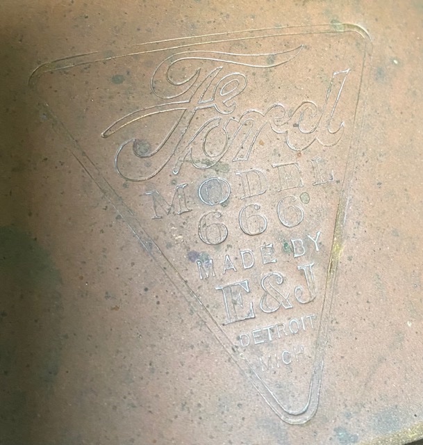

Labeling on "football style vent" lamps.

Larger 3 hole vent, McCalley's book.
Football style vents.

The 3rd picture is of a Jno Brown headlamp, not E&J.
Herb Iffrig
Posts: 1762
First Name: Herb
Last Name: Iffrig
Location: St. Peters, MO
Re: Correct 1911 Touring Headlamp Question?
Post by Herb Iffrig » Sun Jul 18, 2021 11:21 am
I agree with John, it is not an E&J.
Thank you John and Herb for your comments that the third picture, the "3 hole lamp" pictured in McCalley's book, was manufactured by Jno Brown Co. That's why that particular one is different from the one I photographed.

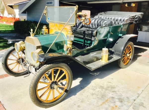

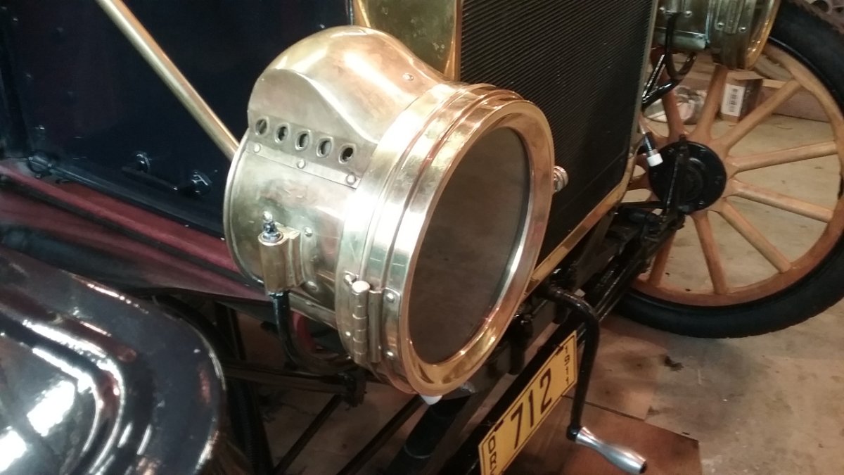

Would you also have an opinion on whether or not the E&J "football vent" headlamps, (picture #4 and #5 in my above post), are correct for a 1911 Ford Touring car?
1911 Ford Touring w/ 1926 drive train

Steve, is this a new beauty adding to your collection? Frank

I doubt that a touring makes any difference. Both were used. Probably depended on the supply bid at the time of assembly and/or what was in the supply bin at the time. My Torpedo have the 666's.

Football shaped vents on the E&J 666 is correct for 1911.
Some torpedo roadsters and my late 1911 have E&J 666 "no name" headlamps.
-Keith

She's a Beauty Steve, Hope you like it. Enjoy getting it tuned up for the road.
1912 Torpedo Roadster

The E and J 666 lamps did come with variations to the bonnets on top and the side mounting brackets. I believe the earlier bonnets had the branding on a small brass plate riveted to the bonnet, while the later bonnets had the branding stamped into the actual bonnet. I do not know when the changes were made.
the side brackets can be like the ones in the last photo, or they can be a simple plain shape without the necking down around the fork arms. Again, i don't know which proceeded the other or when.
I guess that doesn't help much, other than to alert you to these details if you are looking to make a matched pair.
