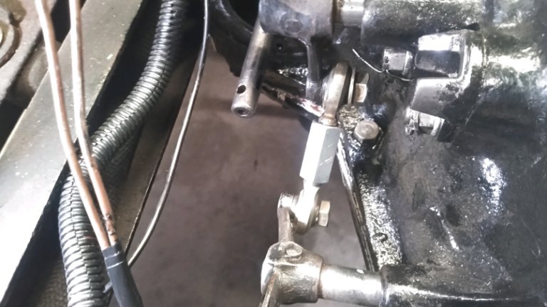

Today I finally got the '13 back on it's new spokes, Rear parts of the Rockies Installed, and ready to toss in the Brake Pedal.. Got it all in and started to adjust the Trans Bands to do an Initial Clearance of the pedals..
Well Darn.. the Clutch Linkage of the '13 ( Starter Hoggs Head ) has been Modified ( Butchered ? ) and has a Heim Joint assembly installed..
All of this new 'Stuff' has forced me to 'Inlet' ( Dent ) the Starter Cover to allow access for Heim Assembly to clear the Starter Cover..

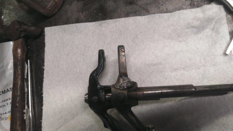

I've had to Fab and Weld a Straight Arm Extension, to get around the Tighter than normal Space to get to where the Rockies arm is wanting to be.. I'm using Electric Nickle Rod.. Great Stuff

I'm speculating that some other person chose this method to 'Fix' Severely warn out Linkage arms. They drilled and Tapped the Arms to accept the Bolts that are now in them. Both the Low Peddle and the Clutch arm will need to be replaced.
For some reason, the Low Peddle is 'Out to the Left' by about 1/2 Inch, where it was hitting the Starter Cover.. To me it looks like the Internal Cam needs some sort of Spacer behind it, to move the Low Peddle 'Inboard'.
While the Hogs Head was off, I replaced the Internal Cam and the Low Peddle Shaft thinking something might be wrong with them.. After assembly it was the same.

the pedal is likely just fine as is the clutch lever...just out of a non-starter car.
If the low pedal link is mostly vertical down from the pedal, it is for non-starter...if it is angled severely toward the hog's head, it would be the correct one (and would have cleared the bendix.
I remember the other thread now...that was one cobbled up specimen. You've done the owner a service by getting all of the time bombs out of the transmission.
