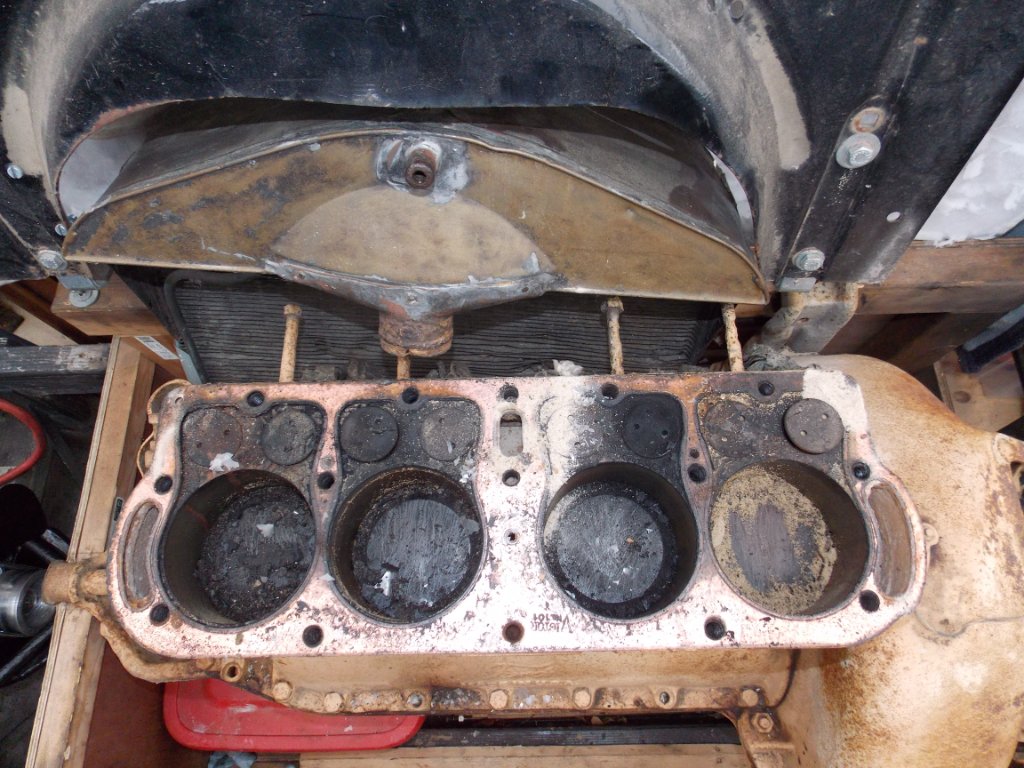

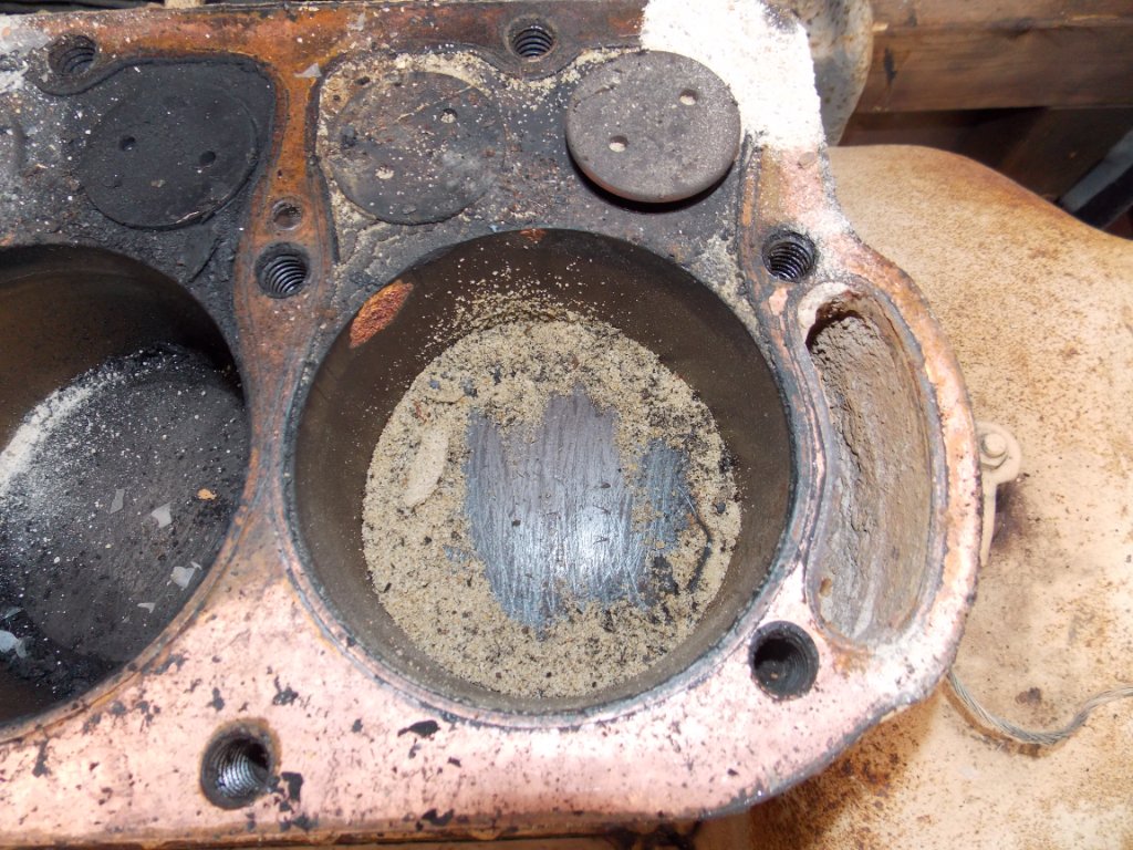

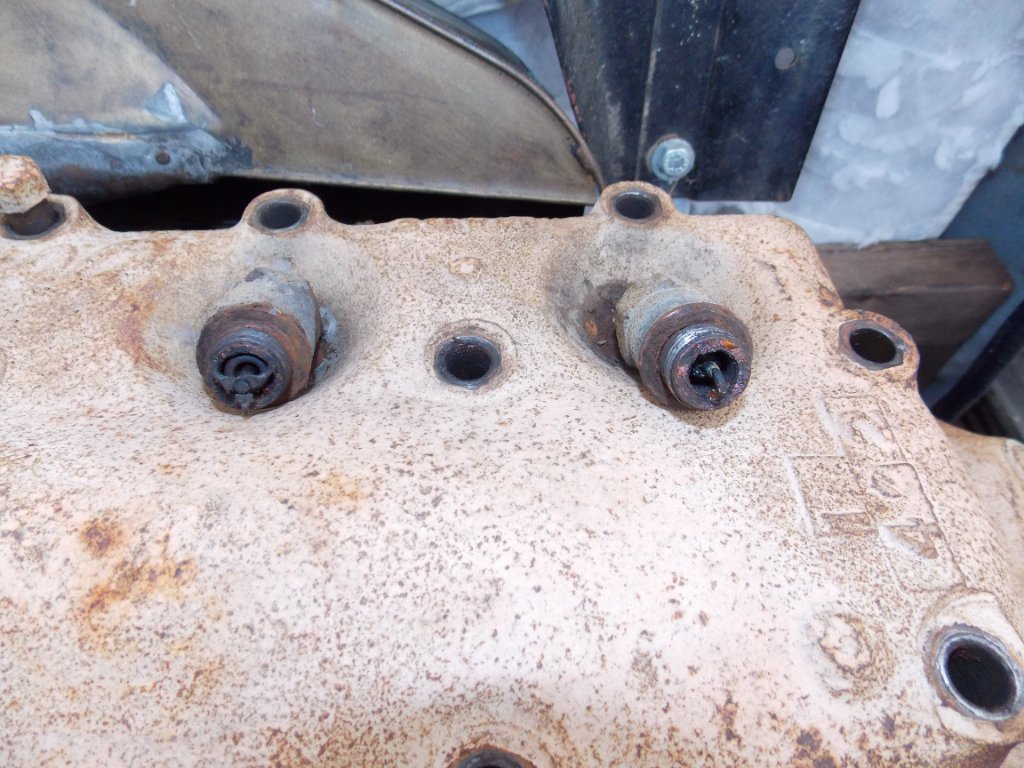

I never tried to make it running.
I paid $40.- for it in the state as it was, (photos in attachement)
Somebody asked me if it was a boat anchor. As I took off the head I found a lot of "desert" sand in the cilinders and the water jacket and no oil .
The head has 18mm spark plugs.
Andre
