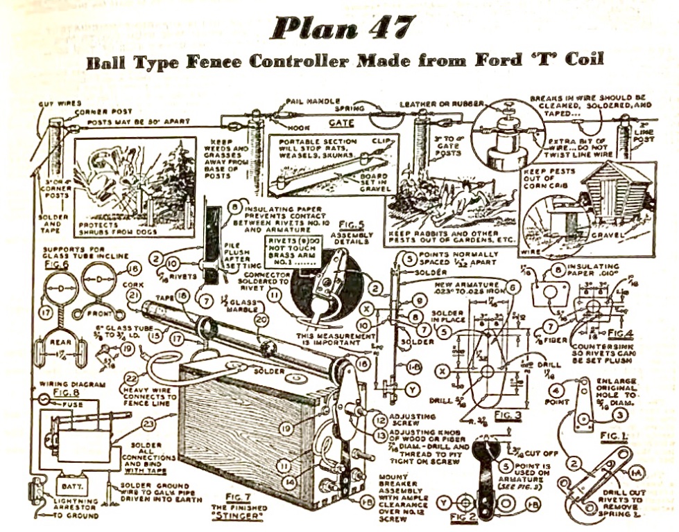

Here’s the drawing from the Lejay Catalog.

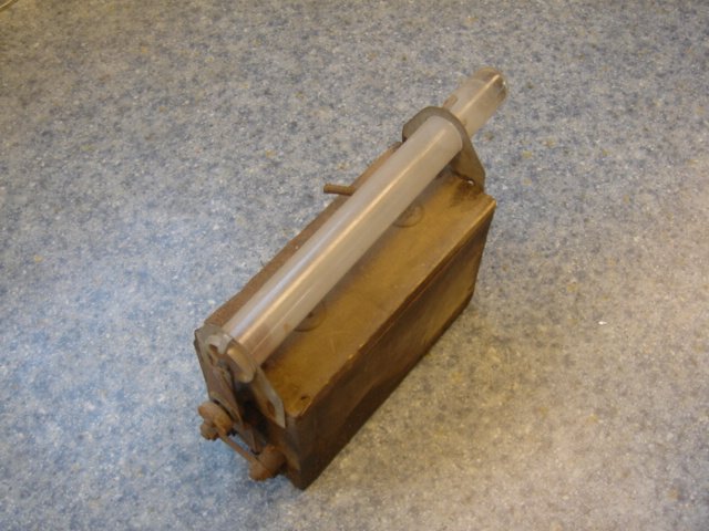

Here is a photo of the one I have in my coil archive.

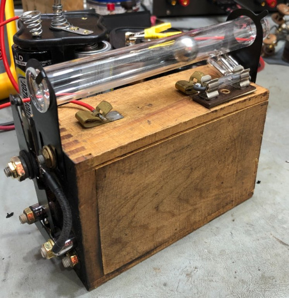

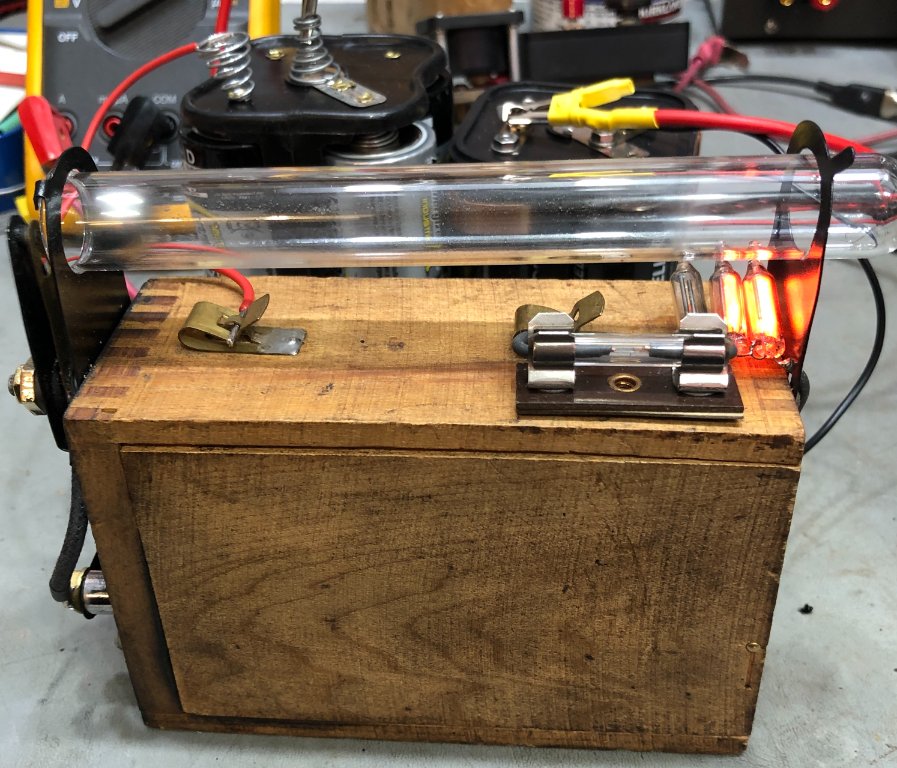

the fuse Is a good addition. when I got mine the points were welded together and the springy part witch the ball hits was burned in two. had to make a new one. a rain gauge tube is about the same length as the coil box looks neat except for the numbers.BE_ZERO_BE wrote: ↑Tue Jul 20, 2021 1:34 pm
A Test Tube works great for a glass replacemnet.

The "fuse" is actually the glass from a fuse with two electrodes and a spark gap inside.
In addition to the three neon light bulbs, it is an visual display of the spark when the coil fires.
