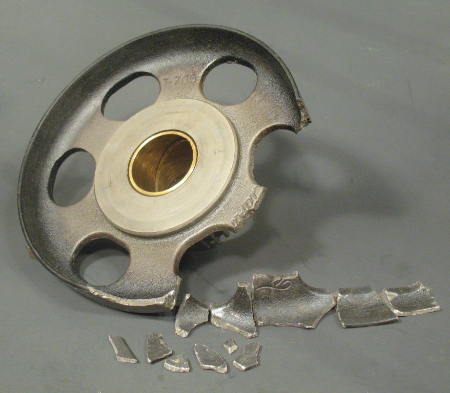

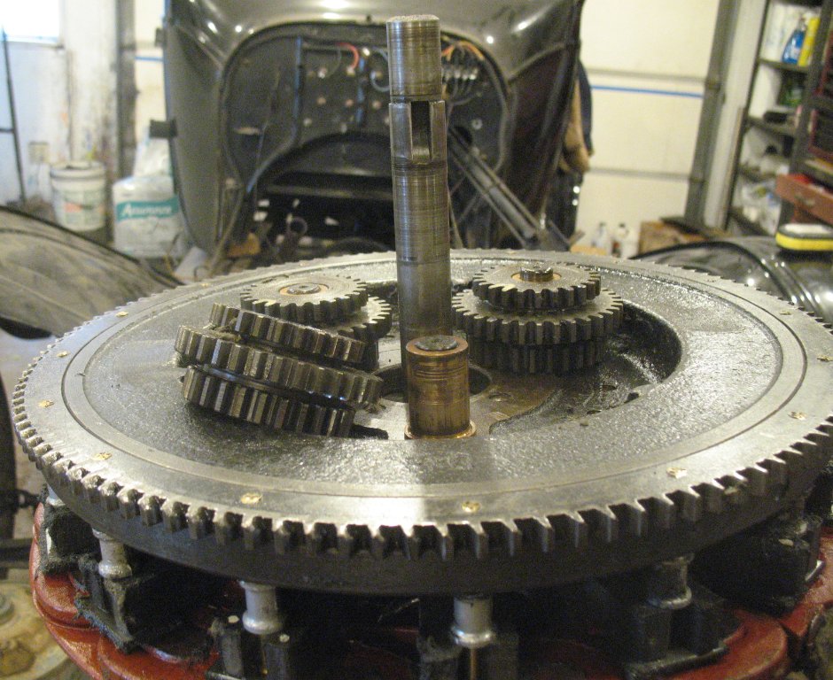

My 1923 touring suffered a broken low drum. At the same time it had two seized triple gear bushings. Did the seized bushings cause the broken drum? Did the broken drum cause the seized bushings? Were the two malfunctions unrelated and coincidental? You may opine.

Steve, can you post photos of the failed items?

Not quite a opine, but just a guess from looking at the two posted pictures of the transmission. The triple gear bushing in one gear looks like the front face is worn off as shown by the pin sticking up past the gear, it looks like the ware was over a long time and not a quick thing.
A second gear shows the bushing stuck to the pin but with what looks like old ware on bushing to gear contact, meaning that the bushing was spinning on the gear and not the pin. The third gear looks ok. These transmission gears were very warn but still going at time of drum failure. The picture of the failed drum shows that its bushing is warn but ok. There for the broken drum caused the end for a very worn, but still working, tramission.

I suspect that the whole transmission was too tight when it had been rebuilt by whomever years earlier. Probably, the triple gear pins and bushings seized first. Once they chew themselves up a bunch, they start banging everything else to pieces.

Looks like drum got hot. Running kevlar? Ergo, too tight, hi spot or out of round band. Was kevlar band installed thru the inspection cover?

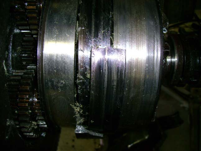

Sometimes the rooster crows during the daytime, so it is not always what causes the sun to rise. Sometimes there is no rooster and the sun rises. The two are not related. You are lucky that's all that happened. You have probably seen what happened to one of my cars when the drum broke. The whole transmission was destroyed, but the crankshaft did not break. Fortunately I was just starting out in low so not moving very fast, but the whole car locked up. I couldn't even push in neutral. The two might be unrelated, however, I suspect when the drum broke, a piece jammed into the gears causing one or more to stop while the flywheel was still turning hence the bushing seized. Anyway, you will need to replace everything which is broken. One thing which can lead to low drum collapse is the cam and notch on the low pedal are worn. In that case, the only way to get the low band to operate is to adjust it very tight. When it is that tight it drags when in any gear except low including neutral. That way the drum gets very hot. You will notice in the picture attached, the drum was blue. A blue drum indicates it has been running hot and that also takes out the normal temper of the drum causing it to crack easily.
