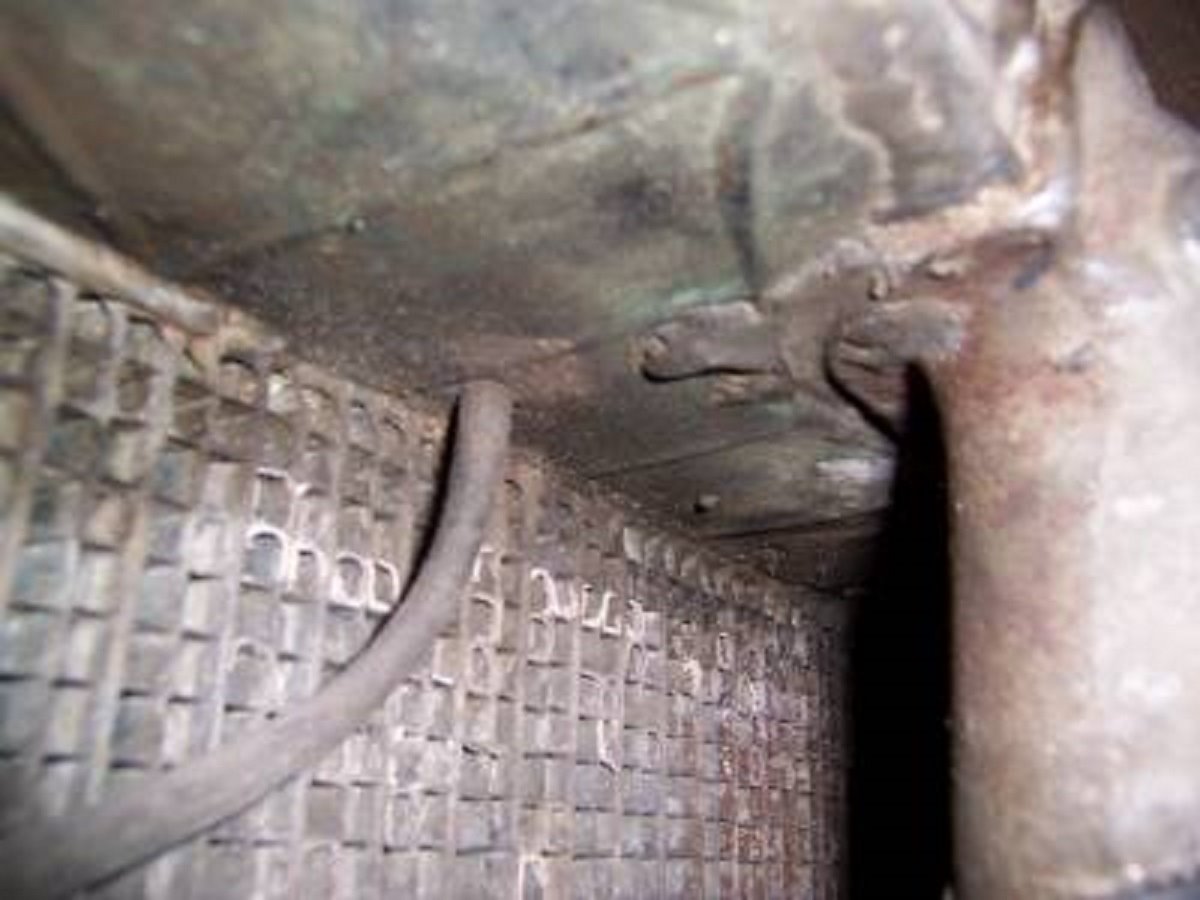

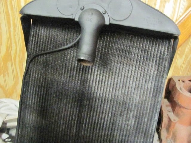

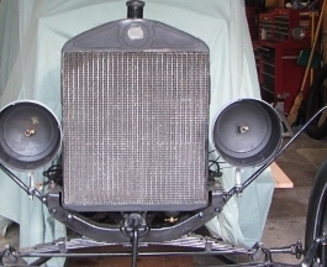

Did custom replacement using heater style core to save me $$ by making a veneer from the original honeycomb core, soldered to the face of the new to replicate. The type of original core was too difficult to fabricate.
Worked fine and looked original.

Call them, tell what you need done. They have a space at Hershey too to accept radiators to save shipping, that is what I did.
The radiator was a special honeycomb with vertical fins between, very rare and maybe unable to duplicate.
So had them use a heater core style like an early Chev. but they then cut off 1/4" veneer from the old core and soldered that on the outside!
Finished result, yes they did the core install and repaired the entire radiator, the outside looked just like the original, unless you peered into the 1/4" of original core and spied the heater type core.....but so, got the radiator working fine, and to me preserved some of the old core that counted!
