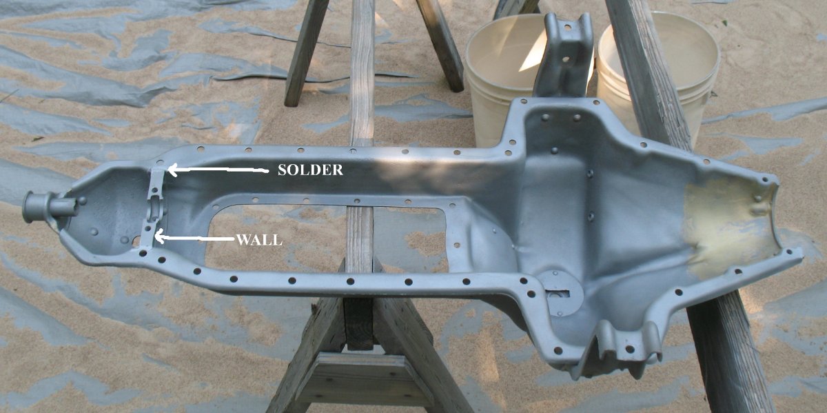

I believe I have a considerable oil leak at the front end of the crankshaft and was reading in the service manual "Stopping oil leak at front end of crankshaft" and it talks about "If the oil leak occurs around the front wall, it will be necessary to solder the wall" what are they talking about, is the solder used instead of a gasket? Just trying to get a handle on this before I attempt any repairs of the crankshaft seal.
I'm thinking they are talking about the timing cover and today I would just use a gasket but I'm not sure, please educate me.

The front wall in the pan is riveted in place and soldered to seal it to the pan. Over time, the solder can crack producing what can be a considerable leak. It should be re-soldered, but that means taking the pan off. Others may have an on-situ temporary fix that may hold up until you have to pull the motor.

Look up some photos of the oil pan. The pan is not sealed completely around it's perimeter. There is a dam/wall in the nose section that stops the oil but allows the pan to go on to support the crank. You can look down and under the crank/fan belt pulley and see the front of the pan where your crank bushing is attached to the nose of the pan. There should be no or very little oil there.

Post by Steve Jelf » Fri Jul 23, 2021 10:16 am

:D Steve answered his question precisely without saying a word!

Post by Steve Jelf » Fri Jul 23, 2021 3:02 pm
Many times a picture is worth at least
