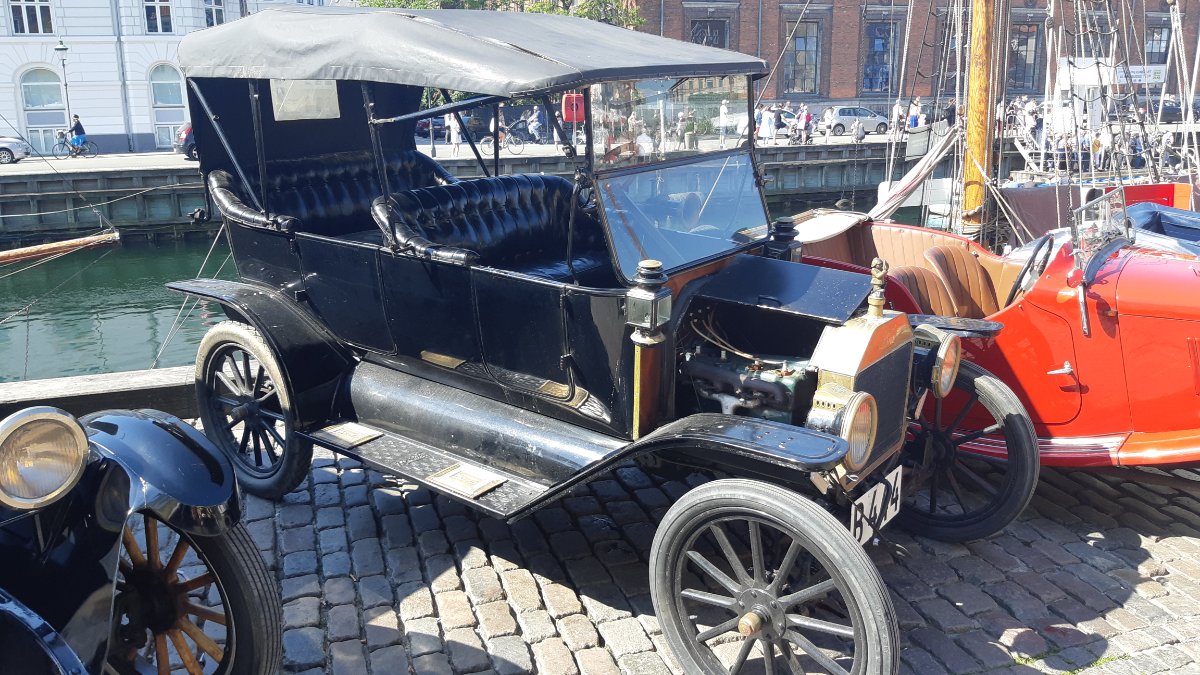

My 1914 have no starter, so it is turning the crank when you want to go.
9 out of 10 it starts at first or second pull (not counting a choked pull when cold), but that 10th time it just requires (to) many pulls and often when there are spectators :-) It's often when warm but have cooled a little. there is normally no life, not just the slightest "couf" and then out of the blue it starts right up.
Buzzer coils "talks" as they should at each pull.
It is most likely a carburator issue - as I may not yet have learned when I need to choke a little or adjust the mixture less lean but I am out of guidelines when to apply.
Any help is appriciated.

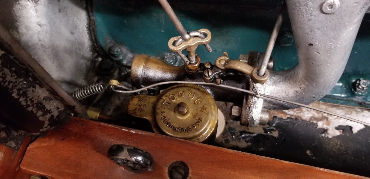

I did not mention what carburator I have as I could not remember exactly how the name was spelled :-)
It's a Touquet which was an aftermarket sold in the days (or maybe later).
Apart from the occasional starting issue, the carburator seems to work very well, so I assume the float level is OK.

The Toquet sounds like it's meant to be a gas-saver.
