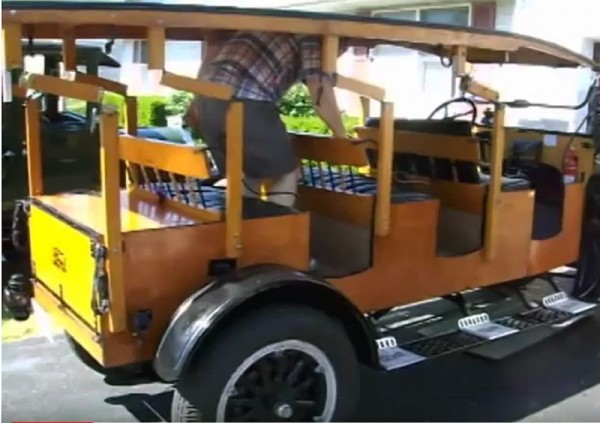

My friend is considering building a Depot Hack but has height issues with his garage door. He saw this on Youtube where a fellow hinged the uprights on his hack body so the top could be dropped more than a foot. With this arrangement it would fit in the garage or a enclosed trailer. Anybody ever seen this done? Any idea what the hinges look like?
Posts: 6728
Re: Lowering top on Depot Hack
Post by Scott_Conger » Mon Mar 25, 2019 7:02 pm
Not a big fan of the concept, but at least I would hinge them opposite such that they were not trying to collapse when hit with wind from driving. I'd sure want them to "lock" under wind pressure, not fold down. That looks like a great way to get a head/neck/back injury with little warning.

Looks like a strap hinge. " barn door hinge".
Looks like a PIA but if he is building it and not cutting an original, maybe a telescopic setup could be designed?

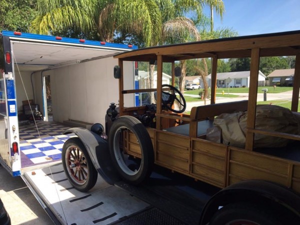

I'm 5-7" but have a 27 inch inseam...so that makes me sit at about the height of someone 6-1 or so...on my Hack, we allowed for 2" head clearance with me in the driver seat, cut the uprights to suit that, and I can pull into and back out of just about anyones garage. On Bills Auto Works closed trailer with a drop door, there was about an inch to spare once inside...but it fit!
