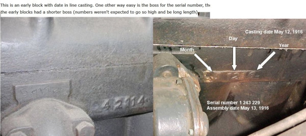

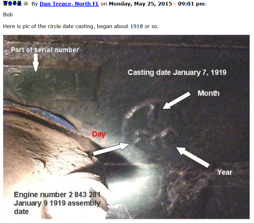

First the engine serial number was not cast into the block but stamped, the date the block was cast was cast into the block.
Since there is always the possibility of a rebuilt/replaced engine, you should see if the engine block casting date is in agreement with the engine serial number. As stated earlier, expected to be withing days.

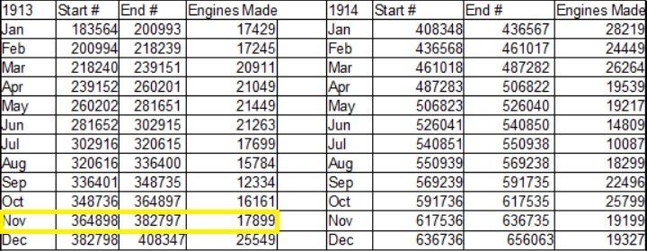

Decided to do some math - no one needs to agree.. Looking at the range of engines built by month, it would appear that the average production was about 17,000 a month, this would imply that they had to turn over 4,250 week (storage space limitation). It is reasonable to assume that engines built in late October and the first 2 weeks of November 1913 were used to build Model T's prior to the first generation of the new assembly line going into went production on December 1, 1913. Given the date of your engine (and assumptions) it would reasonable to believe that it was used to built a T in the first week of November 1913.
