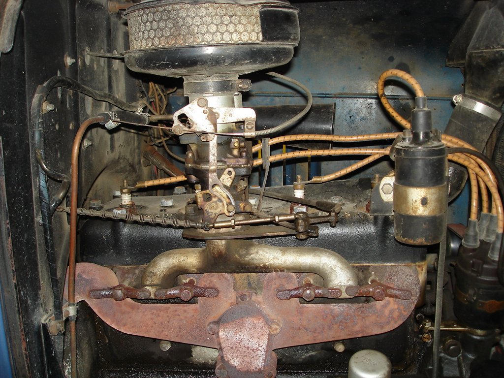

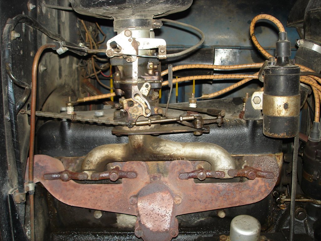

My first T was my speedster. I set it up with a home made header & a WF Carter down draft on a manifold made from a model T intake. For a old worn out T it ran pretty well. Some feel that the size of the T carb. and exhaust govern the speed and this was designed into the car for reliability. A couple of things to consider are if you use the stock exhaust a down draft will have to go around it. If the carb. leaks it will drip on the hot exhaust and maybe
the sparking generator brushes. I run a Shebler up draft now its larger than a NH and is still adjustable from the drivers seat ( some thing that very few down drafts do ). Unfortunately most up draft manifolds are centered and do not leave enough room for the generator.

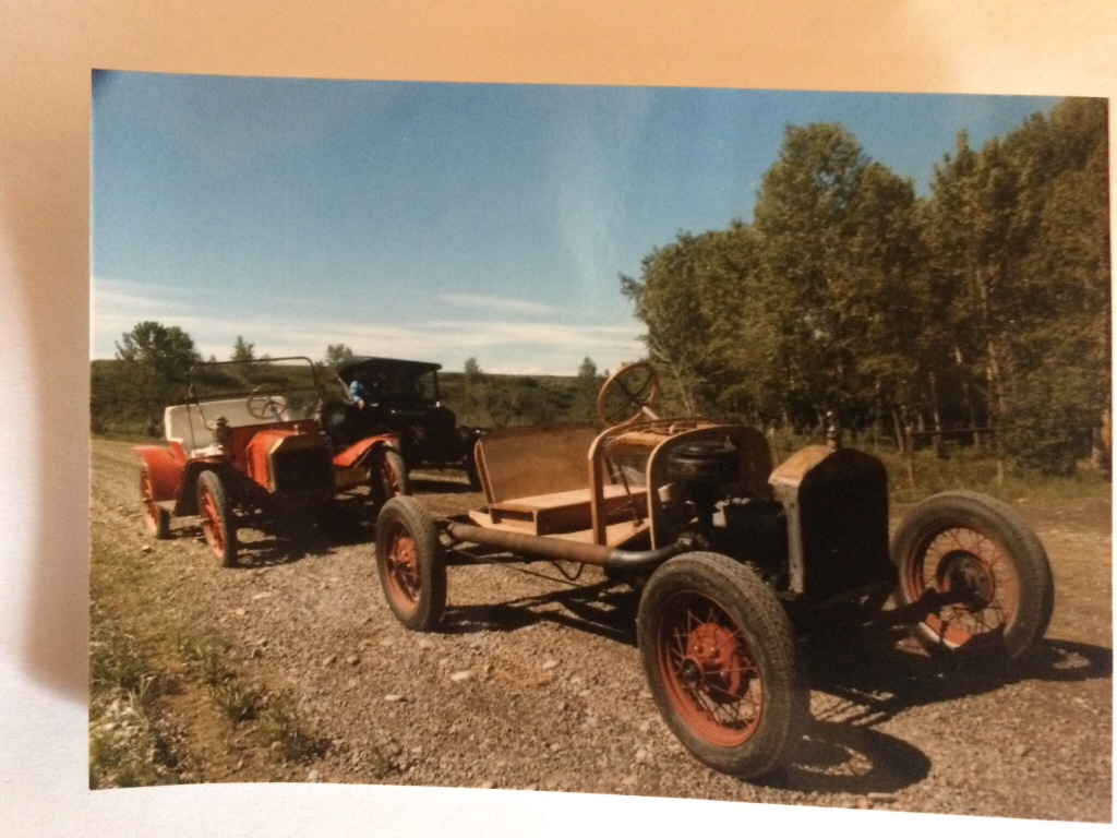

In my opinion (and experience), modifications should be considered a “package”, if you want to get a decent driving car. Attached is a picture of a modified T engine I built in 1978!

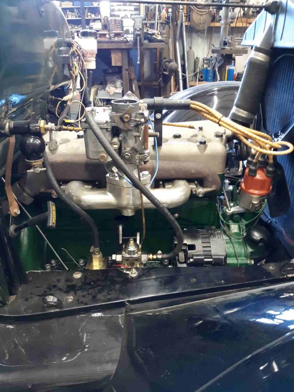

Re: Thinking about a downdraft manifold and carb. Any suggestions?
This set up works real good. I can pull hills right along with Model A's. As stated you will need a fuel pump and I run a regulator. I'm currently running a Solex 34 PICT-3 carb while my Winfield is on the bench.

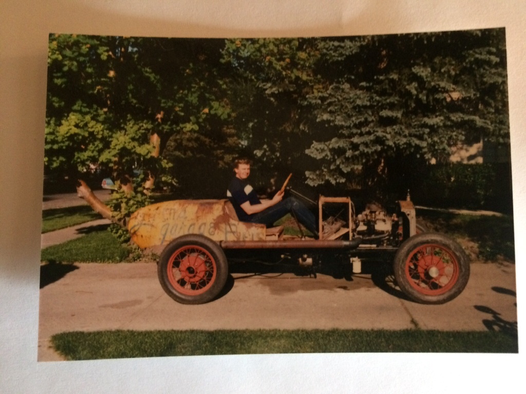

I ultimately moved the engine into this car and changed to a Stromberg 97 (flathead V8 carb). Car is capable of 100 mph!

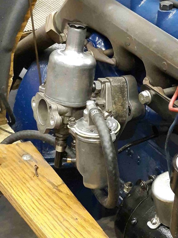

Just for interest speaking of different carbs, this is a SU I'm fitting up on my Speedster. The motor is pretty much stock but for Chevy valves, aluminum pistons, stock cam grind with a advanced gear and a low head plus a distributor. Ran pretty good with a Simmons carb. Interested to see what the SU does for it.
