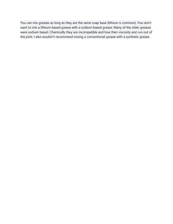

It is the different kinds of soap in the grease that don't allows get along. I use lithium based grease because it seems be be the most common and it seems to work well.

Re: Mixing U Joint Grease ?
Don't remember where I got this. Have it saved on my computer.

Some greases will mix together and then harden probably don't want that either.

I agree it's probably best not to mix greases, for the reasons cited, but I'd also say the thicker it is, the better. One of the functions of grease in the U-joint ball is to act as a dam that diverts leaking engine oil from running down the drive shaft tube and into the rear axle.

You mean the ring and pinion isn’t lubricated with 30 W non detergent Steve ??
... just kidding. Thanks for all responses. I’ve decided not to mix grease - just take the full grease cup cap to a trusted auto parts guy and buy a tube of the same non moly stuff.
