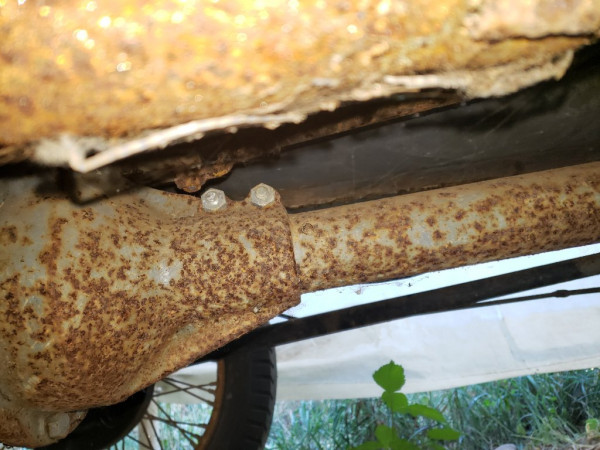

I inherited a speedster from my father in-ĺaw. There is a shift lever in the middle of the floorboards. Incorrectly assumed it was for a Ruckstell. Have not had time to truely look at things and today I noticed the diff. is factory but has a unit attached to the front. Any ideas what I have? I will be able to get pictures later.

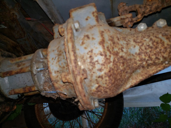

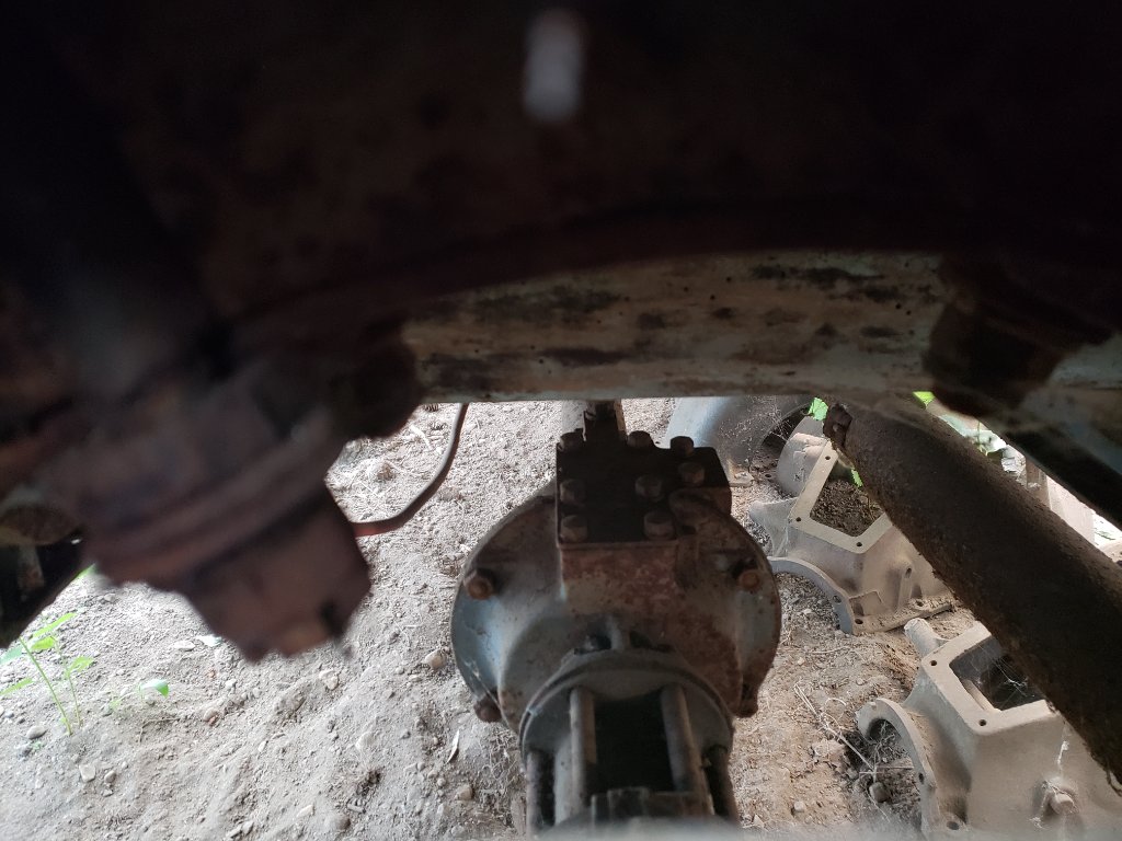

Sorry for the poor angles. I am working inside a tent with too many things piled up around it. Here is what I have.

I do think Scott is correct. Looks like I got me a Planitor. Now the fun starts...

It’s a Planator. It provides direct and 50% speed between the drive shaft and rear axle. It uses many model T parts. There is one completely custom sliding gear and one highly modified axle gear. All the others are regular T rear axle gears.
They work well but the 50% speed reduction is a little too much. JMHO
