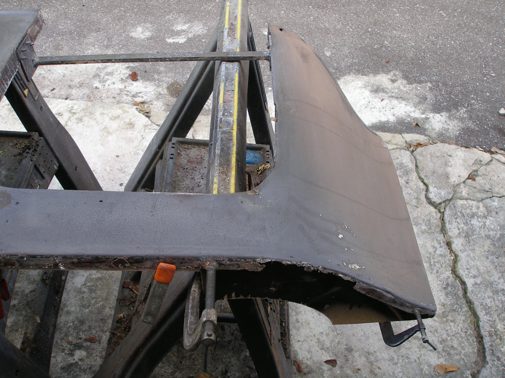

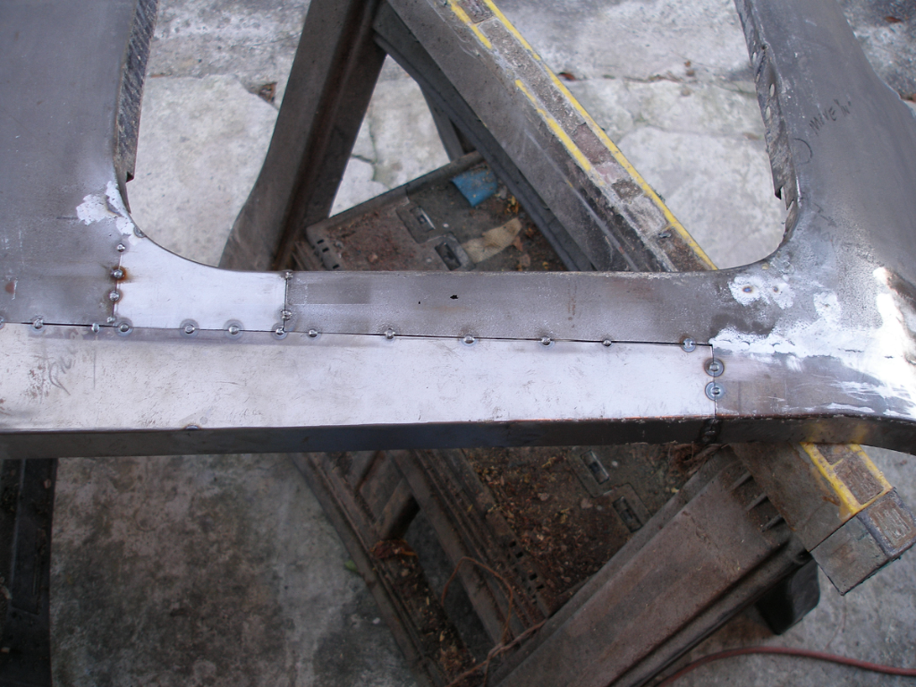

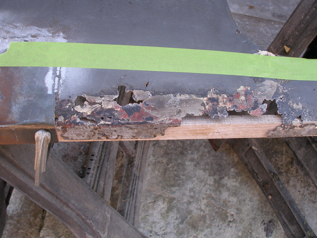

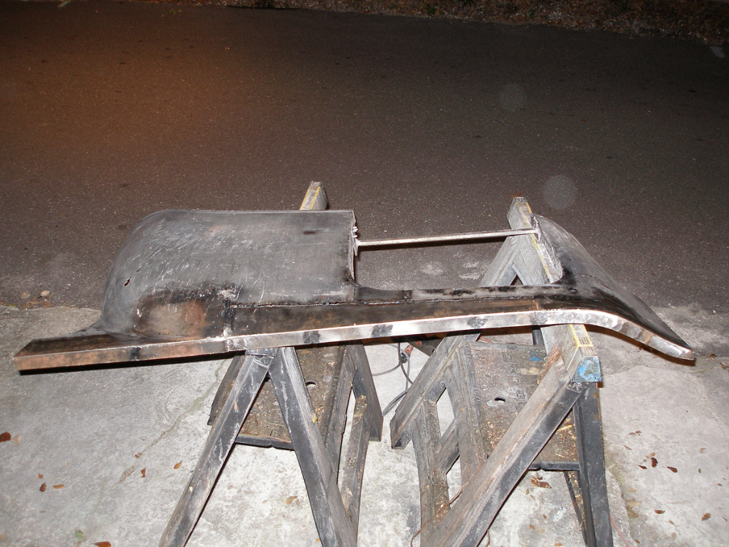

- Posts: 6800
Re: 1915 Touring body assembly
Of vital importance on the sheetmetal is the shape of the door openings. I found that the rotted lower 6" of my body allowed the panel to flop uncontrollably and allowed wood framework to appear to fit when it truly did not.
I finally made a standoff that bolted through a couple upper hinge holes and then into the latch. The spanner was very carefully cut and welded in so as to mimic the correct door opening when the body panel was installed, meaning the width of the body at the latch was greater than the width of the body at the hinge, and yet the door opening at the top had to match the door (plus 1/16").
Matching backing plates were made so that the machine screws clamped the sheet metal and the panel became VERY rigid and was much easier to handle and repair. You can see from the extent of the repairs, the panel could never have kept shape without it.
