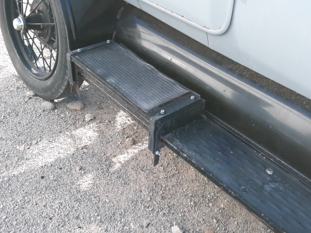

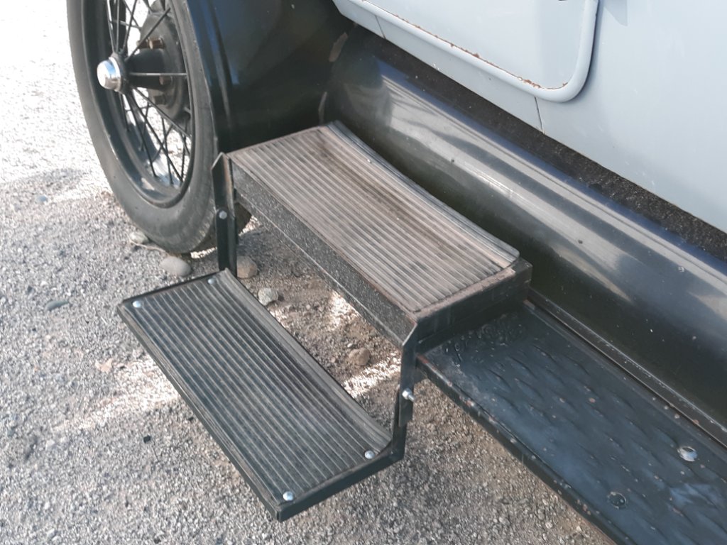

My wife had a stroke and had a hard time getting in to the T so I made this folding step for her.

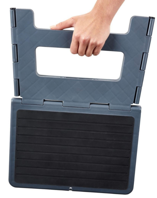

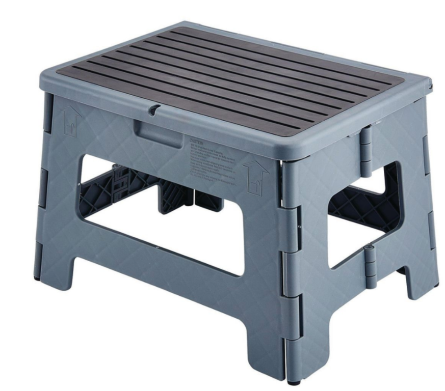

I bought a FRANKLIN One-Step Folding Stool from Harbor Freight to help my 93 year old mother get into my tall 4wd pickup when I moved her from SoCal to OR. It works very well and would help her get into the Model Ts just as it does with the pickup.

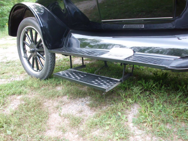

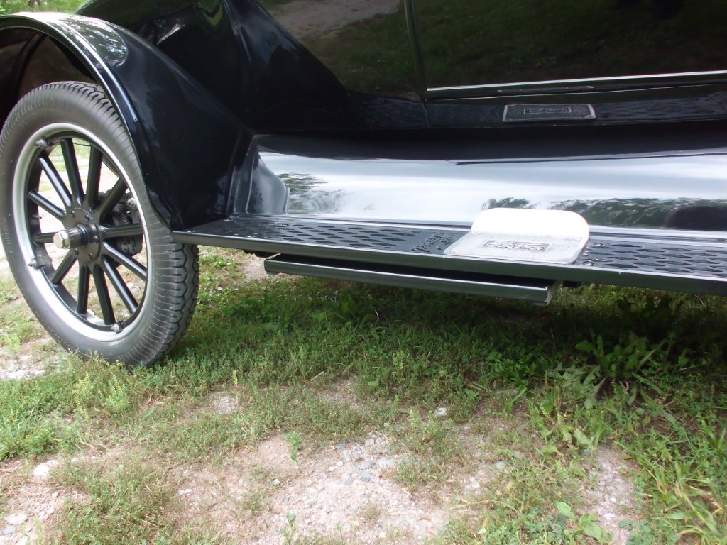

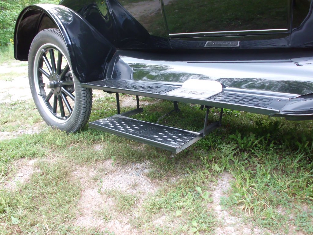

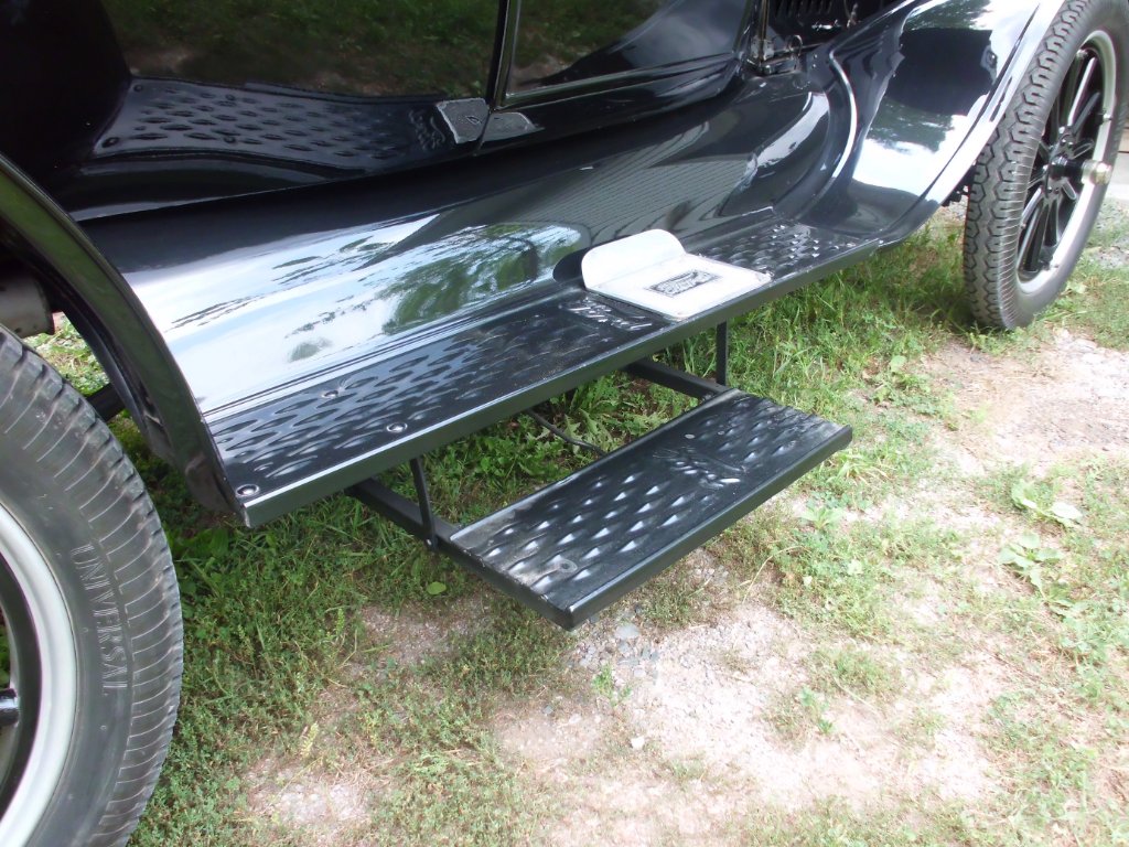

I can't take credit for this adaptation. Done by Bruce Compton on this 1925 coupe I bought from him a few months ago. A portion of running board cut down to make a step plate. Uses a 1954 Lincoln power seat motor. Probably any 6 volt power seat motor would do the job, just as long as it is clutched so as not to burn it out when the travel limits are reached. Toggle switches mounted just inside each door to operate it.
