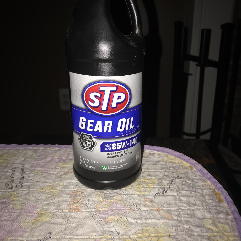

I hope this isn’t a Marvel Mystery Oil, which engine oil should I use?, which grade gas is best? knock-down drag-out discussion thread.
I had several local T club members over for a barbecue yesterday.
I mentioned that I recently rebuilt and installed the rear and driveshaft on my ‘24 Touring.
When I also mentioned that I was going to add the STP 85W-140 pictured, several members insisted that I use 600 weight oil instead.
Comments appreciated.

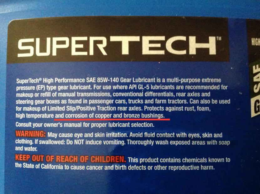

Need to check the GL of gear oil to see if suitable for bronze parts. GL5 is very high in sulfur so not an oil of choice for bronze.

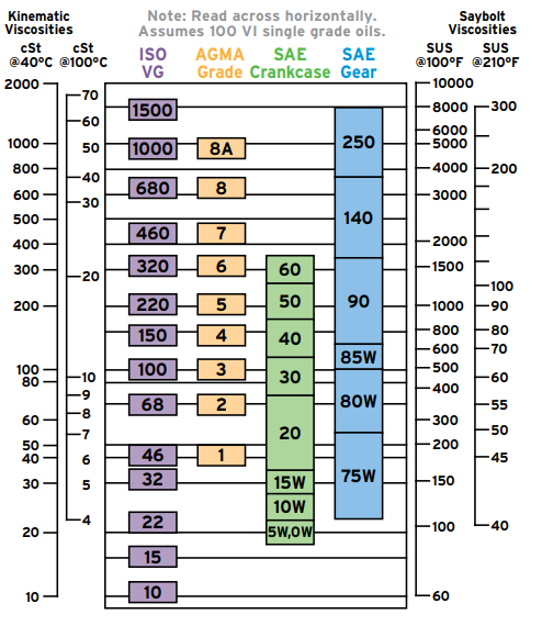

Keep in mind that 600w rear end oil is on the ISO scale, not the SAE scale. SAE-600 would be like peanut butter. Here's the equivalency chart (also note that SAE engine oil is on a different scale yet):
That said, 85w-140 GL4 is a good choice for a stock rear end, and 85w-90 GL4 for a Ruckstell. They all need good outer-axle seals, including the original 600w.

If I'm reading the chart correctly, 600 W would correspond to about a 160 W gear oil. I'd think that 140 W with about 25% of one of the STP-type additives recommended for gear cases would be a close match in everything but color. If you want the brown-black goop look, add a little graphite or dry powdered roux.

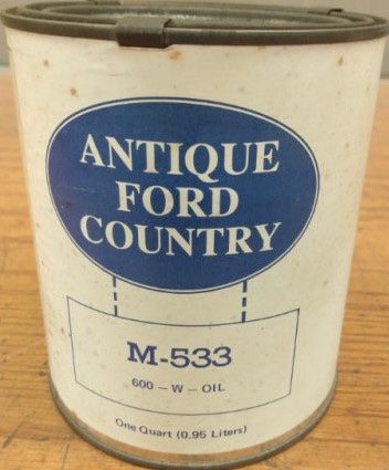

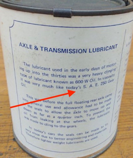

Will agree with Hank and others, that Ford specified the heavy fluid grease "600w" for the rear axle for good reasons. The gear type of the ring and pinion, those thrust washers, and the Hyatts inside. All benefit from a thick fluid grease.
This label is from an old can of 600w sold via Snyder's years ago and identifies this lubricant as close to SAE 250 fluid grease. 600w is what I have always placed in stock T rear axles, and minimal leakage, and maximum protection.
600w equivl label copy.jpg (67.08 KiB) Viewed 6410 times

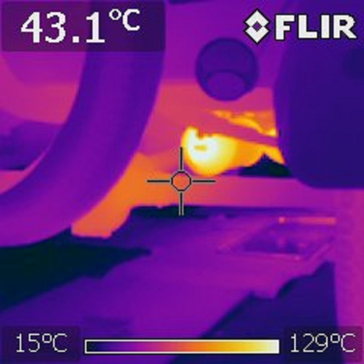

Another reason too is that the rear axle is exposed to the exhaust gases from the T muffler end, and of course, there is the heat from friction, all this heat can make a thinner rear axle oil like 85w-140 become even more less viscous. For me, stick with 600w, the gears like it sticky too. :D
