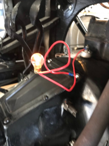

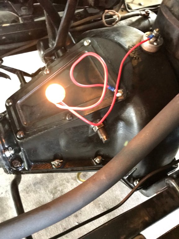

Yesterday I was driving to the grocery store and my mag quit. It backfired a couple of time and then the engine died. I coasted to a stop, turned it to "bat" and it started right up but it just dies if I turn it to "Mag". Testing the ignition switch, it has continuity from the mag post wire to the coil box with the engine off and the switch turned to Mag. I put an 1156 bulb on the mag post and it glows dimly at idle and gets brighter when I speed it up. Unfortunately I don't have an analogue volt meter and the stores are closed for the August Civic Holiday (Canada). Until now the mag always worked without a hitch. Is there a test I can do on the mag coils? Checking resistance through the mag post to ground is essentially 0, I'm assuming there isn't enough resistance in the mag coils to amount to anything, is that correct? Any suggestions would be greatly appreciated.

The mag is producing , as evidenced by your light bulb. It would seem to be a switch issue. Repop switch?? Probe the switch with your tester.
Caution: dont accidentally get any voltage to the mag post, then you will have a dead mag.

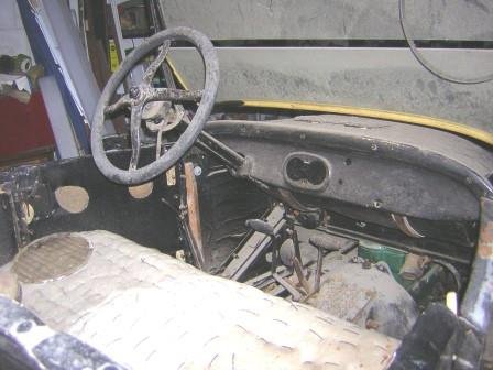

BTW, your transmission cover is up side down.

As far as the trans cover being upside down, does it matter if I'm running an oil screen under it?

& yes, with the screen the cover orientation is not as important. It may still create a drip into the screen's oil holes. If there are no interference issues, I would turn it over the next time it needs a new gasket. No hurry.

Ok so I ran a wire directly from the mag post to the coil box, eliminating any switch or wiring. Pulled the spark plugs and cranked it over as fast as I can by hand. No spark. I even held the end of the plug wire in my hand while cranking and there's no jolt at all.
Thats a good test. But that doesnt fit with your test bulb lighting on mag output. You should have good fire. With the light bulb hooked back up looking @ mag voltage. when you crank does it still light?
Possibly you have a poor connection inside the post to field coil. Pull the mag post & clean.

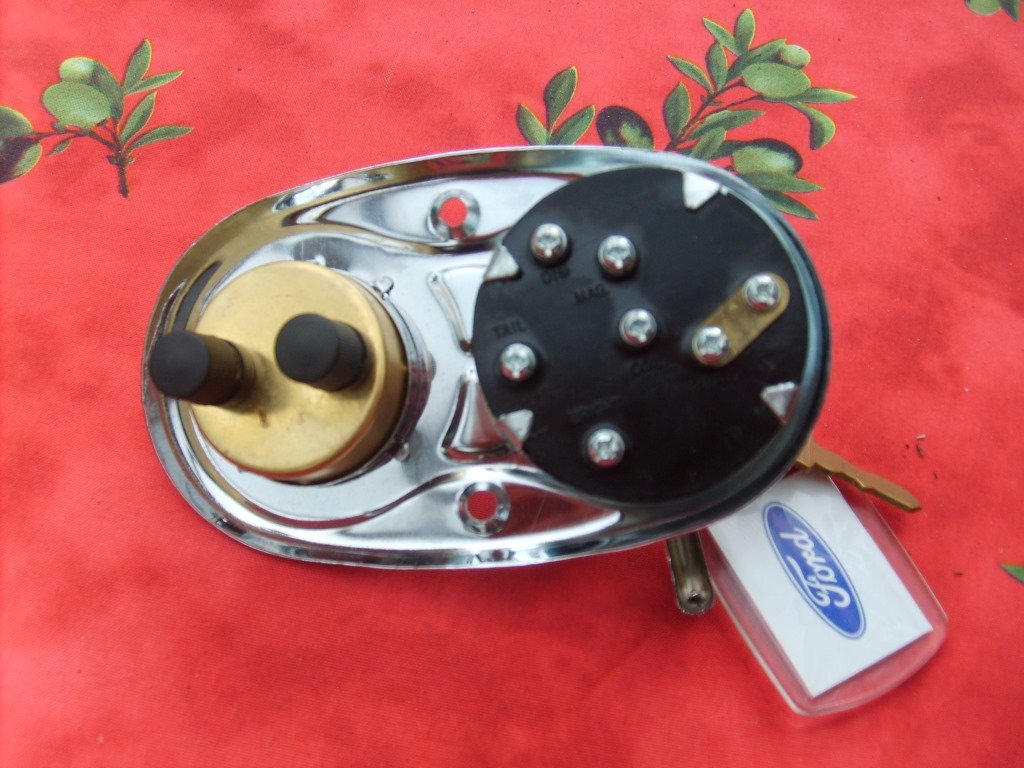

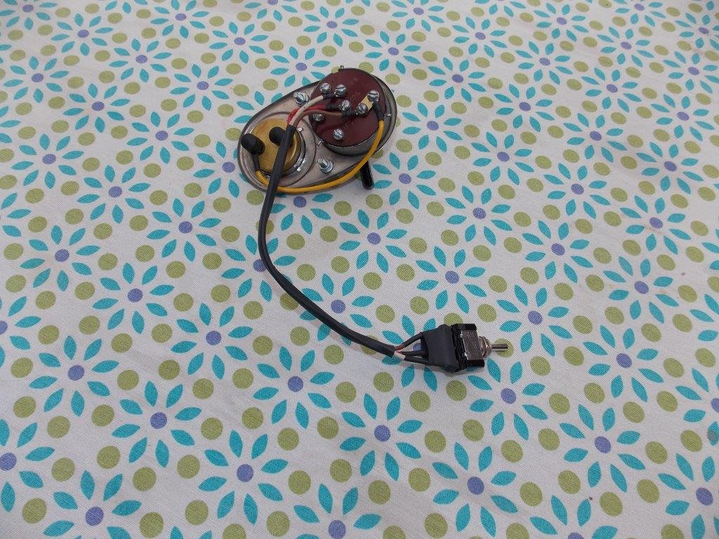

I was there before on my 1926 touring and did the repair on the old switch twice than I bought a "new " one.
After a few runs, the new switch, get wrong too.
For ten years now, I am running the 1926 touring with a cheap three way switch and use the original " old" switch only to set the lights on.
Here is what I did.
I cut the centre contact in the middle of the switch and connected the "cheap" three way switch on the mag; bat and ignition posts.
The middle of the switch connection go to the coilbox, the side connections go to the battery or the magneto terminal on the old switch connectors.
The three way switch went in a hole that was in the dash before I bought the car.

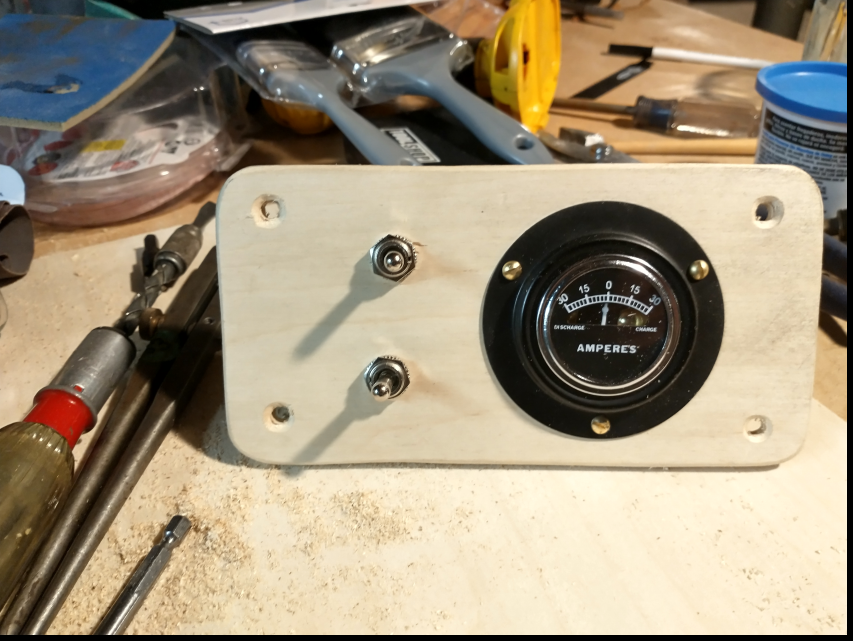

Post by JamesD » Sat Aug 07, 2021 4:36 pm

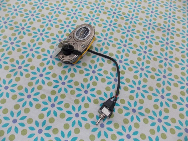

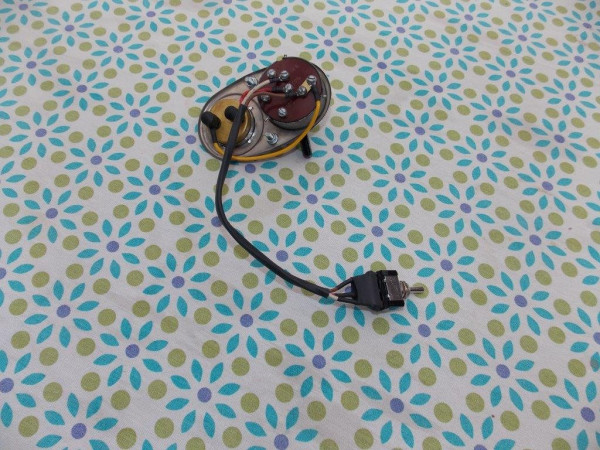

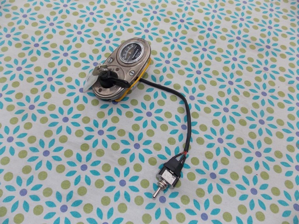

I think I'm winning. I took out the old switch and wired up two On-Off-On switches to replace the ignition and lights. Made a temporary dash plate to hold them and the ammeter. Went for a 3 mile ride and no mag issues. Started running on three cylinders, but that was a loose coil in the coil box. wiggled it a bit and it ran on four again. I had put new wood in the coil box some time ago, but one of these days I'll spring for the modern plastic kit. I'll run it like this for a while to make sure everything is OK and then work on getting a correct switch again. Any way it runs on mag!! Yay!
Posts: 6799
Re: magneto quit
Post by Scott_Conger » Sat Aug 07, 2021 4:53 pm
Good for you, and fingers crossed that you've isolated the issue (I believe you have).
I'd love to see how you wired that up.
Posts: 6799
Re: magneto quit
Post by Scott_Conger » Sat Aug 07, 2021 8:15 pm
a SPDT center-off switch would replicate the ignition switch function perfectly

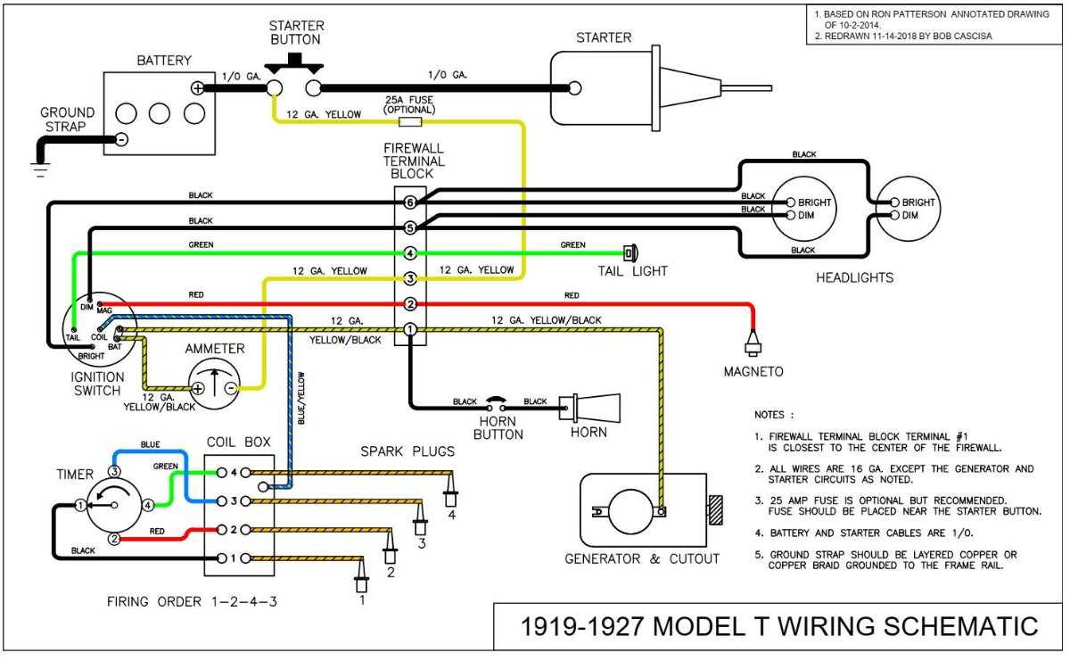

There's more going on in the Model T ignition switch assembly than Dim-Off-Bright and Magneto-Off-Battery.
For example, how does the cutout get wired through? Does it require a pigtail be made of the ammeter+ wire for the battery ignition, bright, dim and taillight?

Post by JamesD » Sat Aug 07, 2021 11:45 pm
Yes, one SPDT switch for the ignition. Center terminal is the coil box, one side is mag and the other bat. The light switch is functionally the same except it has two sides, so there's a battery wire from the ammeter connection to the center terminal of one switch and and a jumper from there to the other side center terminal. One side of the switch is Dim/bright, and the other side of the switch is connected to the tail light on both terminals. My lights were sketchy with the original switch too, I had to wiggle the switch just so to get the tail lights to come on. Now it all works.

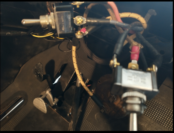

Thanks a ton. I think this is going to be a great stopgap until I get my switch repaired.

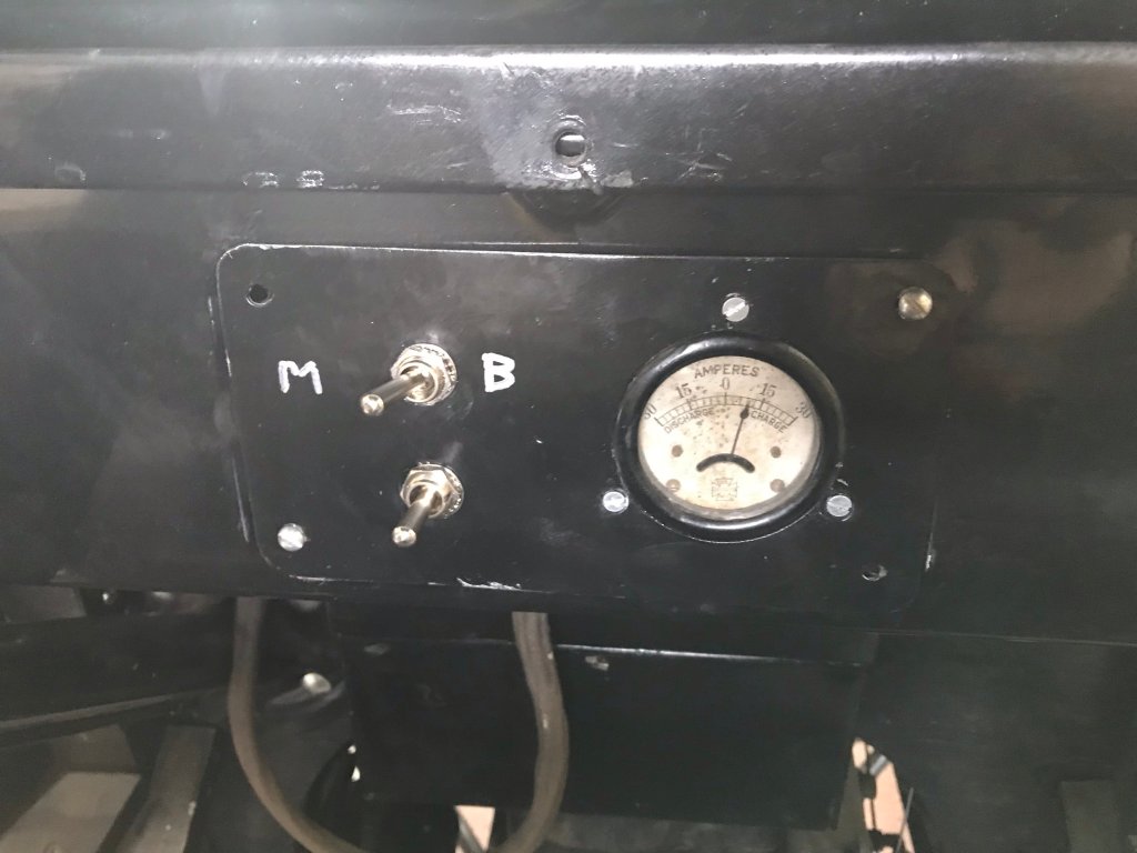

I've got it mostly wired up (except tail light) and I'm having as bit of an issue. Light work better than ever, car actually fired over on mag hand cranking (which surprised me, but then again I never tried before) but I can't get the coils to buzz on battery. Maybe I've got it wired wrong . . .
The switch on the left (ignition) has the coil wire in the center input, mag wire on one side, ammeter+, cutout wire from terminal 1 of the firewall terminal block and jumper to the center terminal of the switch on the right (light switch).
Thoughts?

Re: magneto quit
Post by paddy1998 » Thu Aug 12, 2021 2:22 pm
Scott_Conger wrote:
Thu Aug 12, 2021 2:05 pm
Andre
I think you've started a trend...!
Got a nifty switch plate going too. Just gotta figure out how to get the battery to fire the coils. :D

Post by JamesD » Thu Aug 12, 2021 8:39 pm
Should be pretty simple to follow the power. Is there 6V at the switch? If not there's an issue with your wiring. Do you have 6V at the coil box terminal when you flip the switch opposite to "Mag"? Have you checked the continuity of the switch. one way should connect the left terminal with the center, the other way should connect the right terminal to the center. There should be no continuity between the outer terminals to each other.
Yeah, this was a case of me being an idiot.
Turns out that it wasn't magically firing over on my weak magneto; it was firing over on battery. For some reason I assumed that flipping the switch TOWARDS the battery terminal meant that I was switching on battery. A few minutes with the Fluke testing each switch brought me to the realization that the switch connects the opposite side; flipping the switch left connects the right terminal. Which I suppose is obvious to people that know what they're doing.
On a side note, when I rewired and rebuilt my 71 Triumph Spitfire dash I moved the turn signal stalk off the column and replaced it with a SPDT toggle on the dash. When I wired it up and tested it I noticed that flipping the switch left activated the right turn signal and vice-versa.
I solved that problem by loosening the switch bezel and just flipping the switch over. 8-)
After doing all that you'd think I would've learned something. But apparently not. :lol:
