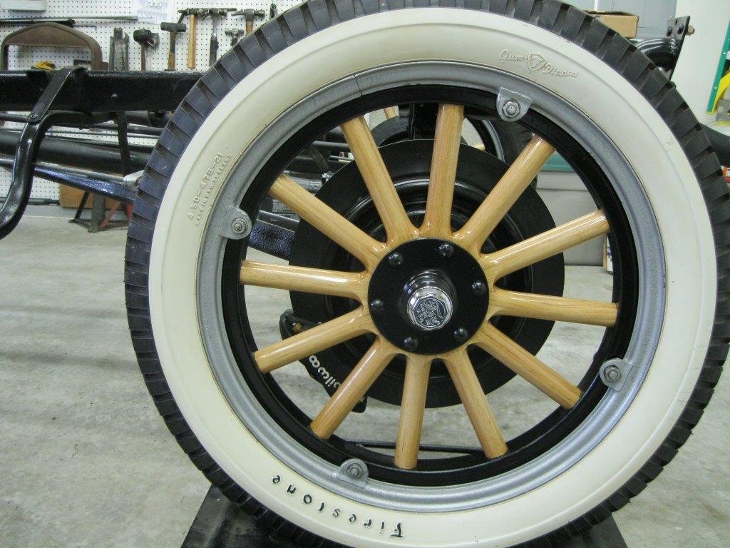

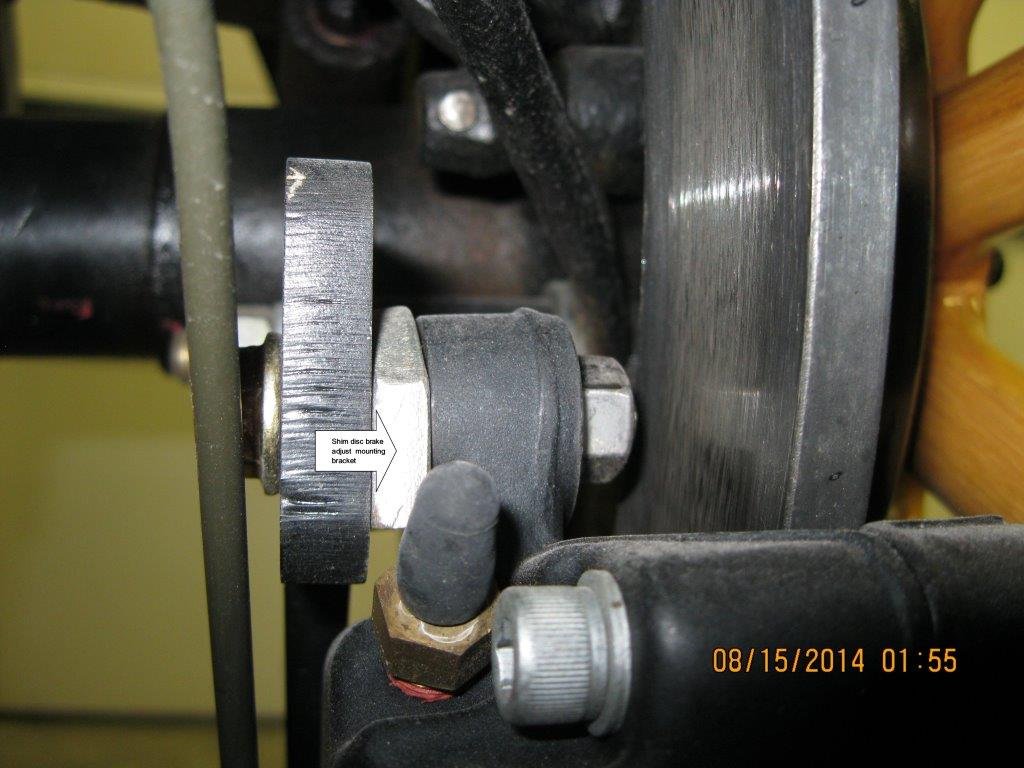

My kit fits a 26 T small drum wood wheels (Ruckstell) from Bill Tharp, Colorado disk brakes which became Texas T disk brakes or Sure Stop disk brakes.
Art
