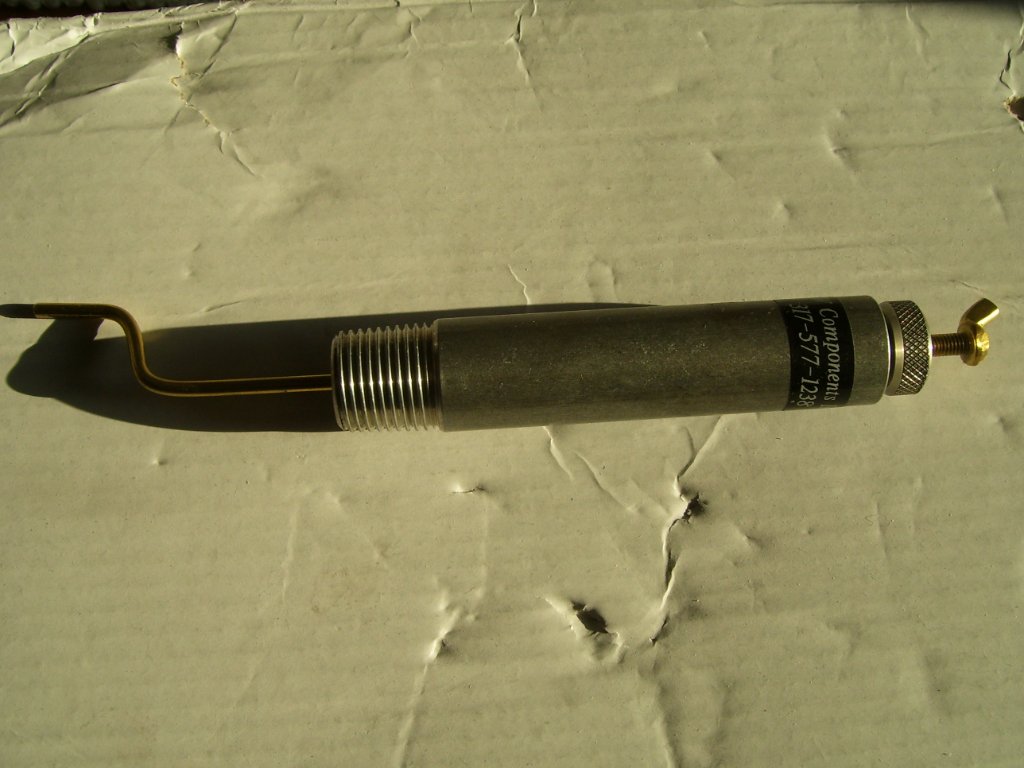

Next step was to find TDC. We kept cranking too far around so we pulled out my nifty TW components Accurate Timing Indicator
It made life easier and also measures degrees past TDC. Turns out my pulley also had a seam when the engine was at TDC, so everything was being double checked as we did the installation.

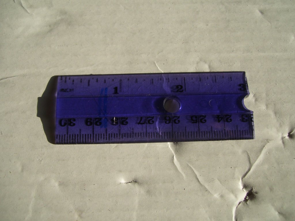

The roller (Vane Actuator Assembly) is installed first. To measure and make sure it was installed correctly I borrowed a plastic ruler from my kids.
I cut it so I had a 3 inch ruler. I wonder if they will want it back. The vane actuator fit well, so now to the timer. It fit well, also. That was expected.

The #1 spark plug should fire at 15 degrees past TDC. We measured it with the timing indicator, the seam in the pulley, and the pin holding the pulley on the crankshaft. Once we were satisfied it was correct, it was time to start the car.
