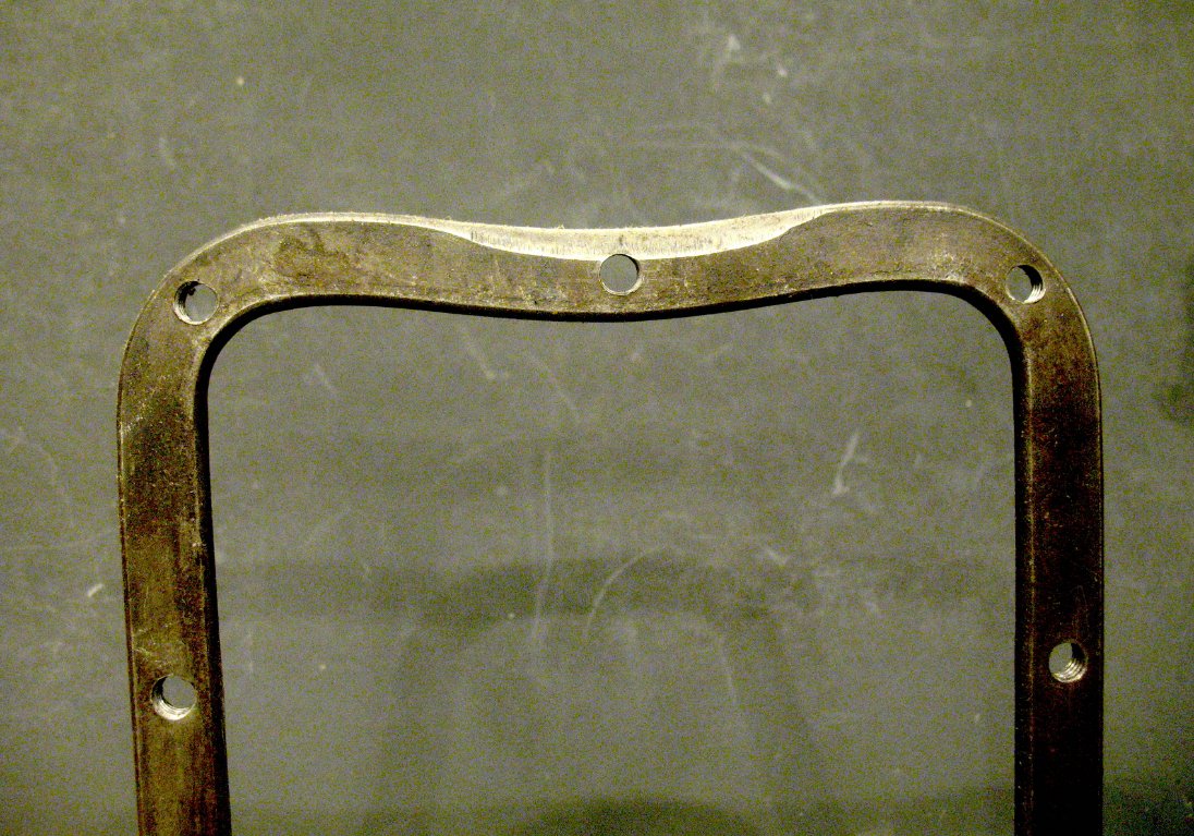

I have a Scat in a 13 engine. I had to make the area around the front bolt hole a little thinner, along with the bolt.
