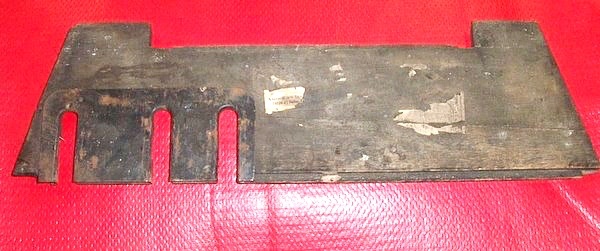

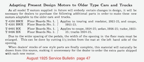

But Ford knew that owners of older cars with the older engine would need parts to install that new Improved motor, in Aug of 1925.
Ford offered to dealers new floorboards with the wider pedal space to fit into the earlier bodies.
Replacemtent boards for Improved motor .jpeg (78.01 KiB) Viewed 2841 times
25 earlier board for Improved motor.JPG (73.02 KiB) Viewed 2841 times
