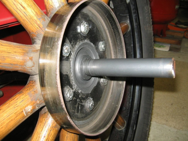

Cleveland area (Bumps -N- Grinds chapter) had a picnic at my home yesterday and went on a short 25 mile tour thru Cleveland area Metro Park . When we pulled into my driveway I heard a loud snap. No forward,no reverse, no brakes !!!!! Look at what I found. my guardian angel was with me. I will never put that car on the road again until I put on accessory brakes ! What was more scary was I had my buddy’s 8 yr old grandson in the front seat.

While I agree you need accy brakes, how will they help with a broken axle? You are lucky it stayed in the housing. Go buy a lotto ticket ASAP. You have Lady Luck with you. Dan

I believe that the RM and Bennet (don't have AC brakes so don't know) mounting on the backing plate would hold the brakes and lining in close and not make any difference as that axle and brake drum shifted laterally. An equalizer would have put all the tension on the bad side and the other brake wouldn't work either. You were lucky!

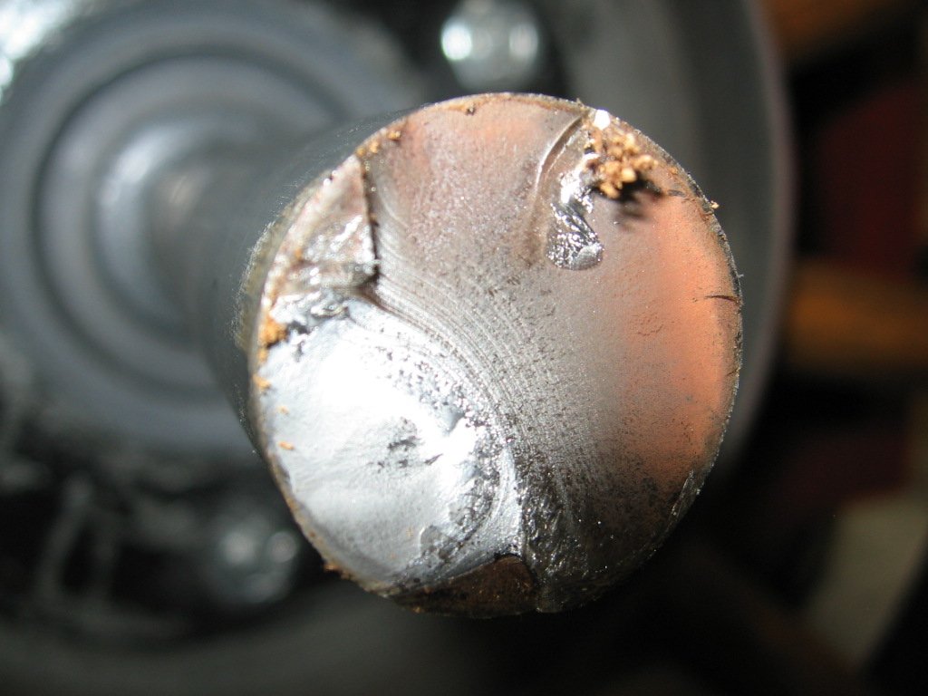

I had this exact thing happen on my 1924 and the AC brakes did indeed bring the car to a stop. Like you, I lucked out and the wheel did not come off. My axle shaft broke at the exact location that the metal "fingers" of the Ford style inner axle seal rubbed on the axle shaft.

All depends on where the break is. Most are outside the outside bearings. Wheel goes off down the road. That is why you see some many backing plates with a flat spot on the bottom.

The axle broke on the differential side of the Hyatt bearing? Is this common? The stress is on the wheel side of the Hyatt.

My SWAG is leather spring washers just inboard of the bearing. I’m sure Tim will let us know when he gets into it. Next to Babbitt thrust washers, the worst thing that can be in an axle.
