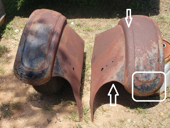

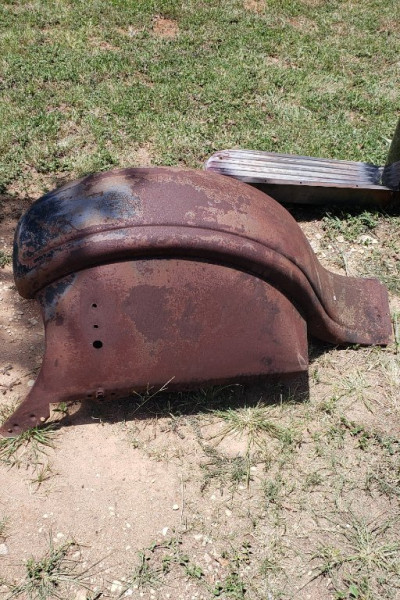

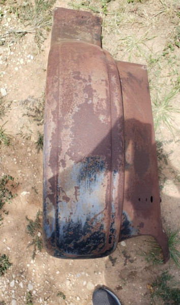

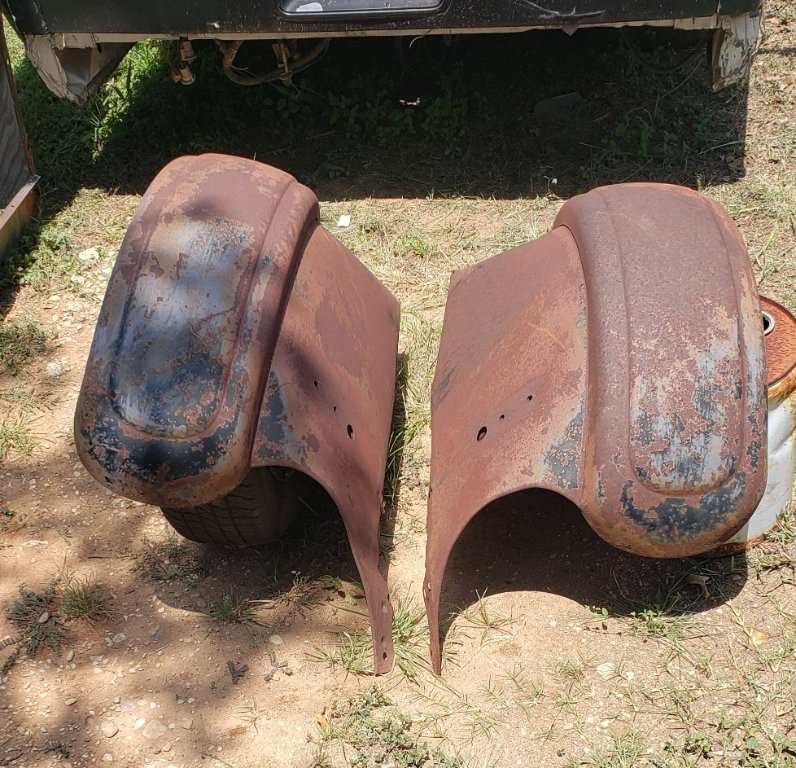

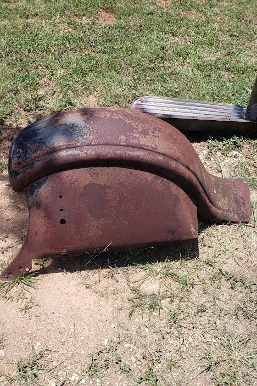

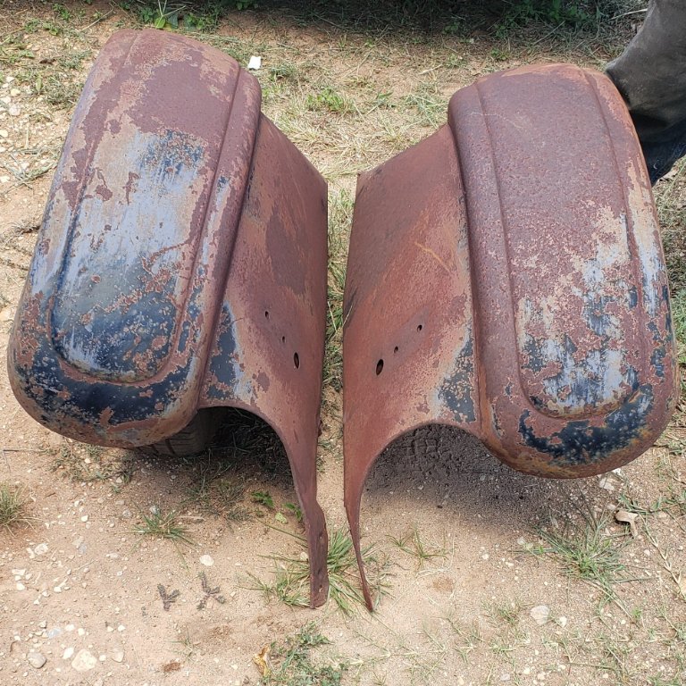

A friend of mine up in Fredericksburg has these two front fenders but does not know what model car they belong to. Looks like late twenties something. Can anyone help identify them. They are in solid shape and even have some original paint left.[/size][/b]

They are not T fenders. possibly Chevrolet or Dodge?

Studebaker

I think Dan H is right! Years ago, I had a 1925/'26 Studebaker standard model, and the front fenders looked very much like that. You may need to check years and models a bit more? They may also fit 1927. I don't know about the other models.

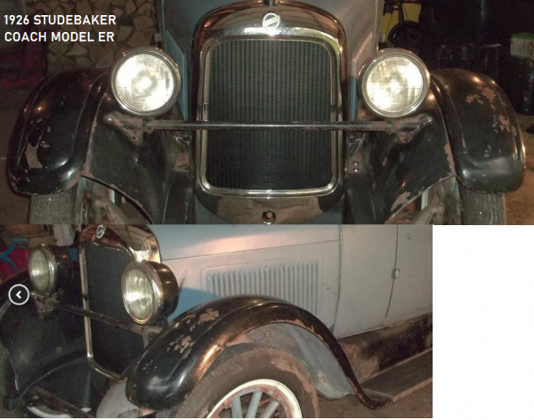

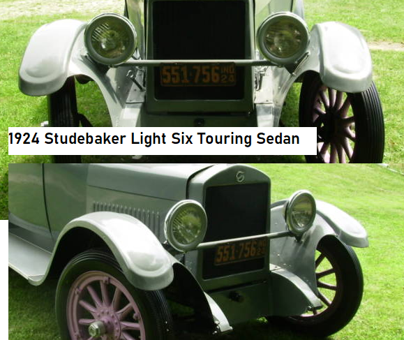

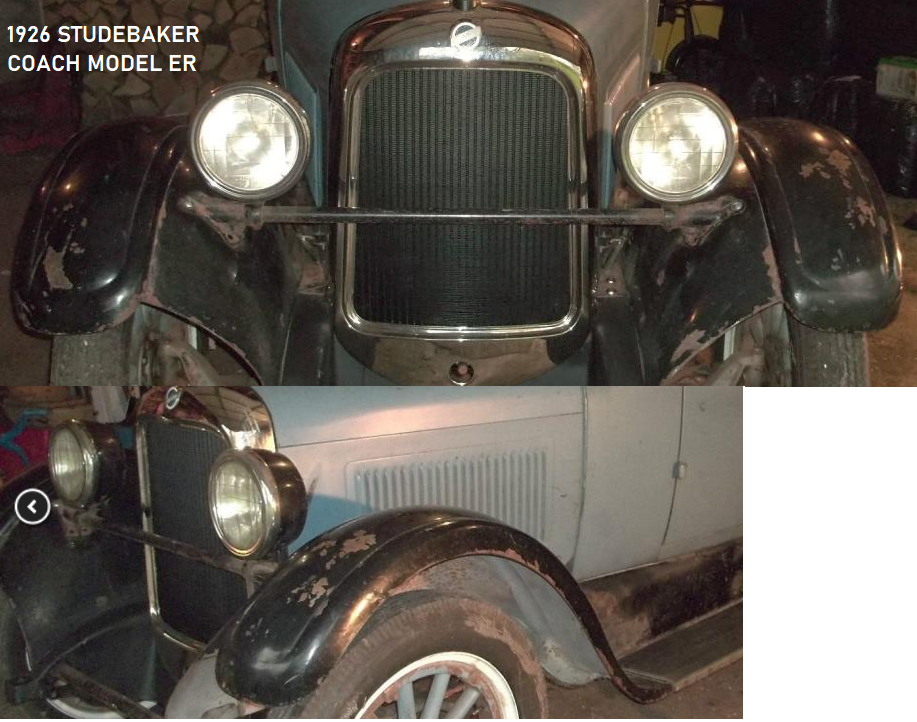

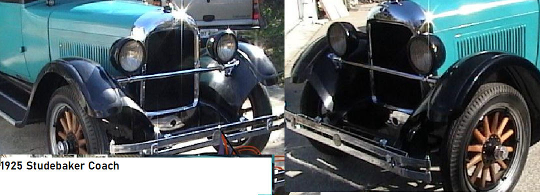

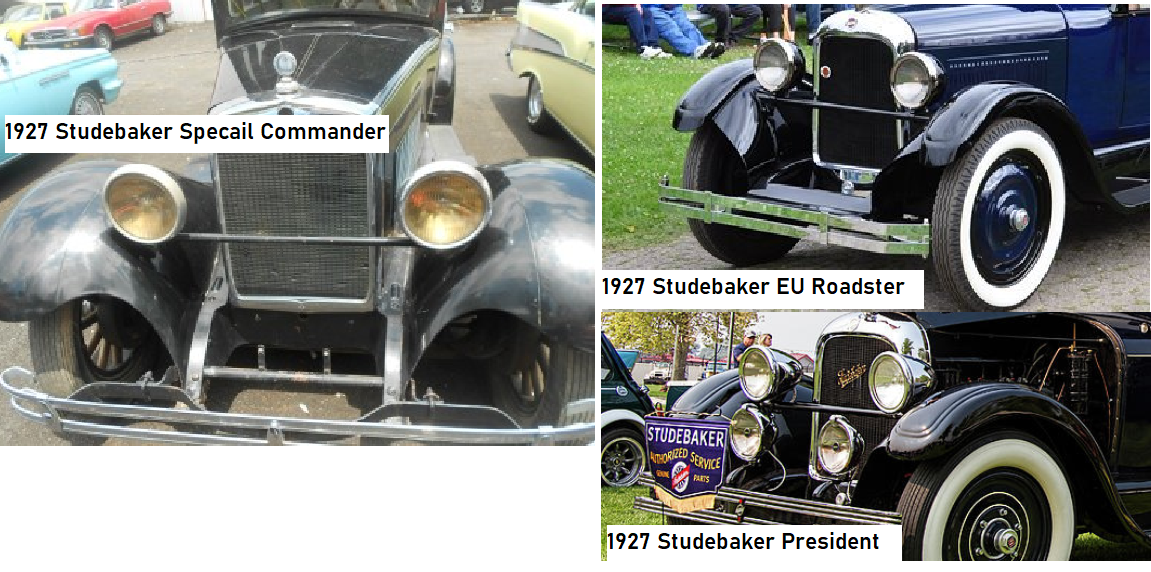

Some pics for comparison -
1926 https://car-from-uk.com/sale.php?id=105550
1925 https://car-from-uk.com/sale.php?id=12248
1924 https://studebaker-info.org/Archive/Car ... 0708a.html
1923 looks the same https://www.macsmotorcitygarage.com/gre ... an-warren/ 1927 https://www.google.com/search?q=1927+St ... 0k4fpaT-fM

The OP fenders in general look an awful lot like the front fenders on my 1927 Paige 6-45 ! However, the areas that bolt to the car's frame are TOTALLY different.
If I found another Paige 6-45 that was missing the fenders, I think some minor alteration would make them fit and work fine and look so close to right that even parked next to a proper Paige 6-45 and not be noticed.

1924 Buick.
