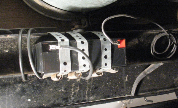

Taylor, on my 1912 van I have a 12 amp motorcycle battery mounted in a separate compartment next to the fuel tank under the front seat. It has been that way for 27 years, and I am on my third battery. It powers the ignition system and indicators and brake lights, works for two days of city driving, and is kept charged in the garage at the end of each day.
If you want to run headlights for any length of time, you may need a larger battery, or LED headlight globes. The ultimate solution may be an Optima battery, on its side, under the back seat. That will even power a starter if you go that route.

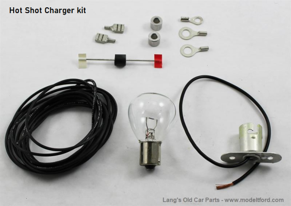

Jim - I wanted to clarify what you said about sticking with magneto. So if I do run off coils then you are suggesting I install the battery holder under the rear seats and buy a hot shot kit such as:
https://www.modeltford.com/item/HOT-SHOT-C.aspx
Is there anything else I would need?? Would this be enough to run my headlights? Also is there a coil rebuilder anyone would recommend? I've seen the coil testers and would love to own one but they are so pricey - does anyone have a strong opinion about owning a tester vs not?

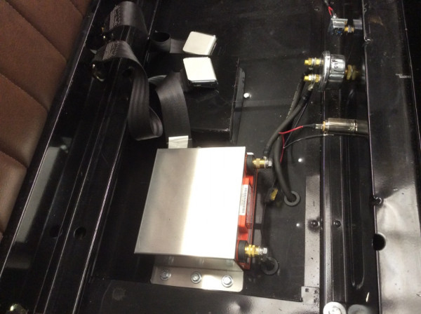

Getting a T to run on a battery does not require a group 1 automotive battery under the floorboards. Other suggestions for a MUCH smaller battery which can easily fit under the seat or elsewhere will work fine and definitely aid in starting.
4 rebuilt coils, a good or rebuilt carb and clean fuel tank and possibly a new timer and wiring loom combined with good intake seals will very likely have the car running on battery. From there you can investigate if the magneto works. If it does, then you're in business and can plan on using a small battery to aid starting and then run on MAG.

I would actually try starting the engine before doing any type of modifications and spending a lot of time and money.
You can get a six volt lantern battery at the hardware store. That's enough to get the coils buzzing to start it on BAT. Then, switch over to MAG and see if it runs.

As far as non-starter/generator Model T Fords are concerned: many folks have a small battery under the front seat just like folks did 100 years ago. They used dry-cells/hot shot batteries (my dad was still using them in the 1950s, 60s and 70s). Today, folks like me use small rechargeable 6 volt lead acid gel cell batteries. Mine is from a Fisher-Price Power Wheels ride-on toy. My brother used to work for FAO Schwartz and he gave me a few for free many years ago. They last many years and charge using a small transformer.

Without having to turn a starter motor, your 1916 doesn't need a full sized automotive battery. A smaller one that fits under the back seat will be quite adequate. My 1915 runabout has no back seat, so my little battery is mounted in the frame rail. I've added a little charger powered by the magneto. http://dauntlessgeezer.com/DG102.html

Post by TRDxB2 » Wed Aug 11, 2021 6:34 pm
Here's the setup
by Steve Jelf » Tue Apr 13, 2021 12:15 pm
I use a small six volt battery strapped in the frame rail of my 1915 mostly to buzz the coils for starting. I use the stock mag headlights, but run tail lights off the battery which is charged by the magneto with a home made charger using John Regan's design. I've added a converter for 12 volts to charge my phone and Garmin. I plan to install LED turn signals, using the side lamps in front and a pair of T-era-looking tail lights in back. Maybe I'll even get fancy and add a brake light.
Hi-Tech kit available to charge the battery from the magneto
