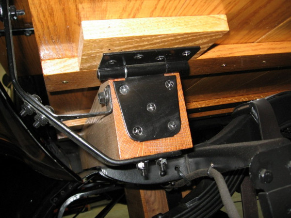

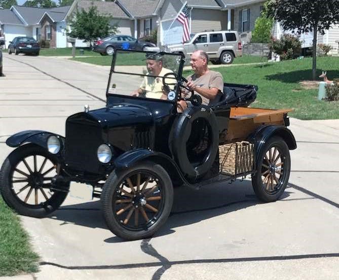

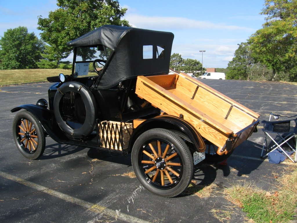

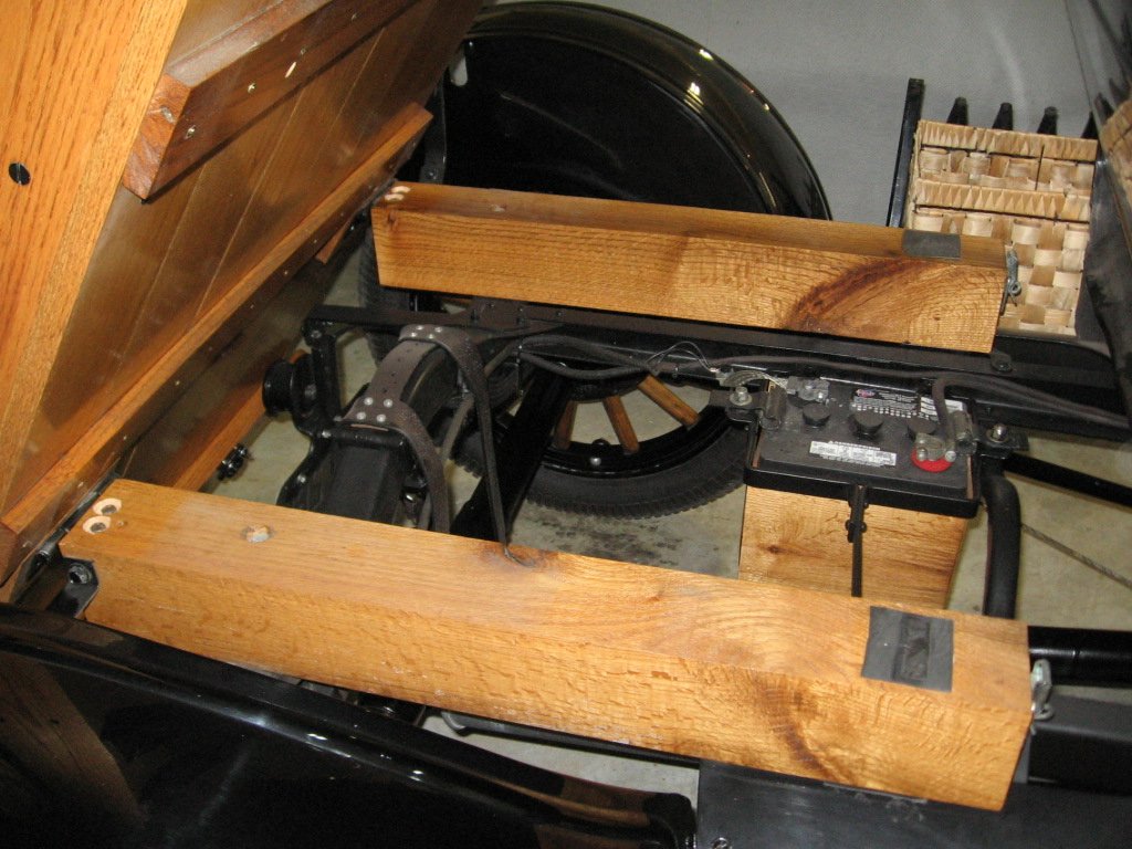

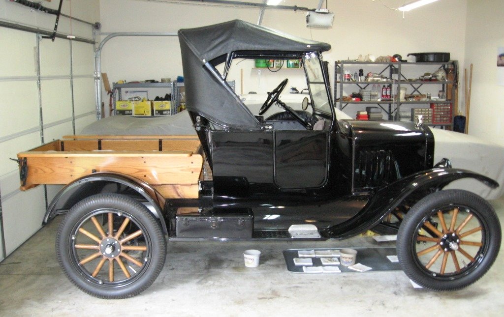

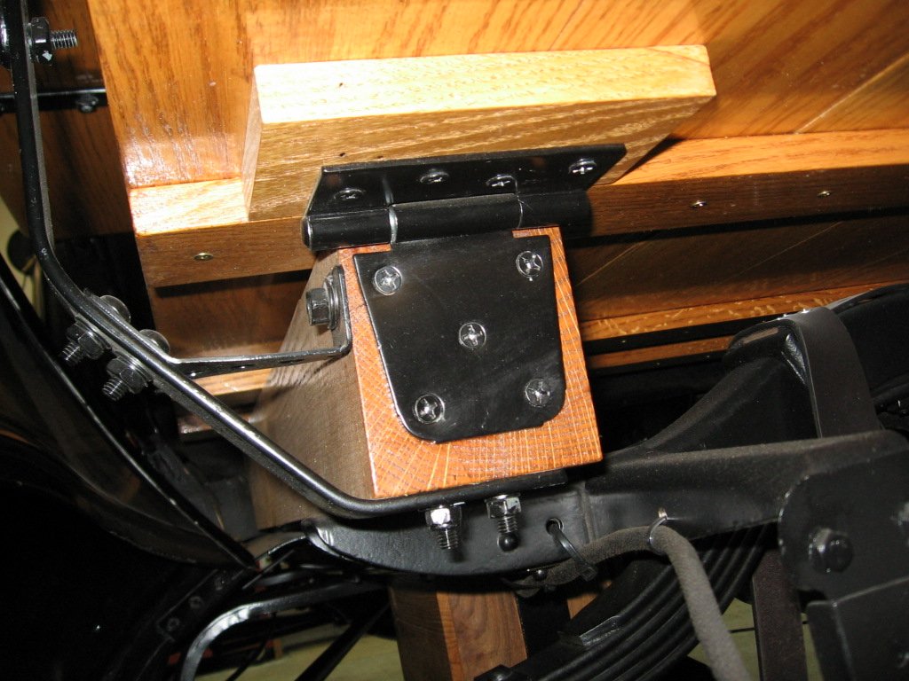

Here is my 1924. I can't take much credit, I bought it this way for the most part. I did install the upholstery, top, spare tire, and basket. I broke an axle shaft on the stock rear end, so I replaced it with a Ruckstell two-speed rear axle. The tilt bed sure makes battery access easy.
The rear fenders are supported by custom brackets to allow the bed to tilt, but I think that roadster rear fender irons, attached to the 4 x 4 bed support rails, would also work. :)

Very nice.

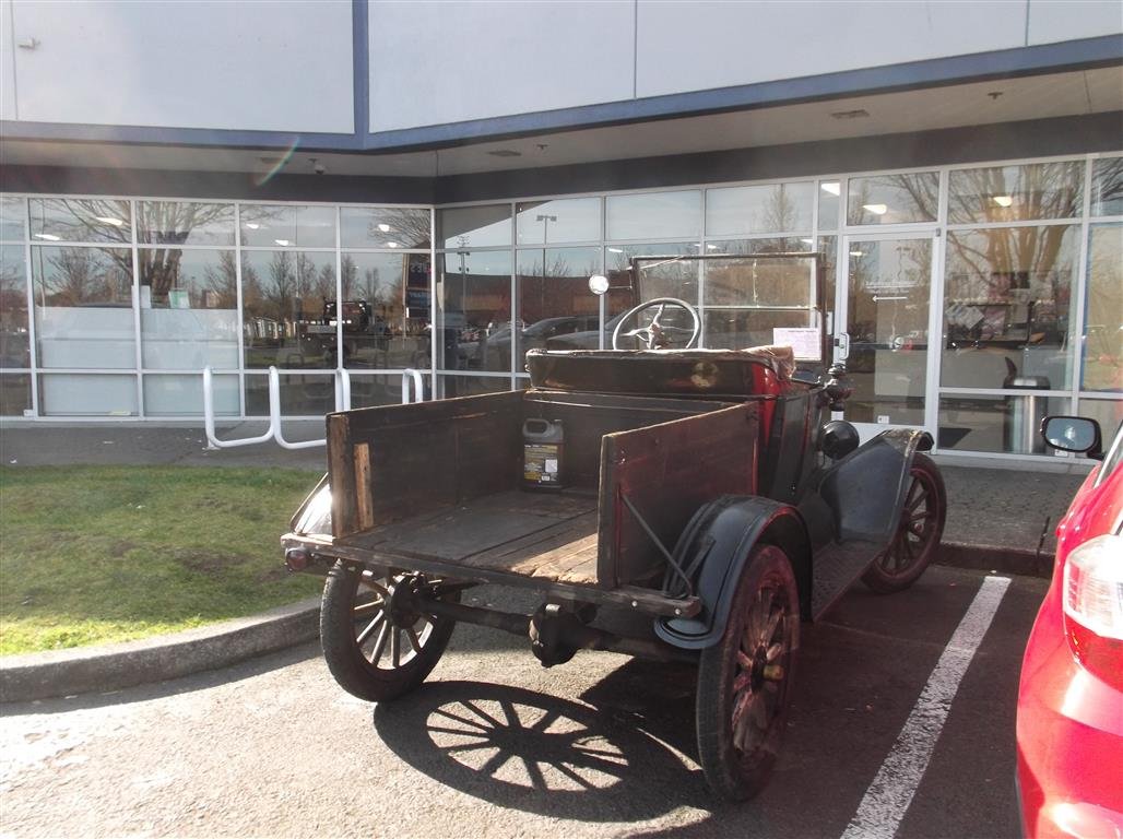

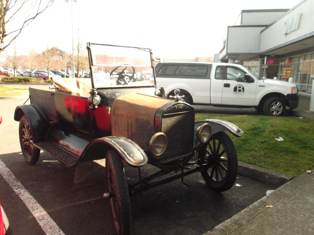

My 1925 cut down
