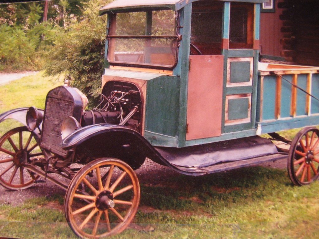

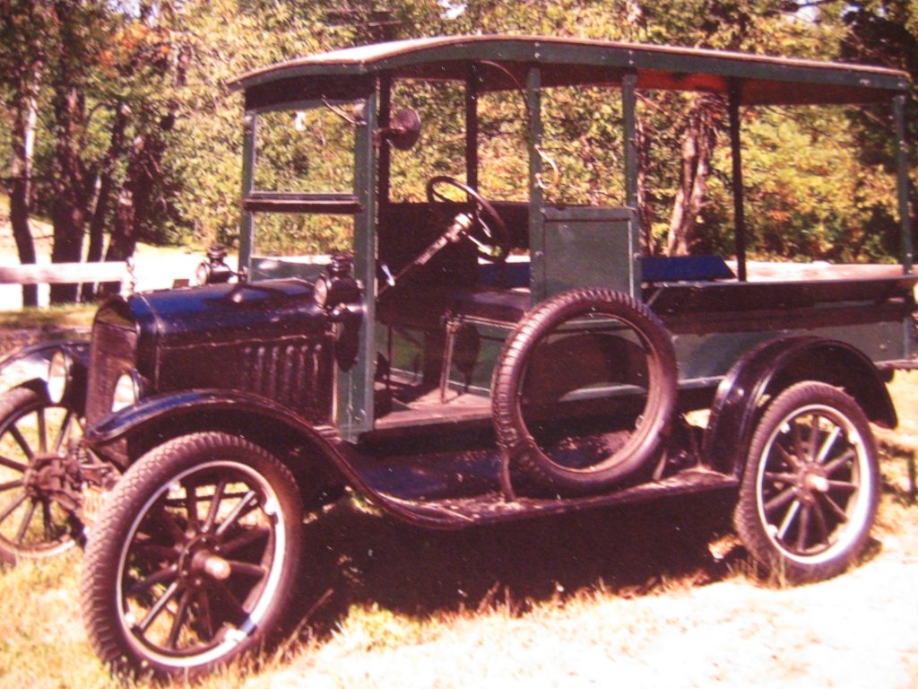

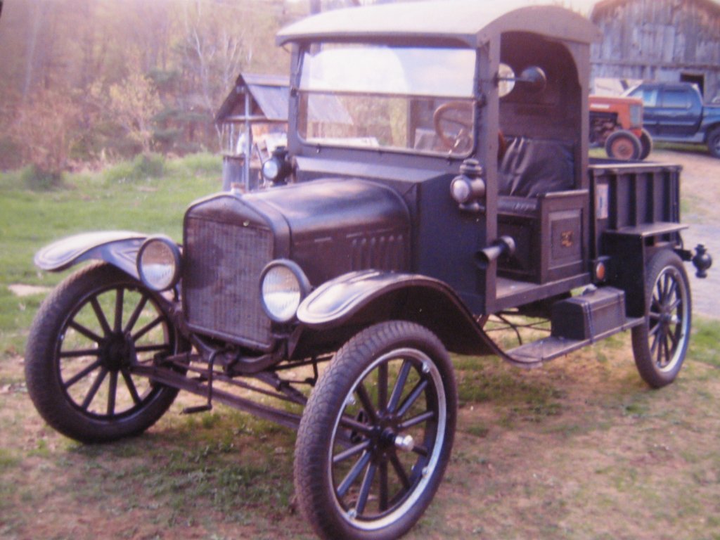

NOT SURE OF ITS YEAR- IM LOOKING AT IT THROUGH PICTURES, I KNOW IT A CHEVROLET BECAUSE WE HAD A DOODLBUG WITH 27 CHEV, ENGINE IN IT, THIS ENGINE IS THE SAME TYPE, I'M THINKING OF THE HEAD, I UNDERSTAND FOLKS USE THEM TO MAKE A OVER HEAD VALVE SYSTEM'S ON THE MODEL T.WITH THE CHEVY HEAD, WOULD IT BE WORTH MY WHILE TO GO AFTER THIS ENGINE, ALSO IS THE CRANK A USEFUL ITEM TOO, THE BLOCK I'M SURE I COULD FIND IT A HOME, I WOULD LIKE TO SAVE AS MUCH OF THIS OLD STUFF AS ITS BECOMING SCARCE, I SHED A TEAR WHEN I HEAR OH I SCRAPED IT--BOTTOM T SETTING AT DON LANGS--MIDDLE IS TRAGUTHA AS FOUND--TOP IN HER NEW DRESS, DONTCHA JUST LOVE THEM T''S.THANKS FOR ANY ADVICE--

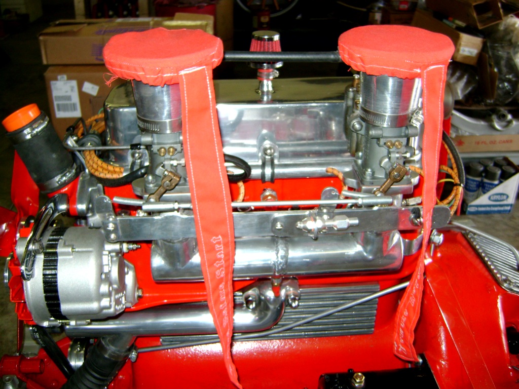

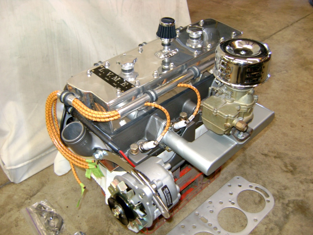

For those wanting pictures of a three port Olds head. They do produce just a little more but not what you would think. To get extra you must do a fly off of the rocker bosses and install a new plate with different ratio rocker arms. Now you have wheel barking power!

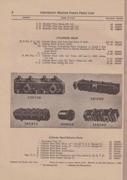

Not sure of rarity of the Olds head or cracks but I have a 3 port Chevy head and was told it was the same as an Olds head but with a bowtie casting mark, I’ve never had it sitting next to an Olds head so I can’t verify if they’re the same. The 1922 Chevy Master Parts Price List show the 3 port head in it. Not sure if the 3 port was offered in other years besides “22”.

I am very sure that the Chevrolet "T" was the truck, so wonder if in 1922 they tried that head to get a little more out of the engine, and the FB was a larger car, the follow-up to the to V8; https://en.wikipedia.org/wiki/Chevrolet_Series_FB So not as common as the 490.

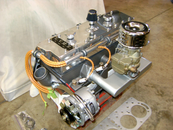

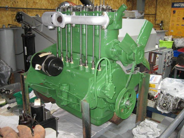

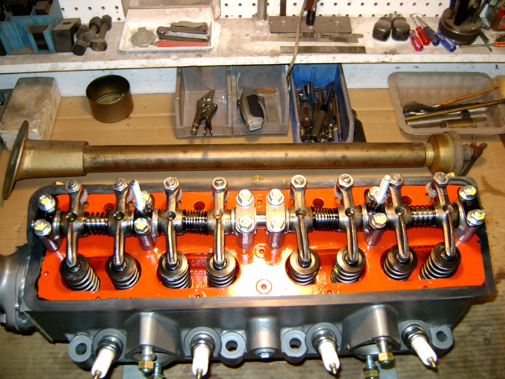

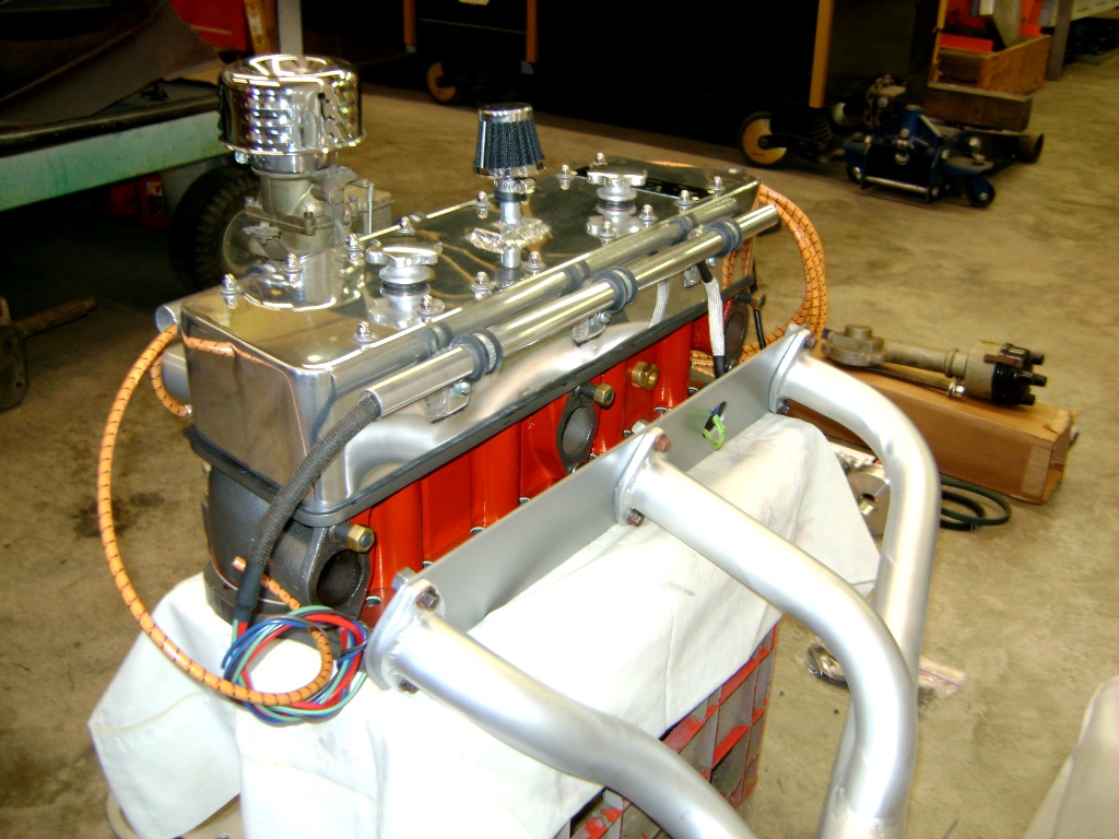

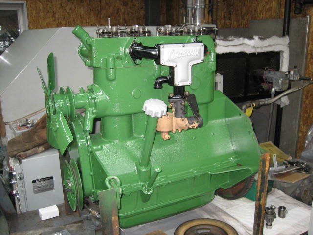

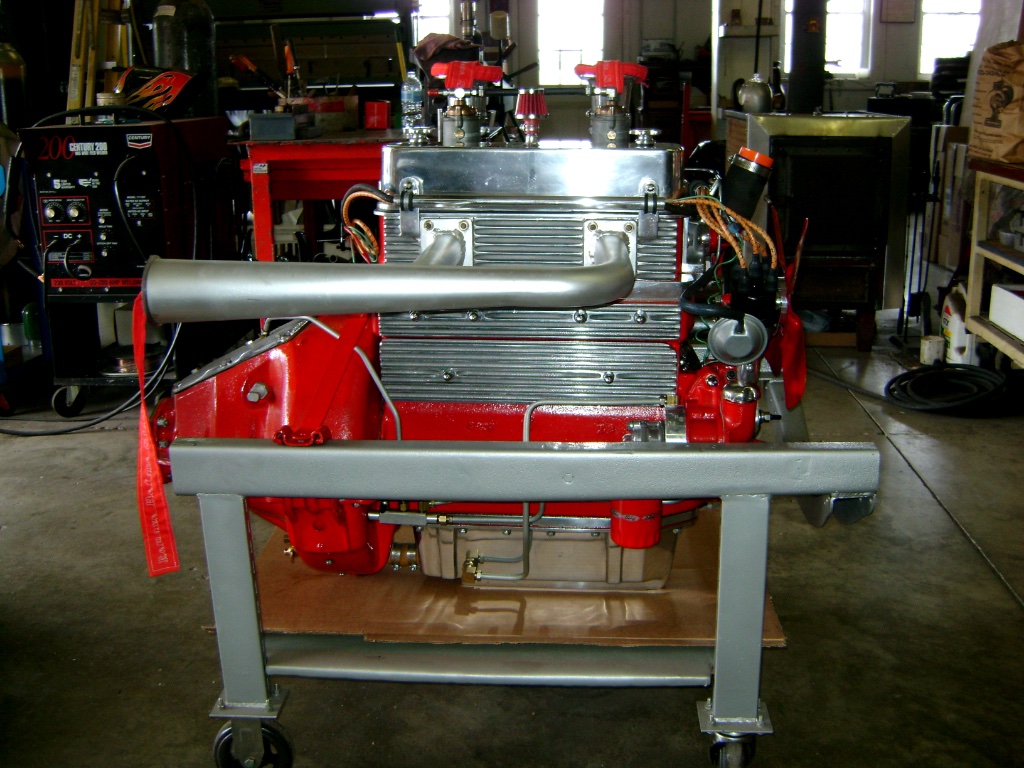

This is what the engine looks like. We just completed.

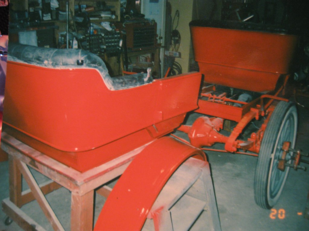

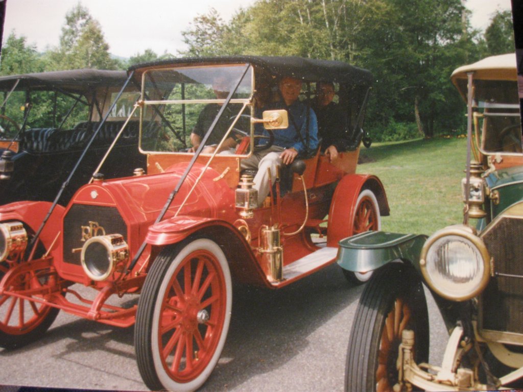

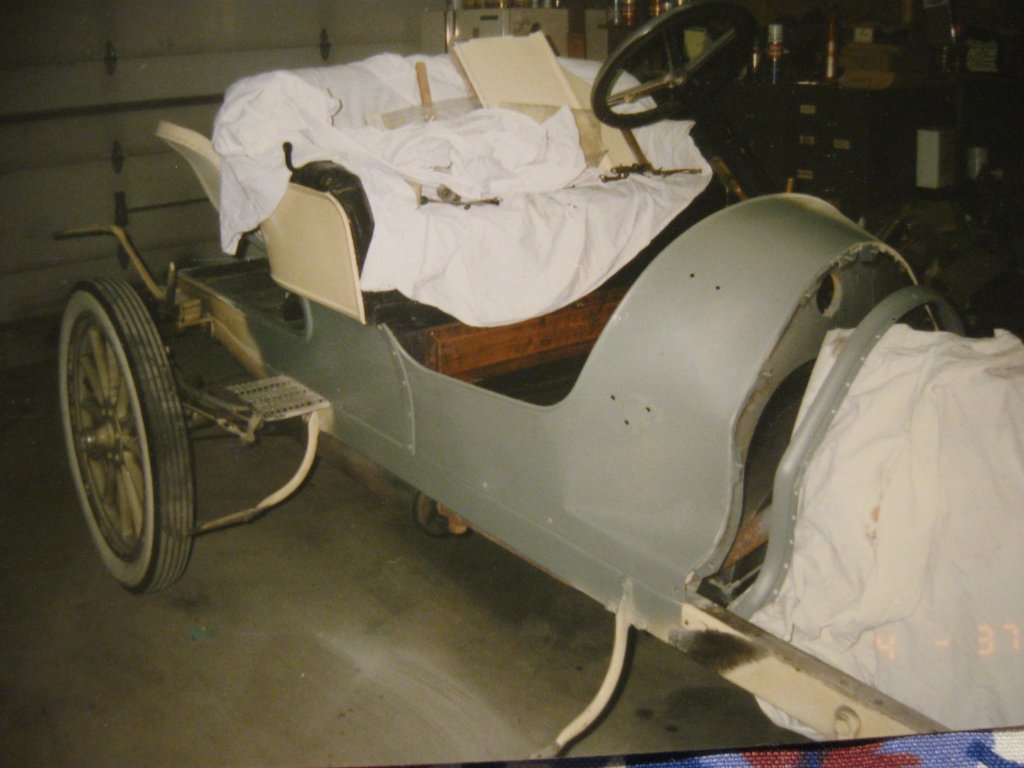

its truly astonishing the amount of early information that's still out there, each faze of automotive advancement through the years is someones favorite subject, and every one is thirsting to gather all one can to to further there knowledge on this subject- there is something about being able to take a object that was made one way take it apart add other parts to it and make it do its job in a better way, i look at those [in my eyes] beautiful engines that has taken many hours and thought to perfection, we that love this hobby look at each others work and understand what it took to achieve our goal, thank you all, to be able to set in my chair hit some buttons and see what others are doing in this hobby and to be able to talk with those people through this wonderful model t forum is truly a treat. the one engine i
improved was a 1910 REO, this four banger is a crude little thing, between the top of the piston and the head there was room to set up house keeping, so while i had it apart i had Jans build me a set of jugs changing the C-D[ compression distance] of the wrist pin giving it much higher compression, wow that woke this little tiger up good--then i found after a speed run when some joker did what truckers call a brake test in front of me and with some quick flailing, i was able to avoid what would have been a very bad wreck, this REO- had two wheel brakes,and not very effective at best--with both feet on that pedal there was no black marks on the road,it was all done with the steering wheel--and thank bozza- there was a exit to right with nothing in the way in to the field, i have a video of this engine work my friend wally took of the rebuild,its on a v-c-r- and when i can figure out how to take get some interesting parts to show ,i will. thank you all for sharing you information and work,s very enjoyable..
