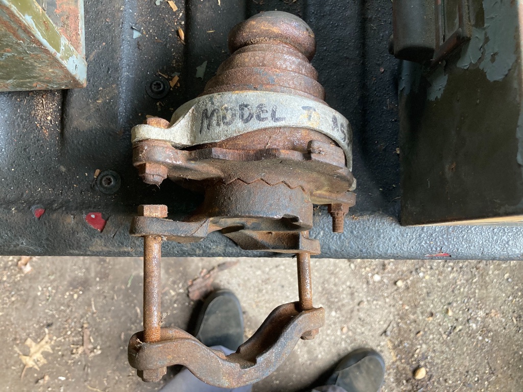

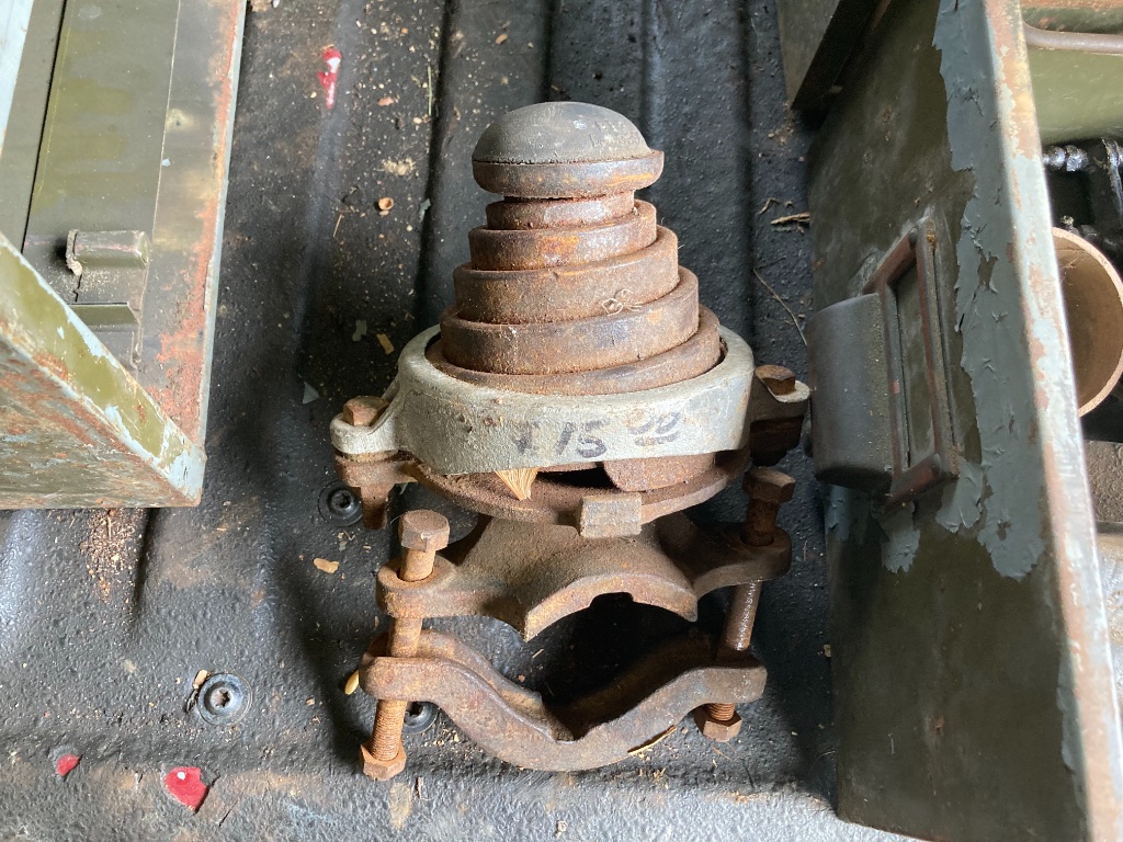

Dad has Model T accessory on it.
My guess is a helper spring or travel stop of some sort.

Rebound spring/bumper. Fits on front axle under the crossmember.

What is the purpose of the teeth and being able to rotate the top half ?

Looks like overload springs designed to be adjusted according to which way your junk was worn out? Really have no clue what the teeth are about.

Mark sounds pretty sure. BUT, I’d like to see it clamped on the front axle somehow first. I’m not seeing it.

WAG - rotating the gizmo's "teeth" adjusted the coil spring tension ???

I would guess that it is an early type of "helper spring" attached to a truck or car axle just under the frame so when someone was hauling a heavy load it would assist the springs in supporting the extra weight.

I’m with Jerry on this one. I love mysteries and this one was in my dreams last night trying to figure it out. iF the bolts were longer, would the castings sit in the top and bottom of the differential housing? The grooves could seat on the ridge of the casting? Why make it rotate? I dunno. If an overload gizmo at that point, the rubber pad would hit the spring center bolt, not so good. You can check that and get back. There are only so many places on Lizzie to mount a gizmo like that. Dave H, with that intricate mechanism, there is a good chance of some makers marks, numbers, patent data cast or stamped somewhere on it. Ms. Janet Block would love to find the patent info for it. Maybe dad was just screwing with us, having* a good laugh right now.

Ok, my new guess is a Body Budy ( thanks dave ! ). I could see this on a vehicle placed one one side of an axle ,adjustable to have the rubber bumper directly under the spring. The grooves would allow placement over hydraulic lines top or bottom of the axle. An overload condition would then keep the spring from being overloaded. If you find the mate, I’ll up my offer to $30 for my E-pup. I’d feel better about abusing the payload. Perhaps Dad was right, but meant Diamond T. Still just a guess , though.

Yes, it says Body BUDY Co on the clamp.
It does seem to fit the driveshaft spool.
It would hit the floor pan underneath the rear seat.
I don’t think it would fit between the spring and the axle tube Tim.
Definitely no room for it on the front either.
