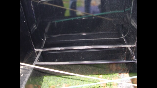

help can someone show me a picture of what the support for my truck seat should be. i have the original springs, but all there is to support the springs is the netal frame around the front, but at the back there is just a 1 inch thick by 4 inch wide board that is attached to the cab with 2 hindges.

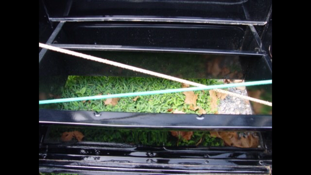

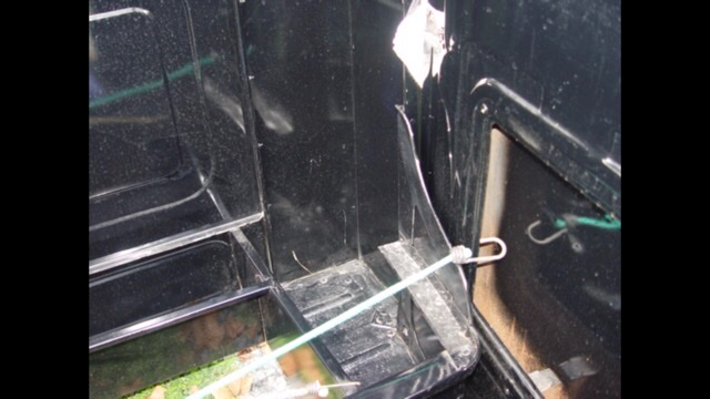

Is it a closed cab or C cab? Here’s what the closed cab seat frame looks like.
Brad

great picture thanks
