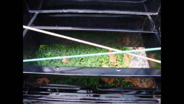

Is it a closed cab or C cab? Here’s what the closed cab seat frame looks like.
Brad
Brad

Re: 26 model tt truck seat
great picture thanks
