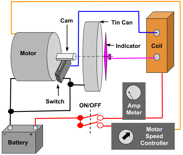

I decided to move forward. I made a MCCT!
Matt

Post by Scott_Conger » Wed May 08, 2019 10:11 am
Matt
since I don't see a magneto behind the ring, I'm not sure what I'm seeing here, but with a 1725RPM motor, that pully is WAY too small and your rotor is going WAY too fast to replicate operating conditions of a T (I sincerely hope there is not a magneto/magnets turning that fast in your shop)
In any event, elaborate, please, on what we are seeing!

Post by Matt in California » Wed May 08, 2019 11:40 am
Bob,
This is a work in progress. I am testing the theory of the dynamic part of the MCCT. I still need to add the amp meter.
Scott,
That you see is a peanut butter lid, wires, microswitch, pulley with excentric. Uhmm that is about it.
I plan to discuss theory later, but I need to go about my day job at the moment...
Matt

A bit more of the back story.
When I was a youngster, I would go way back in the under stairs closet and work on electronic projects. It was the only space that I could be alone from everyone including my two older brothers. One time I decided to prank my brother. I connected one side of a Model T coil to the door knob and the other side to a bare wire on the floor. I turned on the coil and called my brother. He came, opened the door, but nothing happened because he grabbed the porcelain on the knob. A few moments later after checking everything I called him back and... nothing. I mean he said nothing, but later told me that the shock was so strong his body convulsed and forced him to fly back on the bed. I share this story because this was my first exposure to a Model T and I would have never dreamed that I would be able to put that coil in my first Model T.
Okay, before I say anything more, I want to say that after researching the other options, and getting feedback, I can tell there are other great testers and worth the price. I understand if someone wants to do it "right" HCCT, Strobo-Spark, or ECCT with the proper understanding are all great options. But frankly, I have never personally used any of these to test coils. But as I researched things it just got my ticker moving.
I thought to my self, many Model T enthusiast like my self don't like to spend more than $20 on anything. What could I build that is so simple that anyone could build? Also, I have build/tested a lot of electronics and wanted to build something that was a lot more mechanical. Finally what could have been built 100 years ago based on the same concept. I also thought, a HCCT is nice, but too heavy. A ECCT is pure electronics to measure dwell time. (I don't know how a Strob-Spark works, perhaps my design is similar.) I concluded that I don't need magnetos to test dwell time, but I could use the concept on the HCCT to display the spark and give a understanding of dwell...
So here is how the Motor Controlled Coil Tester 0.0 works:
-A small DC motor turns a spark needle and excentric.
-The excentric turns on and off the low voltage primary wires.
-The needle is set so strait up is 0 dwell.
-For initial testing the unit is running approximately 400 RPM that would be equivalent to about 800 RPM. (It is slow, but that is how things came out with the 9 VDC power supply I am using. It could be speed up with a higher voltage.)
-400 RPM yields .15 seconds per revolution. That would mean if the first spark is at 40 degrees then it would have a 17 msec dwell time. (These are estimates based on the image that I posted and estimated 400 RPM.)
I have ideas to improve upon the MCCT 0.0. Obviously I want to add an ammeter. But my biggest issue is that I need to improve on my primitive excentric so that the 0 dweel time is more stable.
I welcome your thoughts and input.

The MCCT v0.0 just has the following parts:
-A small DC motor turns a spark needle and cam/eccentric.
-The eccentric turns on and off microswitch to the low voltage primary wires.
-Peanut butter jar lid
-power supply
-a few basic parts to hold the coil
-Ammeter
Essentially the idea is to mimic the Model T timer (switch) and the HCCT (display spark).

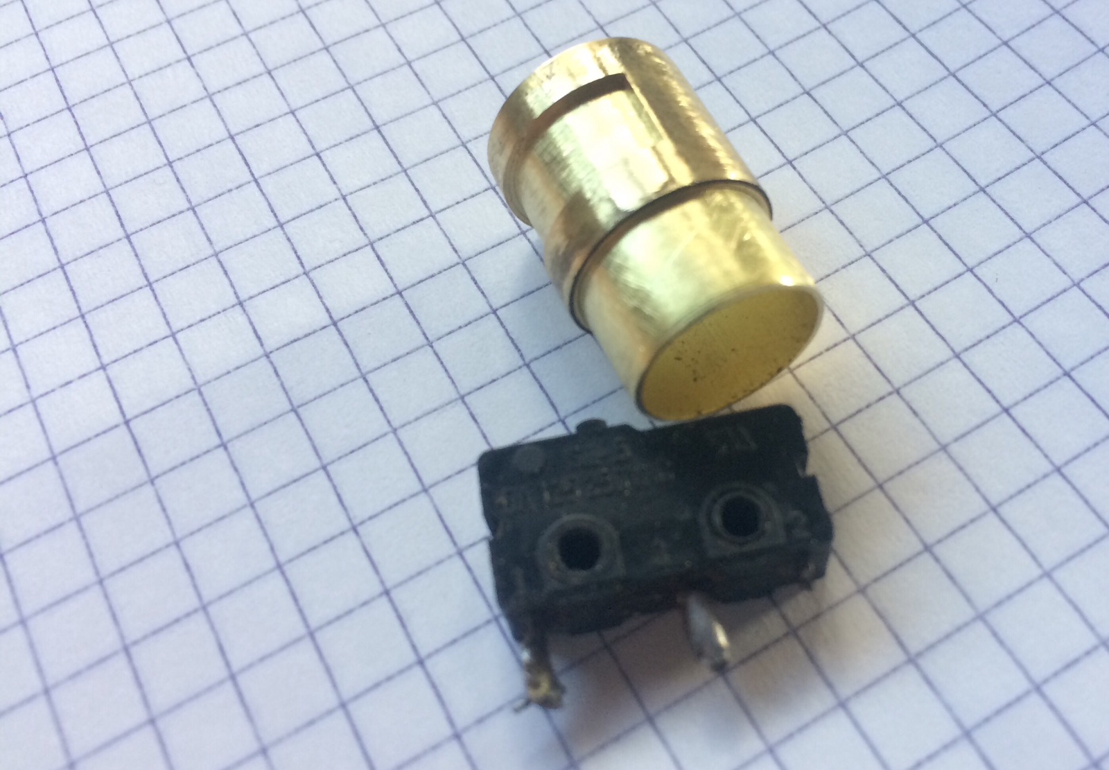

Post by Matt in California » Fri Jun 07, 2019 7:54 am
I had this DC motor with a rubber bushing to drive something.
I marked the tuna can using permanent red. (I didn’t have any Persian blue.)
Again I am using a micro switch. I used brass tubing to make the cam to activate the switch.
Tubing fitted together:
Matt in California
Posts: 823
Joined: Sun Jan 06, 2019 5:42 pm
First Name: Matt
Last Name: G
Location: California
Re: Model T coil tester advice: HCCT, Strobo-Spark, ECCT
Post by Matt in California » Fri Jun 07, 2019 8:07 am
One more progress photo with the cam assembly.

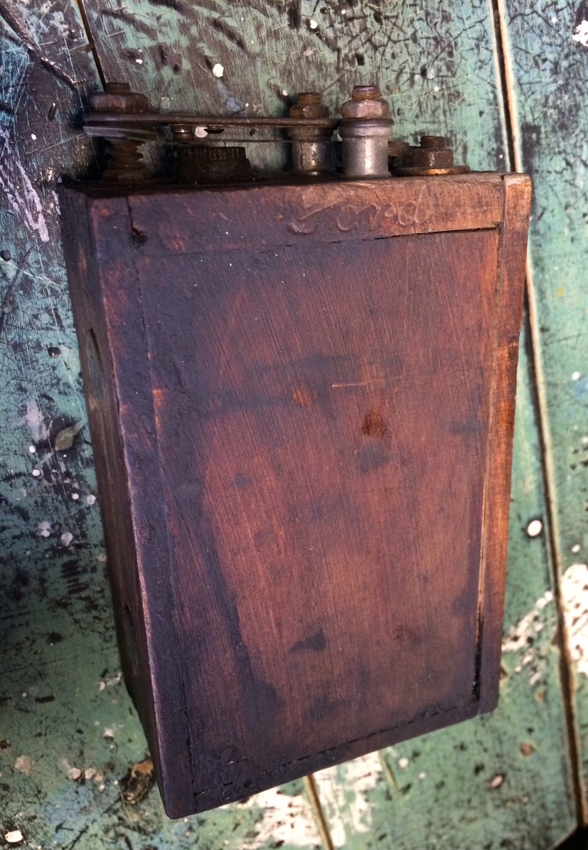

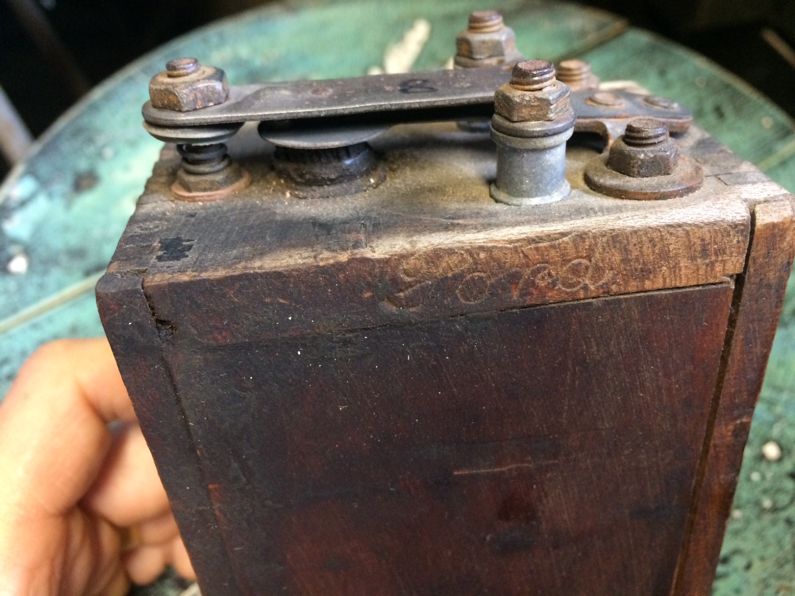

Here is the old Ford coil that was tested and declared “Needs Refinement” above.
A closer look shows that the aluminum standoffs have sunk into the wood.
There is evidence that in the past someone really hammered on the main vibrator spring.
But I think this last photo shows a bit more. The cushion screen travel looks way too large (hard to see in picture). Also the points are not lined up.
I need to get to work on this one.
Matt

I had someone recently ask about how to make a Motor Controlled Coil Tester. I though this thread outlined how to make MCCT, but realized I that I could better illustrate it. Here is the simple design used for the Motor Crank Coil Tester (MCCT):
Simply put the MCCT is a Ford coil triggered by a switch. This switch is controlled by a cam on a motor. The motor speed controller adjusts motor speed that controls the switching time to the coil very much like a commutator does on the Model T. The indicator turns and can display the spark on a scale similar to a Hand Crank Coil Tester (HCCT). Additionally an amp meter is used to display the amount of current flowing to coil.

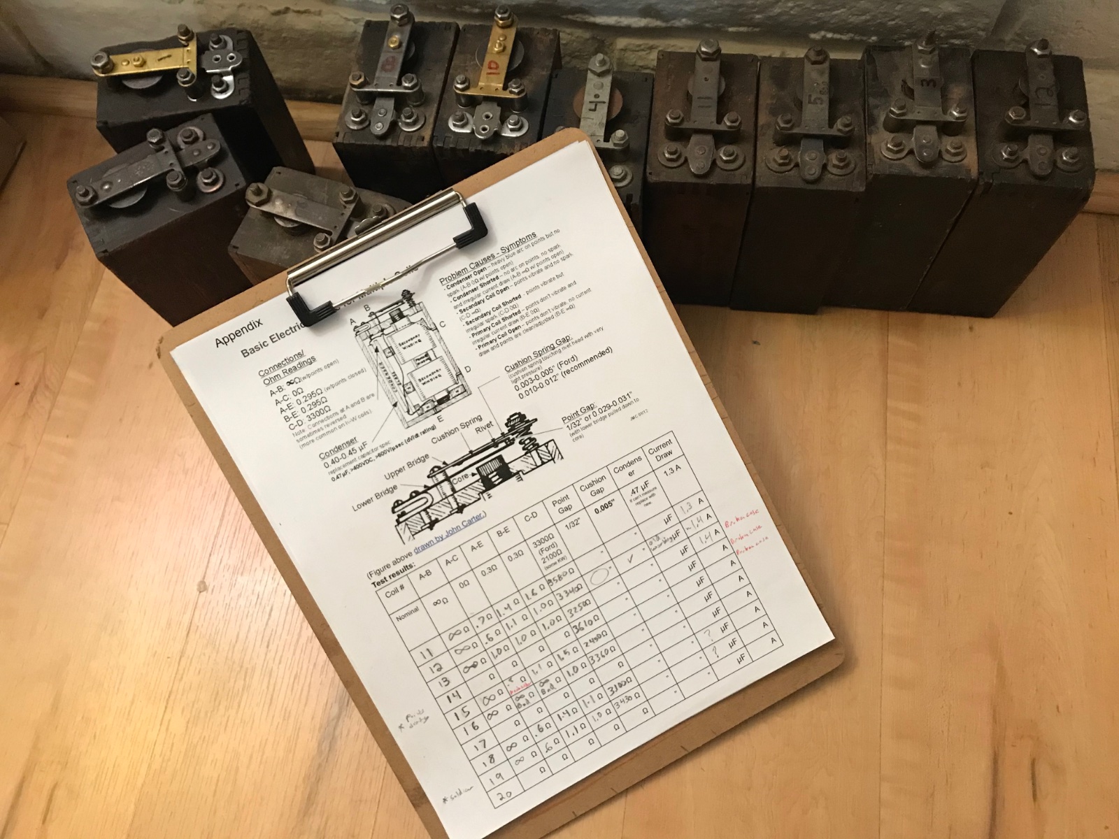

Here is the most practical part of the document. I use it to catalog the pile of coils that I have.

Please give me any feedback you may have on this. I am trying to make it a helpful resource for others. As you will see it is not just for the MCCT.
