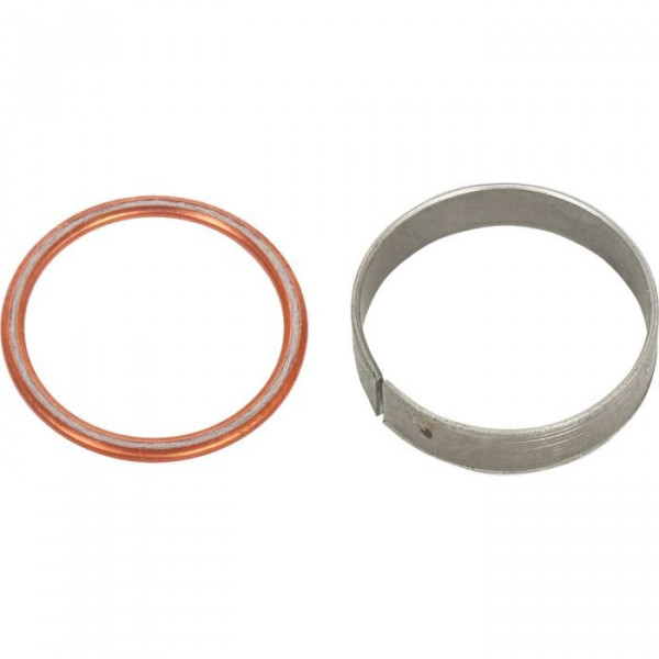

Does anyone know what the proper measurement of the steel gland rings are for intake/exhaust manifolds? Im looking for how thick they are from front to rear surfaces.
I have rings that do not allow copper rings to seat properly.

The stock rings are .280". I use them with the stock copper crush rings and find the combination quite adequate. The stock rings and gaskets also cost less than half the price of the one-piece coppers. Especially on a block that has any pitting, I smear a bit of hi-temp RTV on the copper to help it seal. Allan's suggestion of taking a little off the rings may help, but it would have to be very little. They have to stick out past the coppper gaskets to align with the holes.

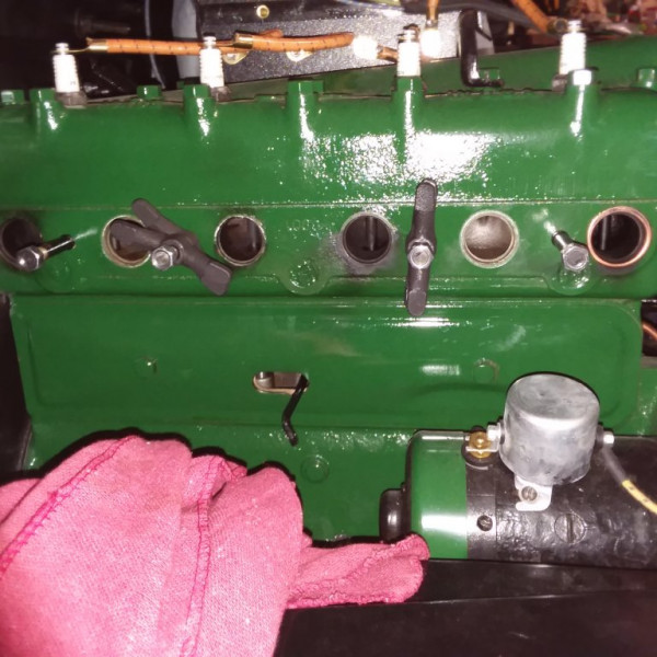

The variables with the manifolds need to be addressed. Determine if the port recesses in the block and the manifolds are clear, not pitted or filled with crusty iron or carbon, clean these as square as possible for a full circular seat.Professor Fate wrote: ↑Sat Aug 14, 2021 11:27 pm
Typically, fully cleaned port recesses in both block and manifolds will almost swallow the steel gland rings, leaving a tad sticking out to hang the manifolds. Most times you have to spread the ring gap to make a grip for the rings to stay in place and not freely fall away.
Only the slightest rim of the steel rings needs to be in either side of the manifold ports, that makes lots of room for the crush copper gaskets to seal themselves when fastened tight with the clamps.

All 4 cylinders leaking on exhaust side. Manifold is straight and true. All steel rings are .028.

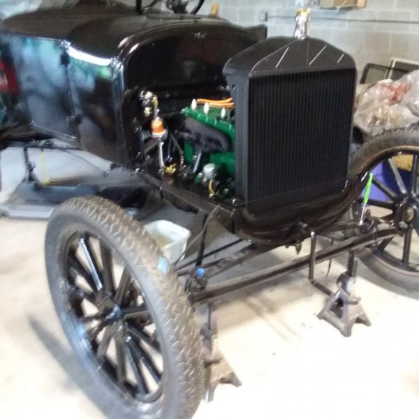

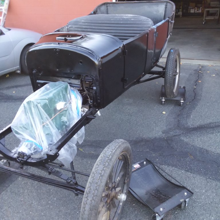

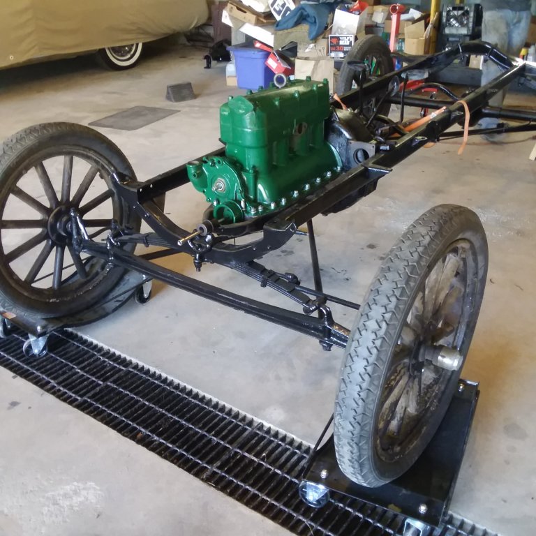

Here are some pics of my '26 speedster project. [/size]
