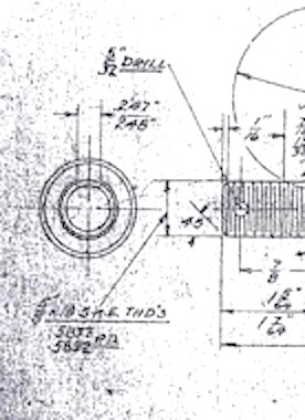

Re: Axle key way fit
Found the same with new axles, mfg. by Snyder's, and are very nicely made, correct to Ford print. Placed a pair recently in the '25 coupe project, and used the Ford manual way for fitting the key.
New axles are just on Ford print, that is the keyway for the hub key on mine was .2475". Right at the tolerance of .247-.248. That is the Ford dimension.
New keys come in about .249". That is the way of the key.
Follow the Service Manual on install, Chapter XIV, paragraph 639, ".....inserted into keyway on axle as shown at 'B' {key, taper end down, and toward axle housing} and is forced into the keyway by tapping it with a small hammer." I use a brass hammer to do this job.
The key must be tight in the axle shaft or rocking will occur, causing a loose hub, or worse, a busted axle keyway !
I've spent the majority of my working carer around special machine building & tool & die making. Very seldom have I even seen a machinist or tool & die maker take "standard sized" 1018-1045 carbon steel machine key stock and fit it to a keyway without stoning or worse case surface grinding it to fit. A "standard" 1/4" x 1/4" key stock should measure .249- .251, oversized .250 - .252 and undersize .248 - .250. The Ford print indicates a .247 - .248 keyway width. So even using undersized key stock there is still a chance you'll need to fit it or "forced in by hammering". Just my humble opinion. Enjoy
I'd love to see the drawing of a hub and from that gather exactly what the tolerance and fit of a standard(?) key was at the factory.
Keys in industry come in a myriad of styles for a "1/4" key...undersize, oversize, stepped, etc. I doubt that much thought is given to where the keys come from that are turned into keys for "T"s. If it was a Fun Projects part or an RV Anderson part, I'd believe some thought went into it, but doubt very much if anyone else has or will.
