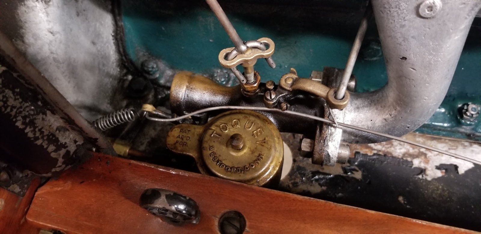

Carburator is NOT a Holley NH or other standard but a Toquet aftermarket carburator which generally works fine. However I think it leaks a little and will take it apart and clean and check.
