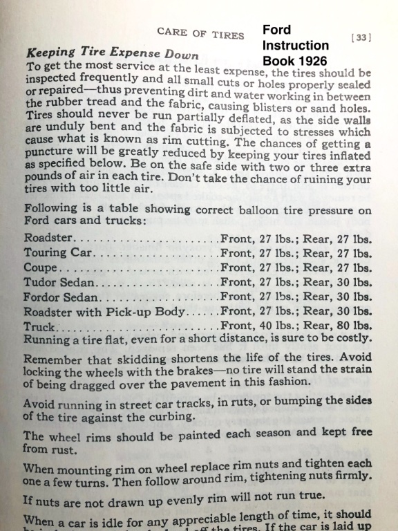

Tire pressures recommended by Ford on the T cars and TT trucks, for the 21" balloon tires.
Text above the chart reads to be safe and add 2 or 3 more psi
